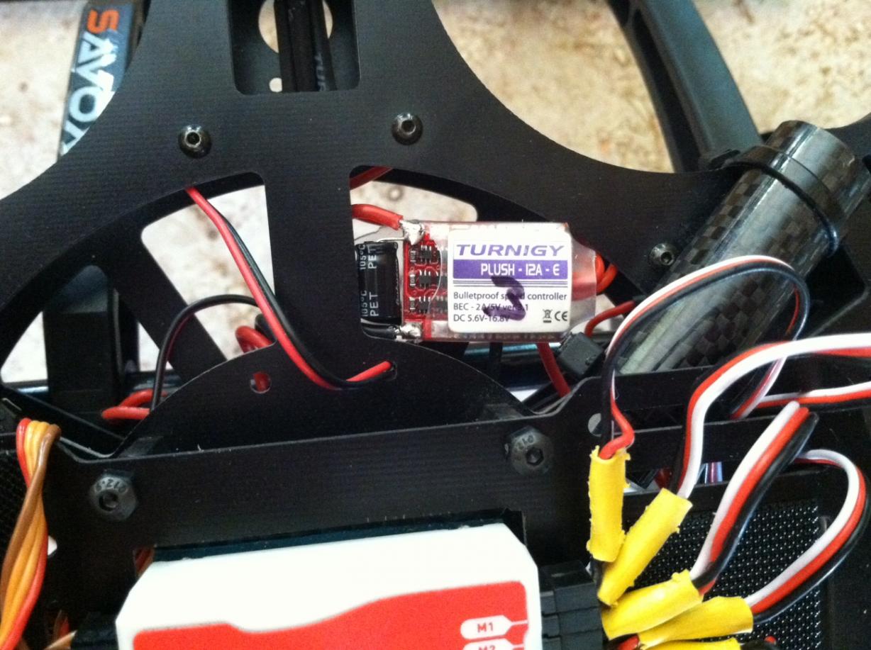

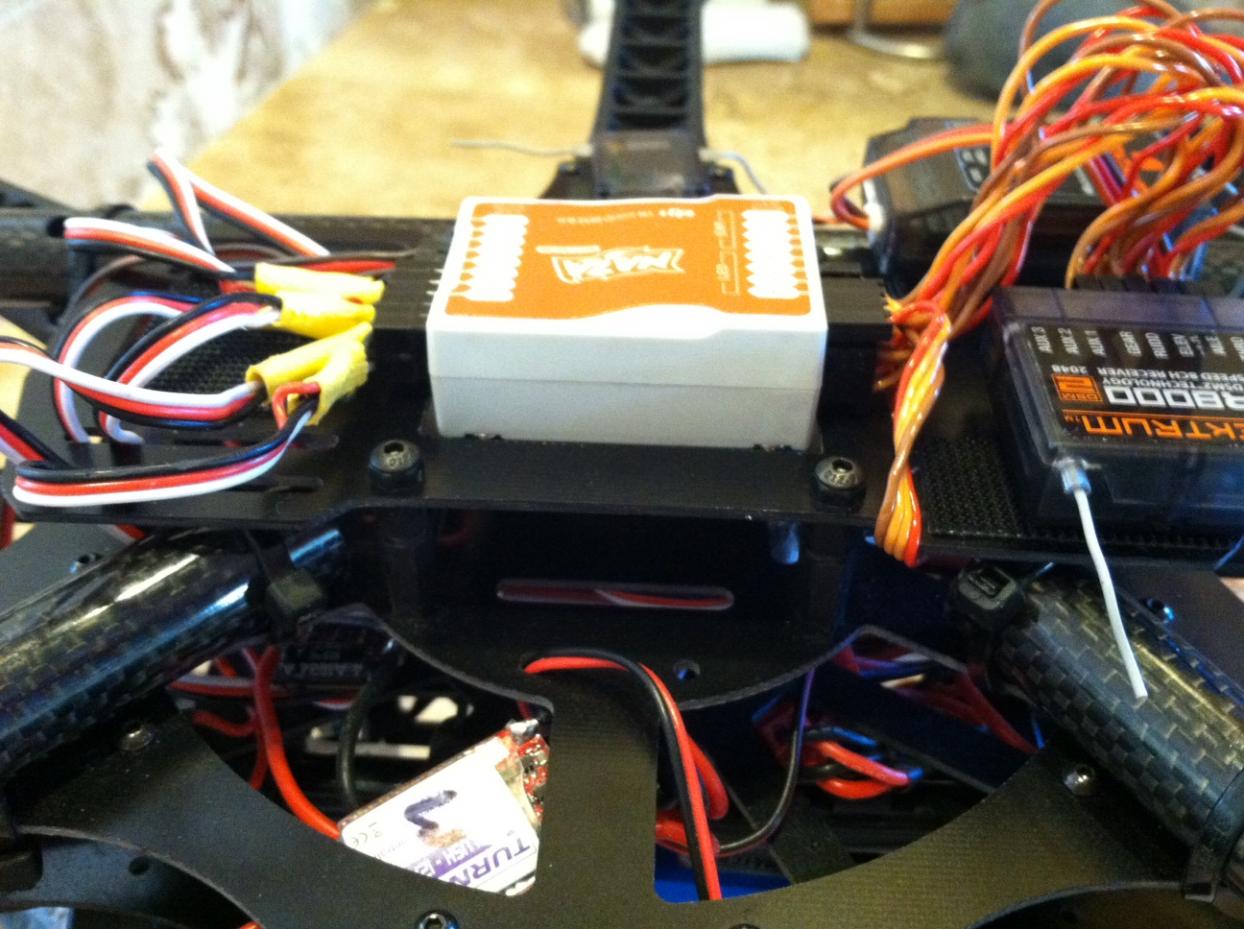

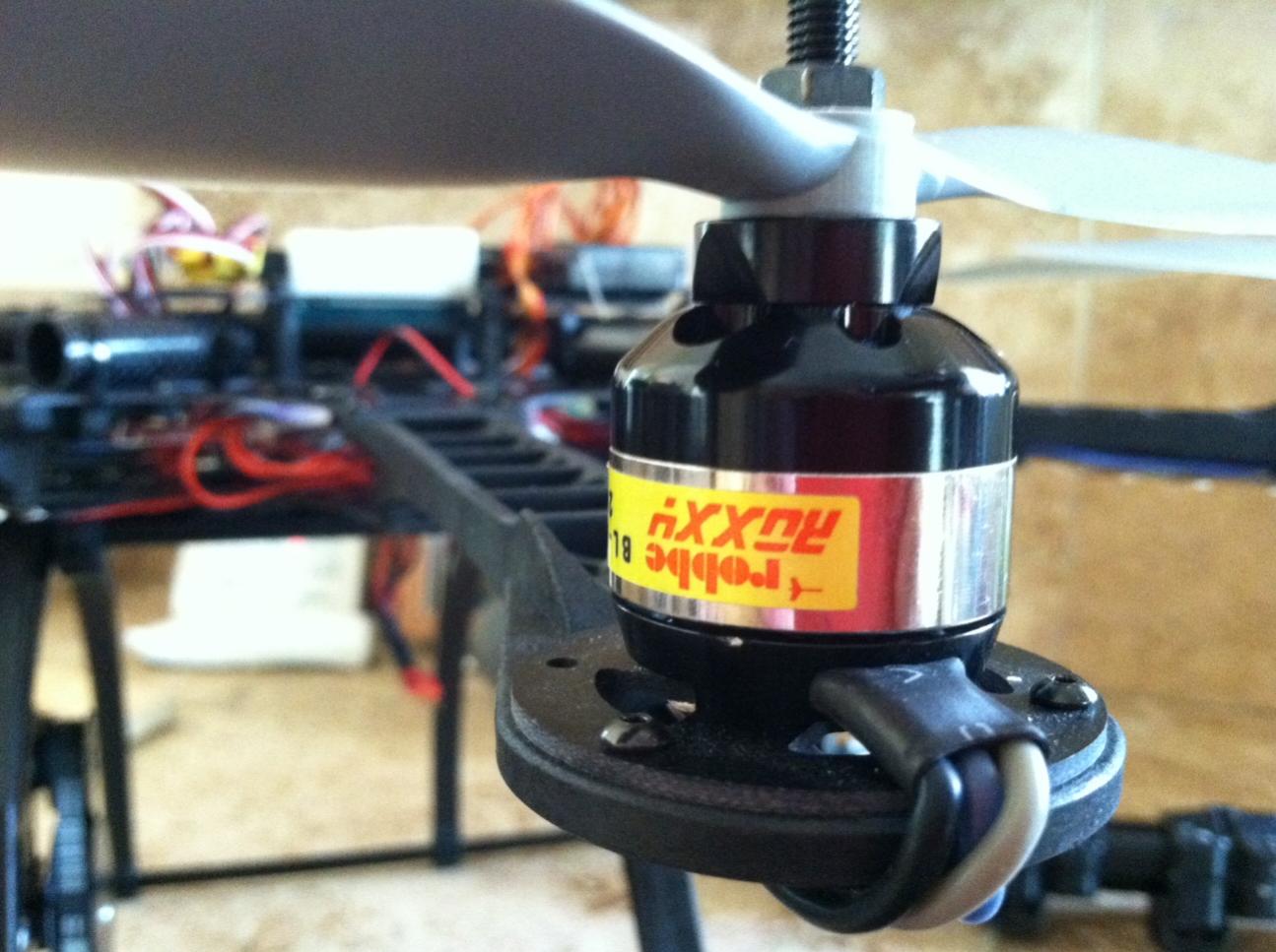

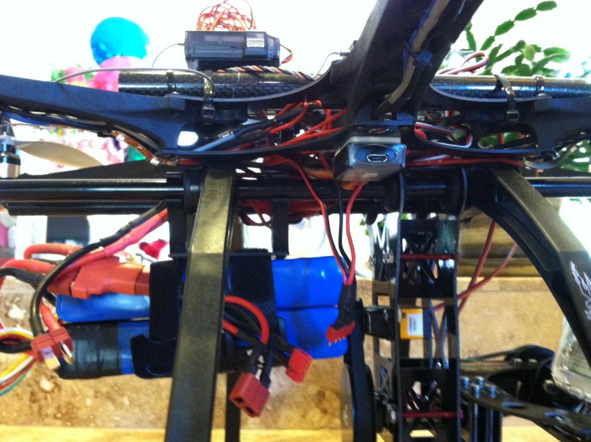

Helijib
Hi Dave,
Here are a few pics of the motors and esc's.
The motors are robbe roxxy 2827-35
The esc's are turnigy plush 12a-e
This weird drift to the right scenario happens about 2 minutes into flight with two fully charged 2650 4s turnigy lipo's. From then on if I land and then take off it happens again with in 20 seconds or so. The weird part is that it slowly gets worse and worse. If I feel it starting to happen I can land quickly, but if I wait it's almost uncontrollable.
If I wait too long, I have to put the right stick at full left cyclic for it to hover then bring it down.
Thanks so much for your help.
View attachment 3945View attachment 3946

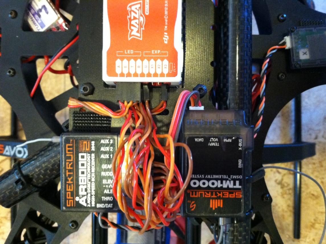

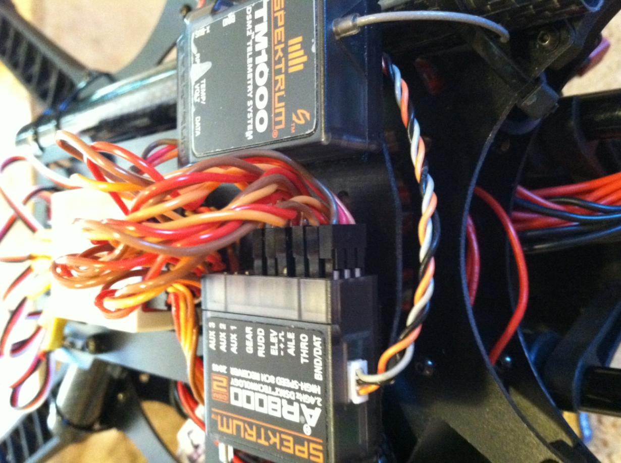

ESC's sound to be overheating..
Strip off all the weight and fly on one pac, see if the time before problems start increase..
Get rid of the gel mount .. hard mount the nazza
U got becs on the esc's ? have you pulled out the live from the bec?
Are you sure you have all the AR8000 connectors in the correct orientation? signal, + - a couple look wrong like Elev

Tomstoy2
The esc's and probably the motors are working too hard for the weight you are trying to lift.
I'm assuming the motors are comming down hot, too, with the weight off on your last flight.
If so, run your numbers in the ecal ulator and find what works for your weight.
Concerning esc's, I always get at least one size larger than what the motors are rated at. It's best to not overwork an esc, as these hexa's don't auto-rotate worth a damn!
The fact you flew with the weight stripped off but the esc's were still hot really tells you that you are still over-taxing her.

I am no expert at MRC's but I have a lot of heli background time. This may be a suggestion that will be derided, but looking at the wiring, I can see several cases where wires are going around the edges of the frame quite tightly with nothing under them to prevent possible chaffing ? Just a thought when nothing else works :)
mailman35
i saw some flipped cables going to the naza unit, i did use the zeal tape for my naza for a while but it led to erratic behavior, ive removed it and gone with 3m outdoor adhesive tape and ive had far better results with it.
