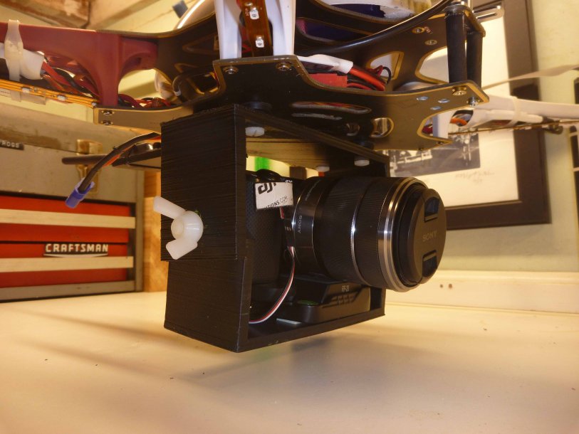

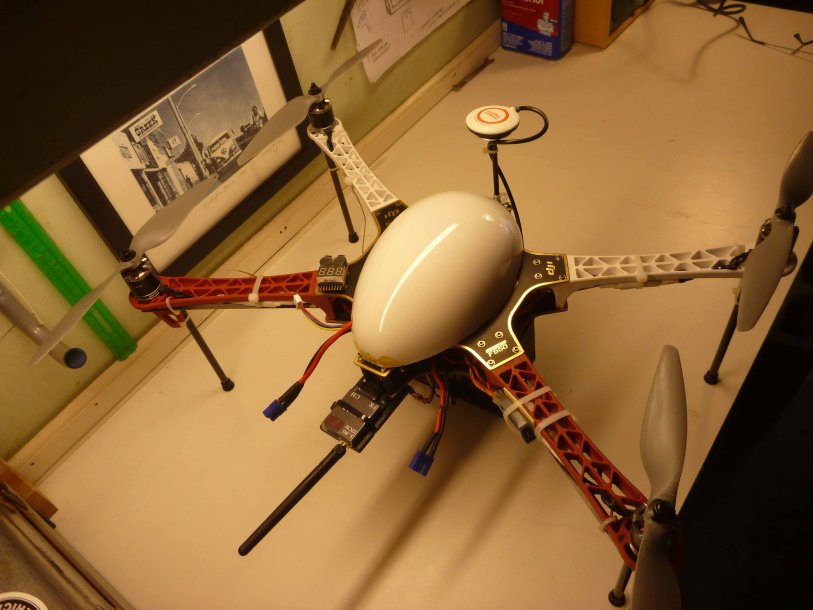

Here are some pics of my completed build, with a big THANK YOU to all involved with this thread - especially Bart. This thread/forum is the best thing going for this industry!
I printed this simple camera bracket:
Happy Flying!
Dezy
I see what you did with that Hexa frame and I like it!!!! using the front and rear tabs to mount hardware is a great idea while getting the benefits of the XY format!
Congrats!
