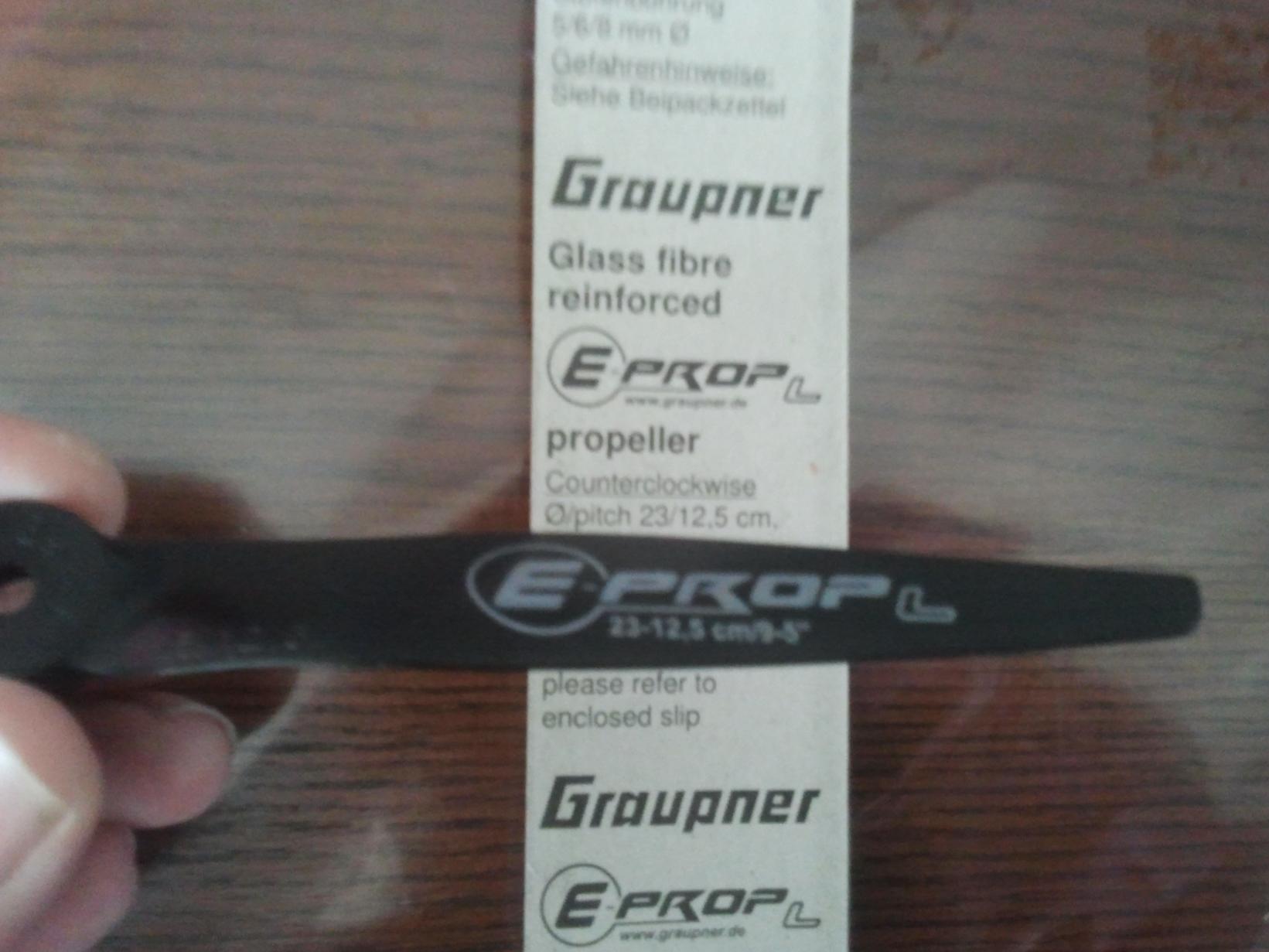

Hum, Not confused. I have several Grapuner props still in the package and they are all like that. It's not mislabeled.

Is this mislabeled too? It spins clockwise if viewed from above.

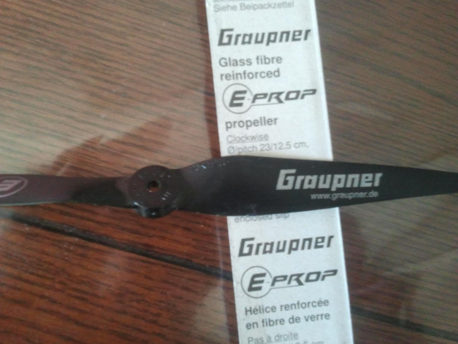

What about this one? It's not an "L" prop but it spins CCW if viewed from above.

If you and I are facing each other and you put a spinning disk between us one of us will say it's spinning clockwise and one of us will say it's counter clockwise. To say CC and CCW is fixed is not correct. It depends on which side of the disk you are judging it from. Grapuner judges it from the rear, as does full scale aviation.
Not if the disk is on a horizontal plane. That's why I was confused. It was just my ignorance in assuming it was labeled as if on a horizontal plane - like a heli.

Back to the subject. You can see that they are all marked this way and the OP's prop was not mislabeled. It has to do with the viewing orientation that the manufacturer uses. In this case Graupner is using the same methodology full scale aviation uses. CCW when viewed from behind. Confusing as heck that's for sure if you're using these props on a multi. Not so much on an airplane.

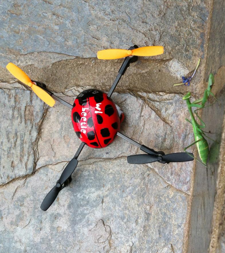

Have a look at the attached photo, quad viewed from above. Focus on the top right orange prop. I think you will have to agree, that prop would have to rotate CW for the quad to lift off. Ask any pilot what sort of prop it is, and he will tell you it is CCW. So will Graupner and all the other suppliers.
There were aircraft and boats long before there were multirotors. They set this convention, and whether we like it or not, we are stuck with it.
If you don't agree, all I can suggest is that you always buy props in pairs, or that you send the broken prop to the supplier for matching. Otherwise you are going to be disappointed.
