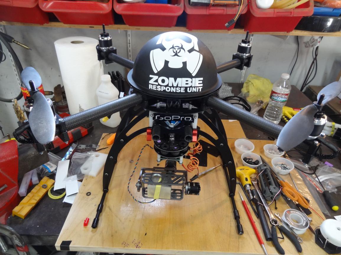

Build a good rig. This rig is SOLID. gets 12 min flight time on 6000mah (4S) packs
530mm Quad kit- $169 (quad frame US)
landing gear $50
Motors/ESC: Tmotor 770KV motors 40amp esc's $360 (motors $70 ea, esc $20 ea)
Props 12/38 APC - $25 all 4
Super X - $399
Tarot 2D Gimbal; $180
Batteries- $250
Video Tx/RX- $159 (RC Logger)
FPV cam $100 (RCLogger Pro HD
Radio TX- $200
Cables- $20
Monitor $80
love this guy. Has never let me down.. 100+ flights now.
I use it for filming things that make me nervous to take my big rigs up or when someone wants to shoot with a gopro.

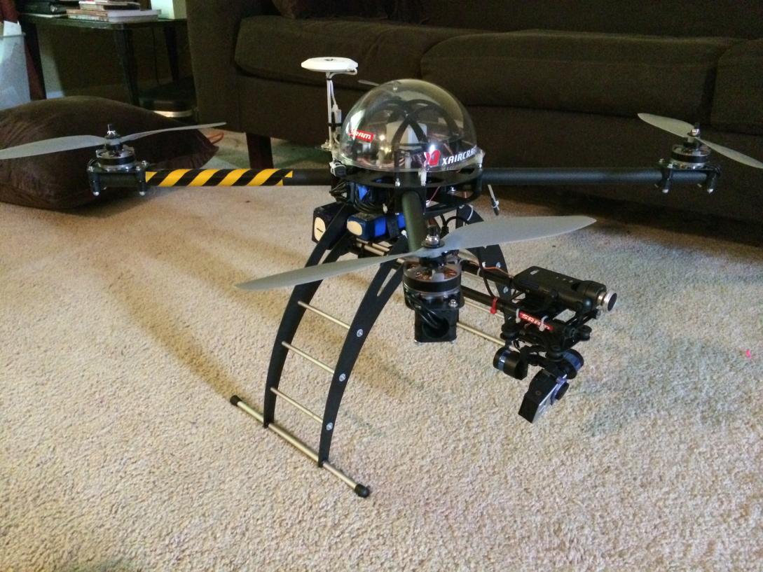

I've got the exact same frame and lg set and I love it also, almost to the point of stripping my seldom flown hex and building a bigger quad. I'm currently trying to get it's weight down so I can fly on 9" graups and leopard 960kv's and carry the new feiyu gimbal. I ditched the lg's since the past 3 crashes were due to tiny bounce landings and it tipped, I'll do something at each corner using the motor mount brackets and keep it as low as the gimbal will allow.
There's a zillion different ways you could go for a gopro platform, going your way requires more building knowledge and sourcing all the components separately. The dji kits are more the one stop shop way to go. View attachment 14292 pic of my quadframe in one of it's many forms.
