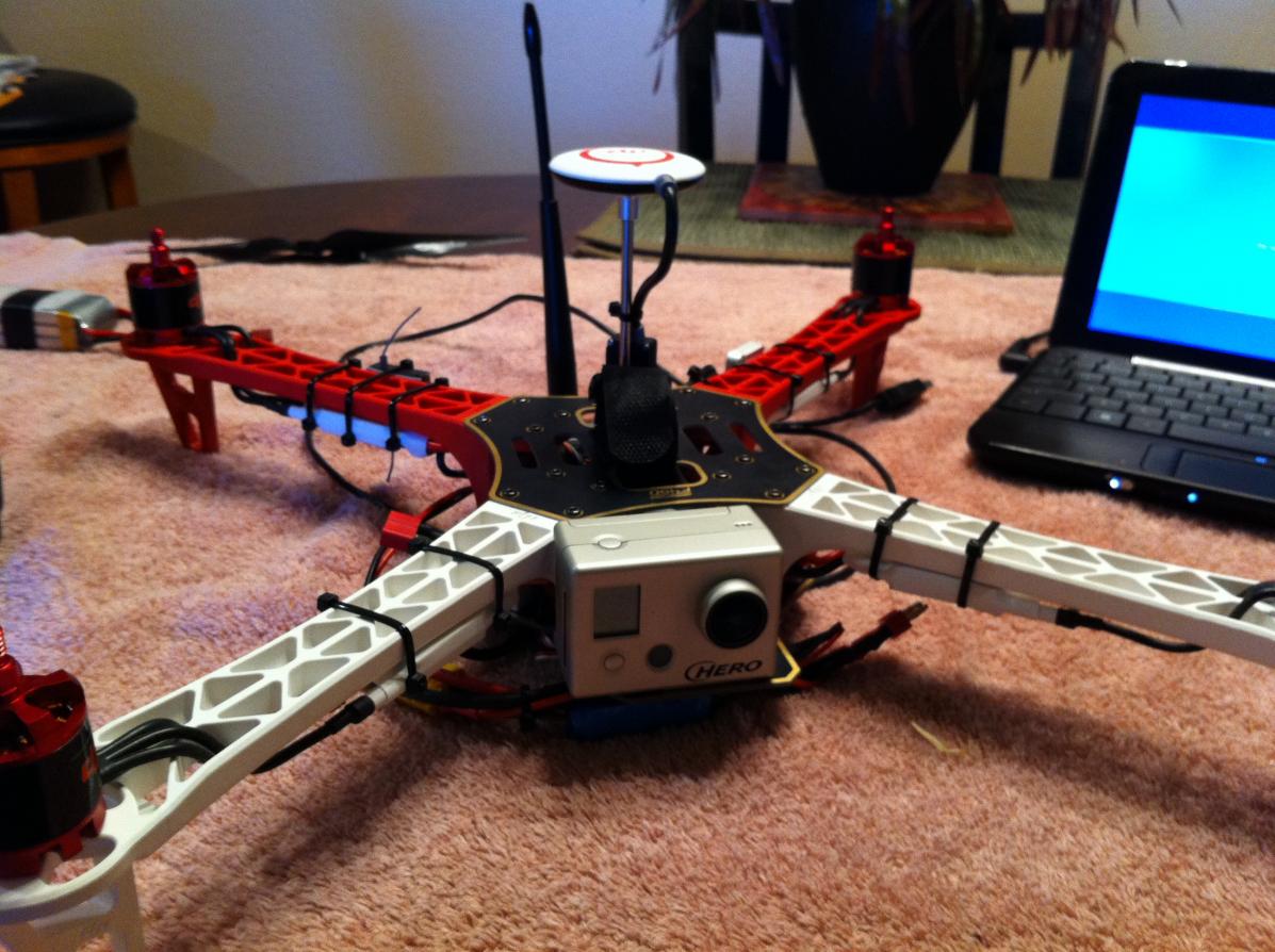

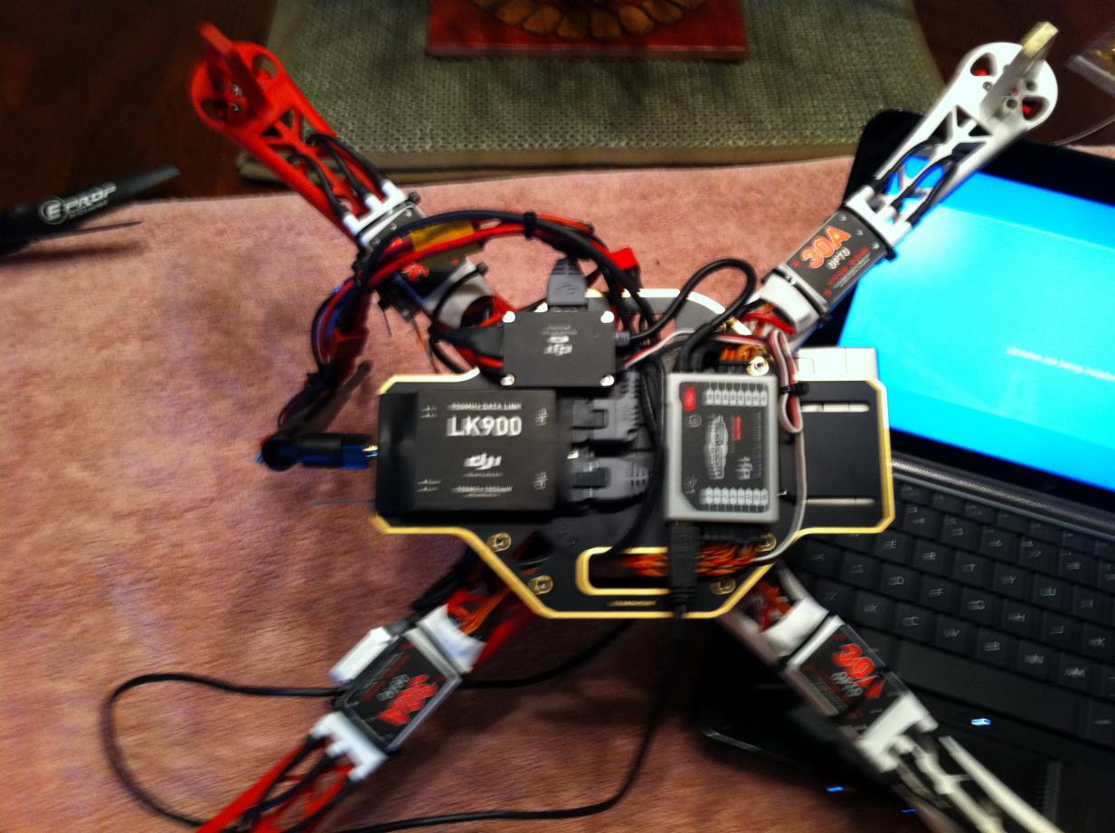

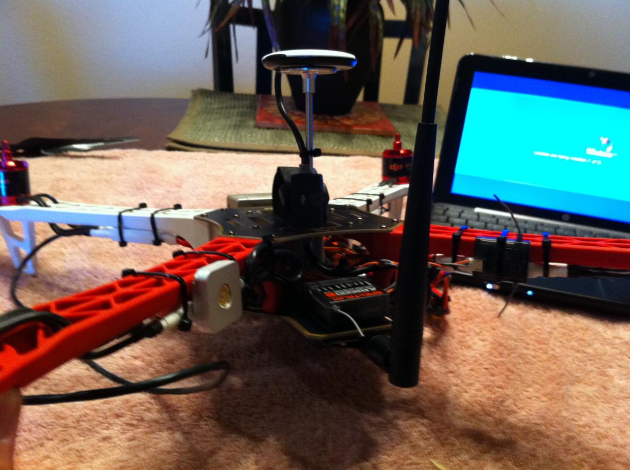

Because the 900 has two can bus ports you have all you need to connect everything. I will try and find a post I made a while ago on how to do it.
Tahoe Ed
Thanks Ed.... Obviously it is possible as per the photos..... will put on my thinking cap and do up a diagram then connect accordingly. I assume you are using 900Mhz datalink for Dji GCS.
