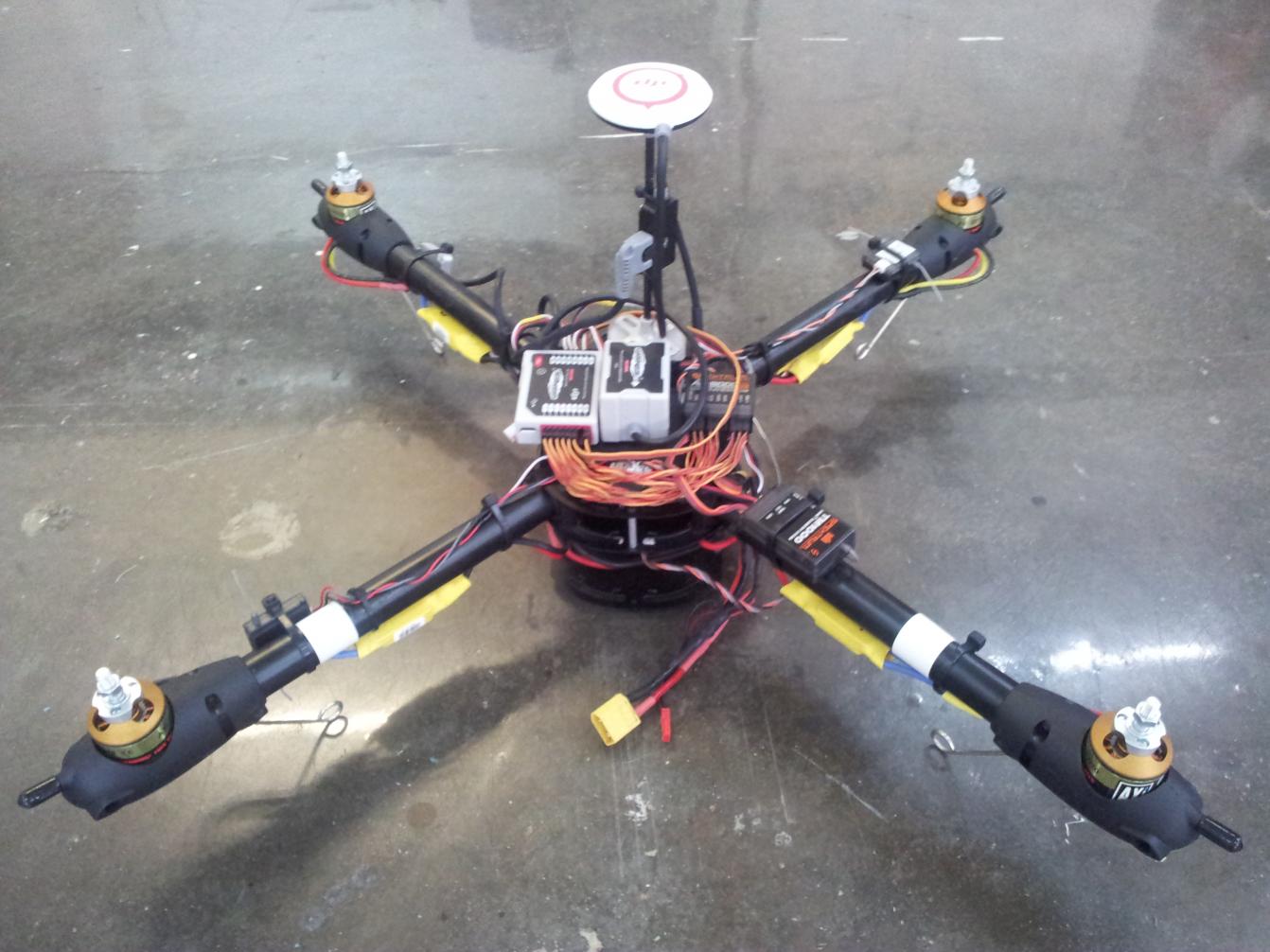

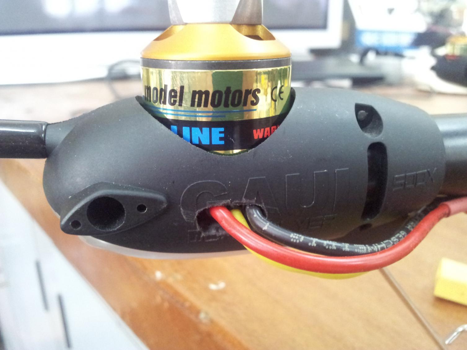

I finally got time to modify the motor cowls and get my nice, new Axis onto my 500X. In the end I went with just drilling a hole in the side of the motor cowl for the Axi motor leads and mounting the motors at 90° using the existing holes.
View attachment 5826View attachment 5827
The frame is now the only part of my setup that's anything to do with the original 500X.
I took it out test flying yesterday with the Alware 3-axis gimbal and GoPro2 attached, using 2 3300mAh 4s LiPos in Parallel, and I'm pretty pleased with the results. The motors just feel better and more reliable anyway, but up in the air it just feels more stable too. No crashes thankfully, although the motors are still running hot after a full flight (approx. 12 mins flight time). They're not hot enough to burn any more though, I can hold my fingers on them for 4 or 5 seconds. I did notice, however, that motor 1 is hotter than the others and the ESC on boom 1 is also running considerably hotter (i.e. hot rather than just a bit warm) than the other three.
They're 30A ESCs, so should easily be able to handle the motors which are rated at 18A max, and the quad is pretty well balanced. Does anyone have any ideas why ESC 1 might be running hot?
