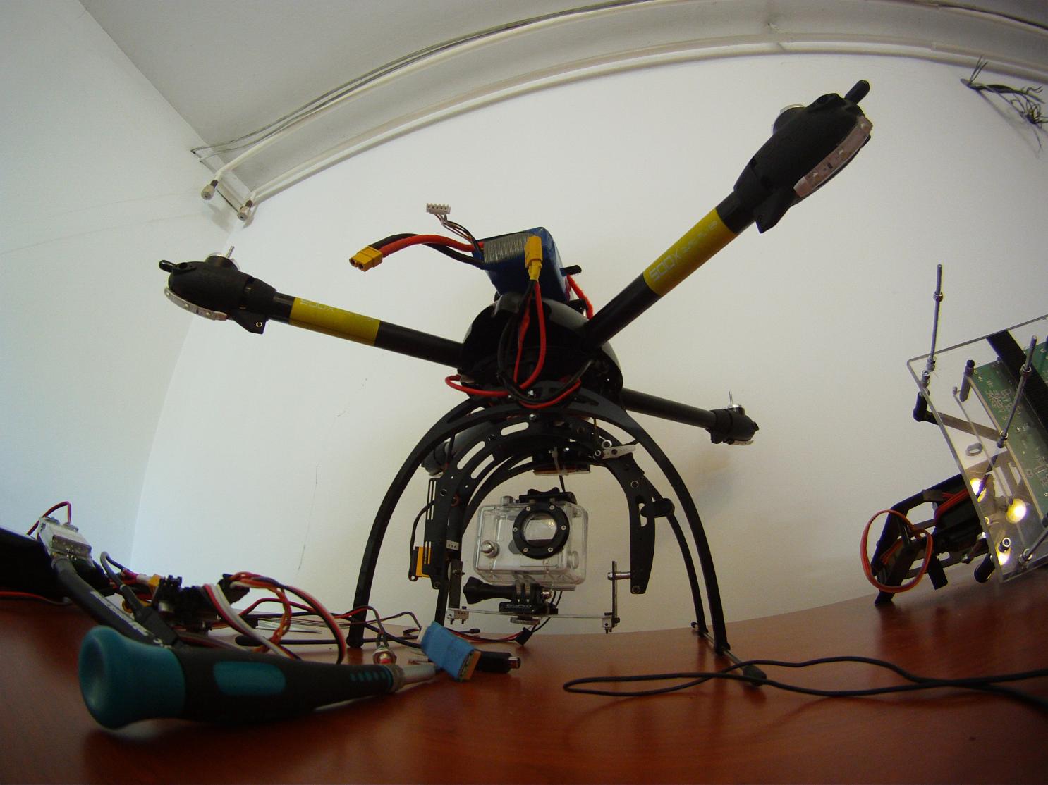

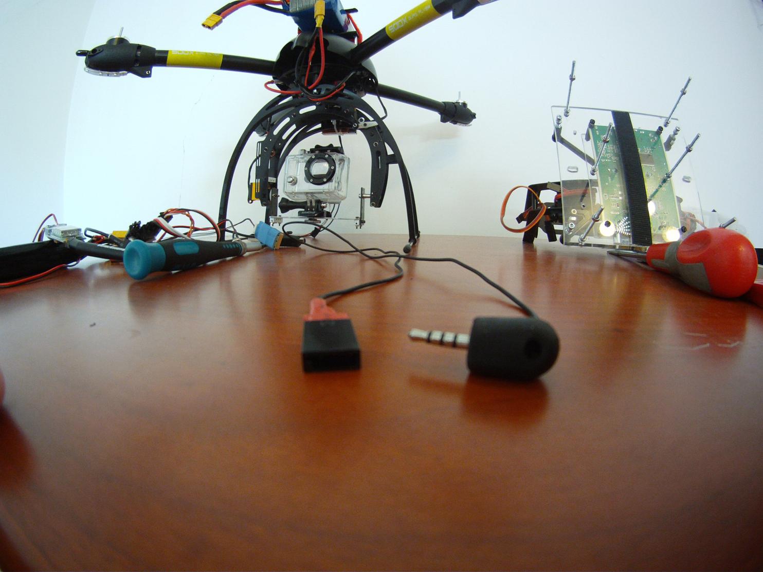

Hi,
I have no problem uploading GoPro photo file here (img bellow). I use my Gopro for FPV and right now setup also OSD system. Found on youtube how to use Gopro as FPV cam with Live Feed video. On Gopro menu find LF (LFF = live feed off; LFO = on) and set LFO to enable that, so you don't need additional cam on board :). Also watch some guy that use video cable from cell phone, have same jack, so a little modification and in work. Here is how: http://www.youtube.com/watch?v=MBzRRGBWcrw&feature=related
View attachment 4028View attachment 4029
Cheers
Vojc

Did you convert to a jpeg file or is that what a gopro file is? Mine gave an error but I will try again later. Most quad flyers I talk to do not use the gopro for viewing because of letterbox format, field of view too wide and low light handling capability. The rmrc-540 seems to be a realistic field of view and fills the fat shark goggles screen. It also adjust to dark shadows quickly. It doesnt weigh much so I have never tried the gopro for viewing but I do have the cables. I will probably give it a shot on a plane later on because I wont be flying as low and close to things. I have the hero 2 but I notice it still does not handle shadows very well and things get dark. One other thing is I have the viewing camera straight ahead and the gopro with a little down angle in it. When the next firware comes out for gopro it will have more fov settings in the 720p 60 frame mode so that should make it more usable for a viewing camera. Do you use the gopro skeleton case to access the plugs?
Vojec
No did not convert jpeg file just use form and upload image. For suggestion about rmrc-540 cam, because have Fat shark goggle and I will try that cam.
About GoPro sceleton; no just ordinary additional case and drill a hole to it :).
