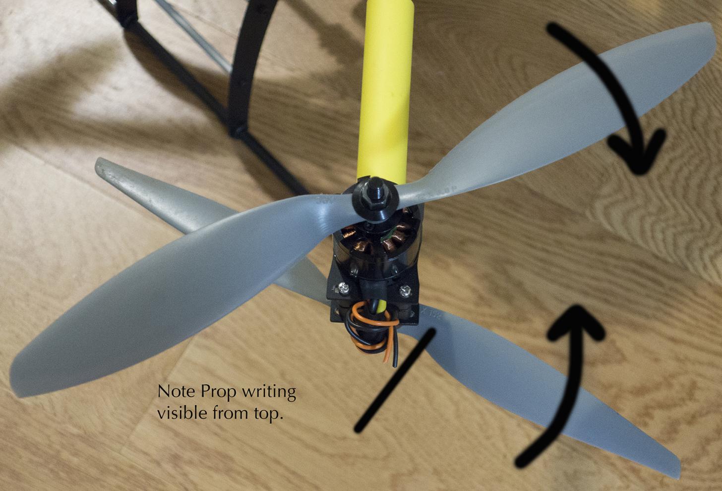

Googling and get more confused. Maybe I have the right combo of propellers and just don't know which one of the set goes on top. Looking at them doesn't make sense to me, but it won't be the first time I've made a mistake on this build.
Will keep reading and maybe figure this out. Just don't want them wrong and crash coming out of the gate. Also not going to hang onto it and try it out. Too many horror stories.
Stacky
jfro
Aerial Fun
Stacky, thanks. I think I read the instructions wrong. I had all the motors on the table and wired 4 to turn clock wise and 4 to turn counter. I put the counter turning motors on the bottom as I thought the instructions said. It appears they want the bottom motor turning counter to what the top motor is when in position. My bad.
When motors are running, the motors would then be turning the same direction when looking at them. Hence my issue of one prop pushing air up and the other down...... Not so good. In you picture, my bottom prop is turning the opposite direction....
It looks like I have the props right, I just need to go switch the bottom motors so they turn the opposite way.
