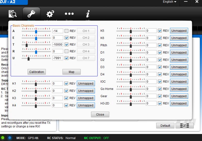

Seems to work fine now... only thing is my Basic Channel T, when the throttle is all the way up it shows -10000, all the way down it's 10000. Is that normal, or should it be reversed?
Screenshot with the throttle (left stick) all the way up:
