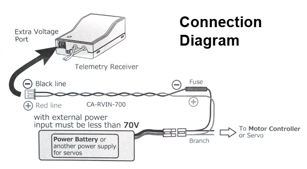

The CA-RVIN-700 (FUTM5551) is a simple external voltage cable that gives your lipo voltage back to your transmitter, but can't find it anywhere in the UK at all.

The FUTM5551 is just wire, the plug, and in inline fuse. Everything works just fine without the fuse, but it does protect your receiver in the event of a short or wiring fault (and assures your receiver can't short the power supply as well). If you have or can find a plug that will fit it would be easy to make your own. I bought one, but at $18 in the U.S. (Tower Hobbies) it is very much over-priced. The wire is connected to any voltage source (ESC pad, main voltage input, etc). And, yes, you get voltage from just that source this way. I have no experience with the SBS-01V.

Thanks for your reply, I did purchase a couple from China earlier for £5 each.
Problem is it takes 2-3 weeks to come.
I did find the following earlier in another forum also, if anyone wants to look at making their own.
The connector is a Molex PicoBlade 1.25mm. You can buy pre-crimped leads, so rolling your own is as simple as plugging the lead in, no faffing with crimps or soldering, and as reliable as can be :) You need to buy the lead wires, and a socket housing and then push the lead wire into the socket housing.
Pre-crimped leads
Molex part number: 06-66-0013
https://uk.rs-online.com/web/c/?searchTerm=279-9522
Socket housing
Molex part number: 51021-0200
https://uk.rs-online.com/web/c/?searchTerm=279-9156
Works out a bit less than £1 per lead if you cut the pre-crimped lead in half (it's got a crimp on each end, gives you 150mm leads). Any low current inline fuse should do, I don't think the spec is critical as I think it's there just to stop disasters. I use this one (£0.28):
https://uk.rs-online.com/web/c/?searchTerm=764-9576
but I don't think it's better than any other.
It is actually a 1 Amp Picofuse

The ca-rvin-700 cable just arrived, and is working perfectly.
A quick video below of the Telemetry and Voice warning coming from the Futaba T14 SG
Really handy now having the Lipo Voltage displayed (and sounded) on the transmitter.

I am thoroughly confused setting up the CA-RVIN-700. The directions state cut 30mm of the positive (-, black) line from the cable. Solder the fuse inline on the positive wire and re-attach the section of wire that was previously removed. Okay, so do I put the fuse on the positive line or the negative. The directions are so confusing. I put the fuse on the negative line and I do not get any readings on my 14SG.
Is your telemetry turned on in your transmitter?
Go to Telem.Set and make sure it is activated.
You also might want to upgarde to the latest firmware for the transmitter, but it should still work.
