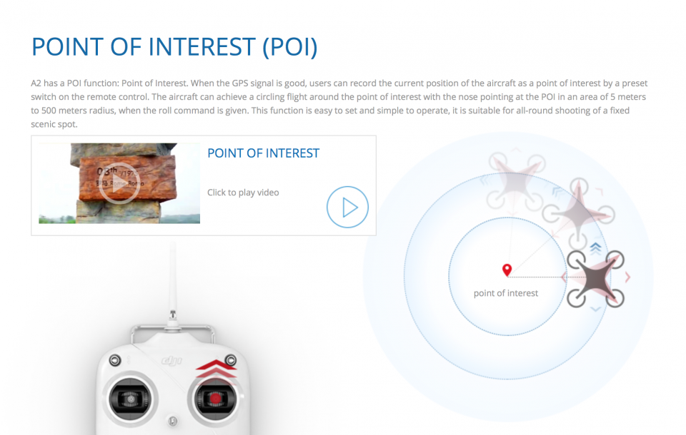

Does the Naza V2 have POI?
Not currently, POI is limited to WKM and A2.
Its a cool feature..
Point Of Interest (POI)
WooKong-M has a new function: Point of Interest. When the GPS signal is good, users can record the present position of the aircraft as a point of interest by the preset switch on the remote control. The aircraft could achieve a circle flight around the point of interest with the nose in the point in an area of 5 meters to 500 meters radius, when the rolling command is given. This function is easy to set up and convenient to operate, it is suitable for all-round shooting of a fixed scenic spot.

I don't think so
But it does have IOC and Home Lock, does it not? It would serve the same purpose if you manually set the home position when hovering over the Point of Intrest. But then again, you'll lose the Return-to-Home feature.
