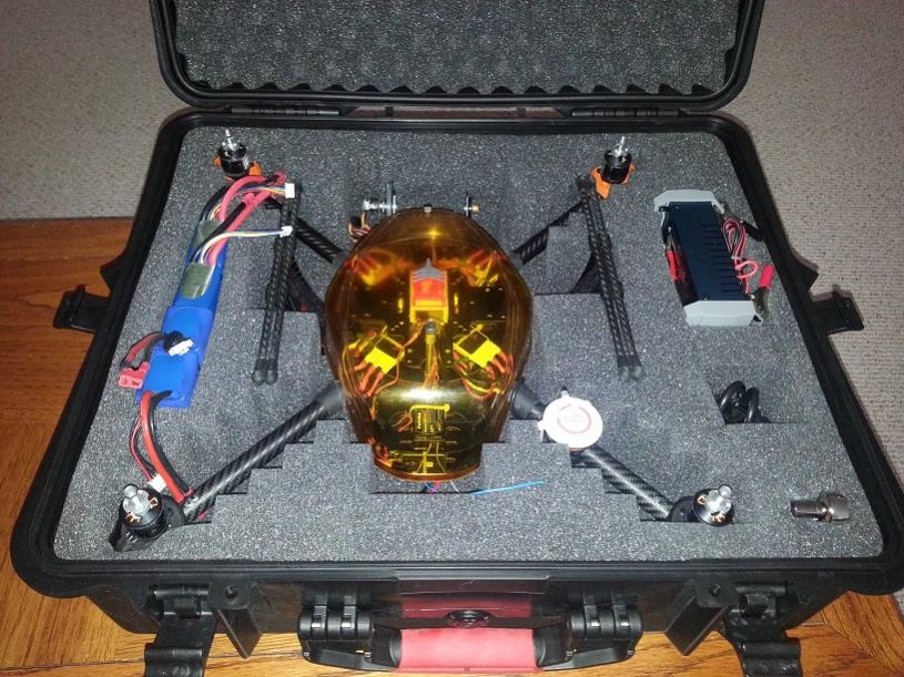

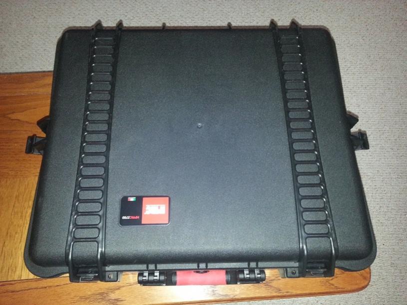

That HPRC 2700 case you have ... are you putting your Droidworx CX4 in there?
I figure we need a bigger case ... something on the lines of the Pelican 1650 or 1690.
One thing I hate doing is unscrewing the props for transporting.
This is what I've been doing up until now ...
Razzil -
I've finished fitting all of the CX bits and charging gear into the HPRC2700.
I still need to hollow out the area just inside the front lip (between the rear of the CX and the top of the case) for prop storage. I understand your point about not wanting to srew/unscrew the propnuts each time you take it out to fly. I was primarily thinking about this trip and how to protect it for the next month as we take our driving vacation. It would have been so much easier if we had an RV!!! ....sigh
Anyway, this should give you a view of how I fit things into the case. There may be better ways of arranging things in there, but my limitation was the 4 corners of the CX and what to do with the landing gear. Since the foam is elogated "cubes" in two layers, it doesn't lend itself to being cut too easily so that's why I have the jagged edge instead of a smooth cutout.
