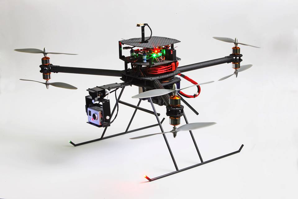

So I've finally finished the build and have correctly configured the boards, run bench tests, and even hopped it off the ground a couple times. I have one last hurdle--the GPS does not seem to be receiving an adequate signal. When I plug it into the setup utility, it shows a checked box next to Compass Cal, and it shows that the GPS is connected, but not that it has a fix. A few nights ago I did get a fix, and the light on the board was yellow. I even saw it go green once (indoors, even!) during a photo shoot of it. A couple nights ago during the configuring process, the setup utility showed that it had a GPS fix, but with just 3 satellites.
I'm using the mediatek antenna, atop a mast (see photo). I reflashed the board to make sure I had the latest firmware running, then went out to an open field, away from any obstructions, and waited for fifteen minutes, and nothing, just solid red. I've tried it again in the front yard, and nothing. I've checked all connectors, and they are fine, and I have it plugged into the correct receptacle on the board. I appreciate any input! Thank you very much in advance for your help.

eddarack
Well the GPS works, no problem. I have no idea what the problem was. I remounted the antenna, and found that once I armed it and spun the motors up a bit, it goes green, and sometimes blue. In any event, I took it for its first flight. The video below shows the craft flying without autoleveling activated. From the very first flight, it flew incredibly smoothly. I don't see any need to adjust the gain at all. I did everything stated in the Hoverfly manual, and voila. Next up is to test altitude hold and then the GPS functions. If anyone has any suggestions, please let me know. It's a bit windy today, so it'll probably be tomorrow. Thanks again to those who helped me out. I'll post some shots of the build here, in a bit.
