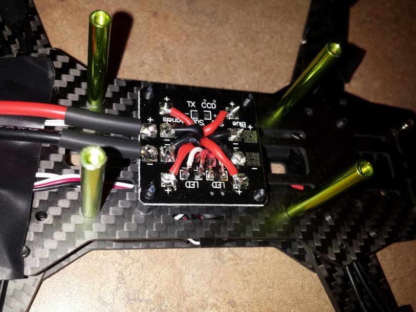

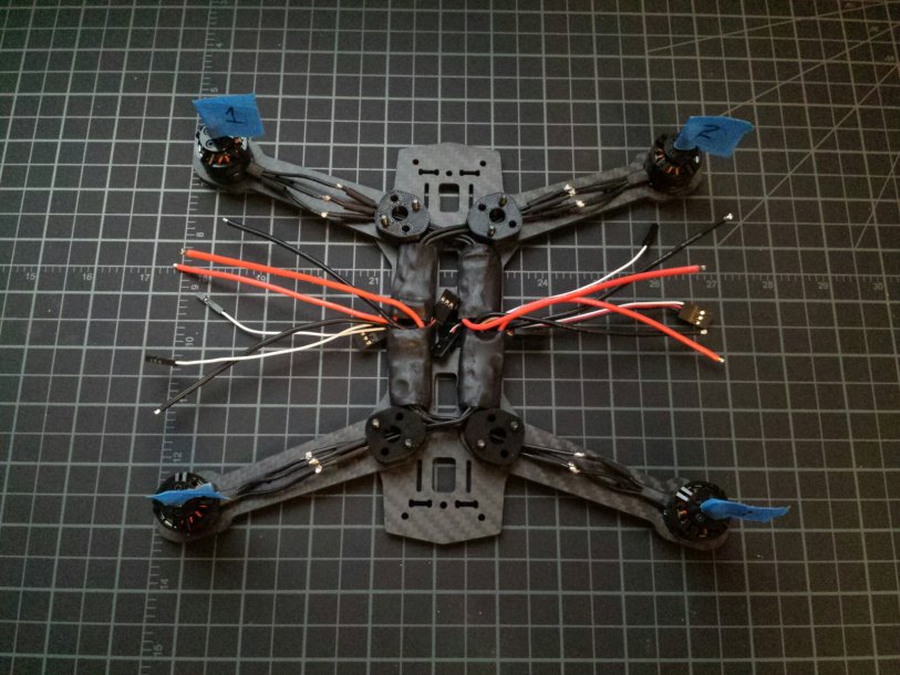

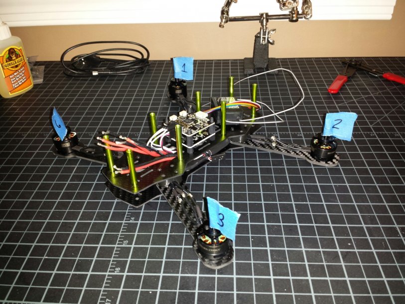

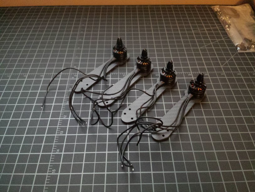

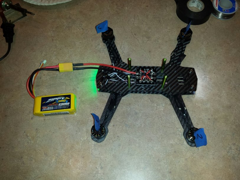

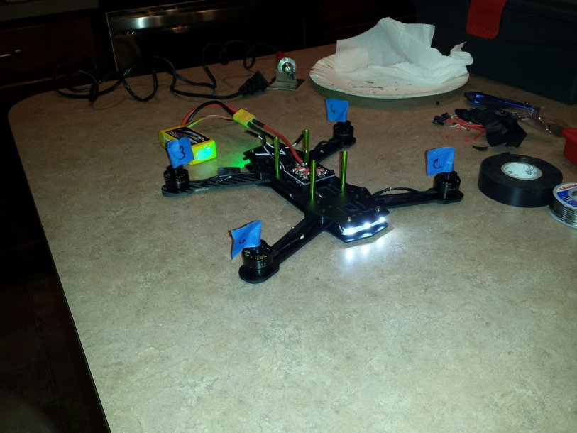

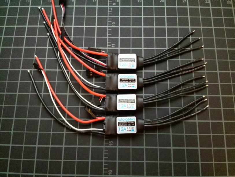

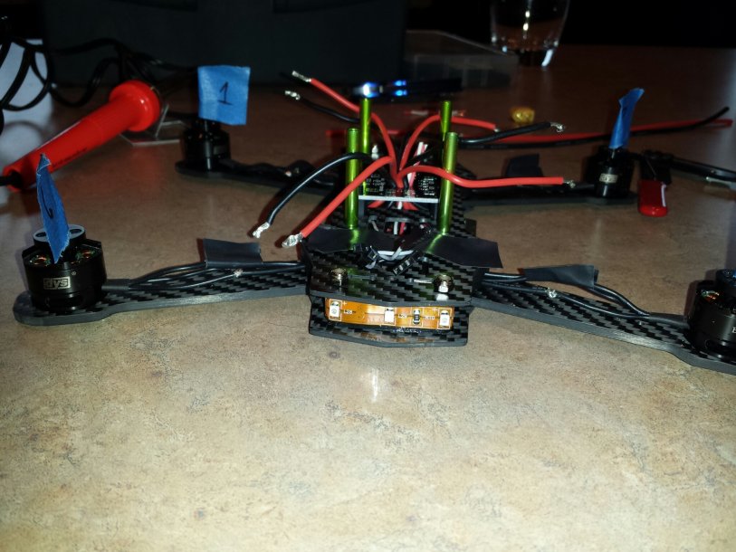

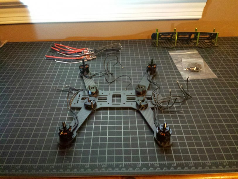

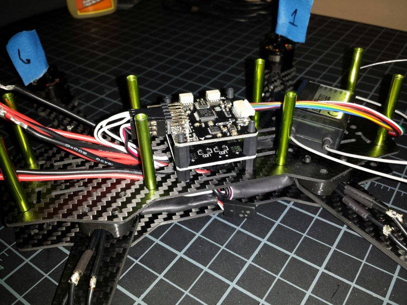

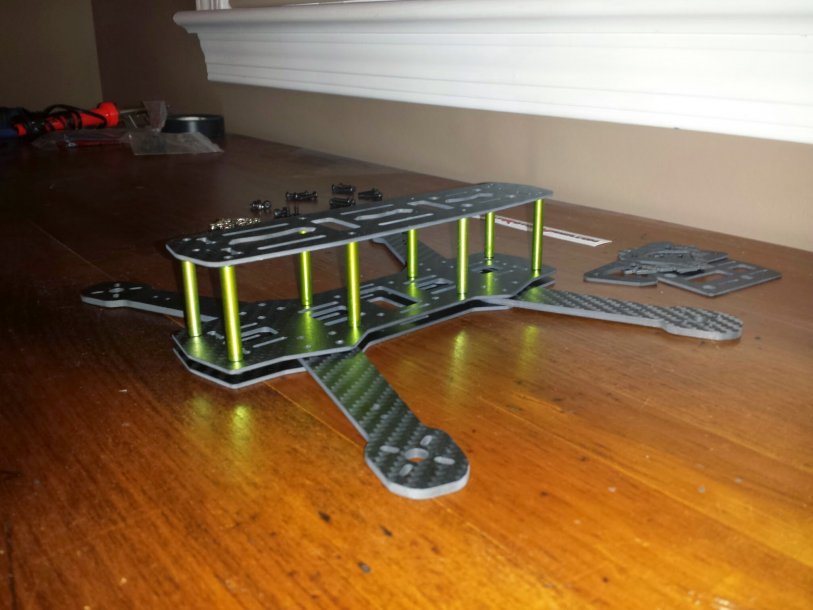

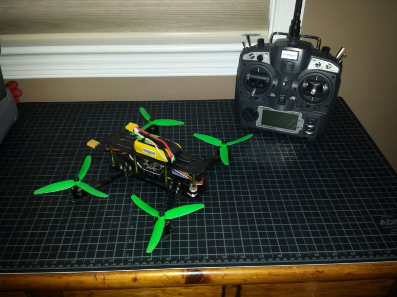

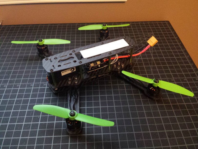

So after seeing a bunch of sweet videos of 250 quads, my friend and I had to build one for ourselves to prove our nerdiness, as we are both in technical careers and enjoy dabbling in technology in general. I would say that I went with a middle of the road build budget-wise but I've caught the bug and cannot stop flying this thing. Flying LoS has been fine getting the hang of it, but I'm beginning to see why FPV is so popular and will be going to that very soon if anyone has any suggestions!
Below is a build list along with some pictures of the build along the way:
  • Frame: MRM250 CF Frame Version 1 with MRM spacer kit
  • Motors: DYS BE1806 2300KV Black Edition
  • ESC: Rotorgeeks 12A BLHeli ESC V4
  • Props: GemFan 5030 to start, now trying HQProp 5x4
  • PDB: CC3D Flight Controller Mini PDB
  • FC: CC3D with 90 degree bent pins rotated 90 degrees
  • Tx/Rx: Turnigy 9x with stock receiver for now
  • Battery: Zippy Compact 1300/1500 mAh 3S 25C

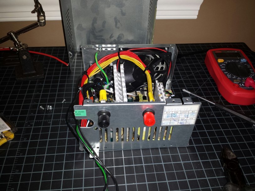

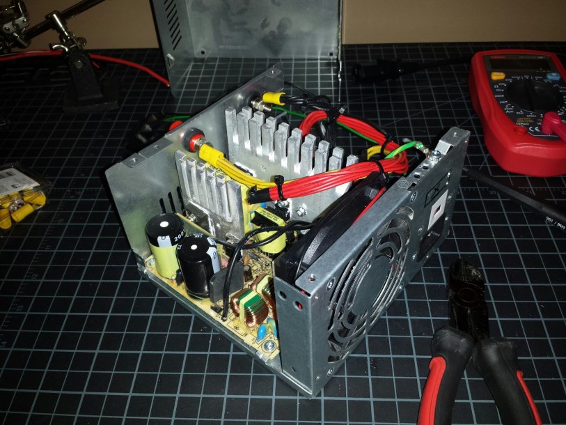

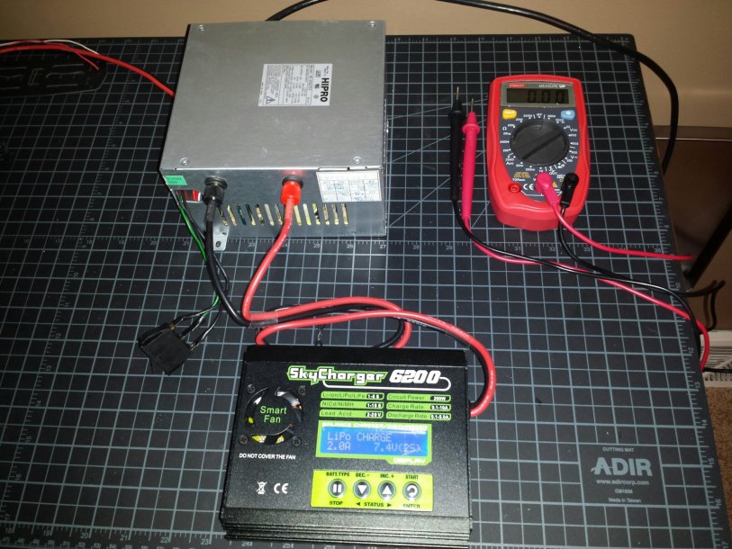

  • Charger: SkyRC 6200 with modified computer power supply
View attachment 25973 View attachment 25974 View attachment 25975 View attachment 25976 View attachment 25978 View attachment 25979 View attachment 25980 View attachment 25981 View attachment 25982 View attachment 25983 View attachment 25984 View attachment 25985 View attachment 25986 View attachment 25987 View attachment 25988 View attachment 25990

Very nice job! Love how neat you kept the build.
Welcome to the forum. Seems like you're well on your way to the full-blown addiction :)
Have fun and fly safe!
