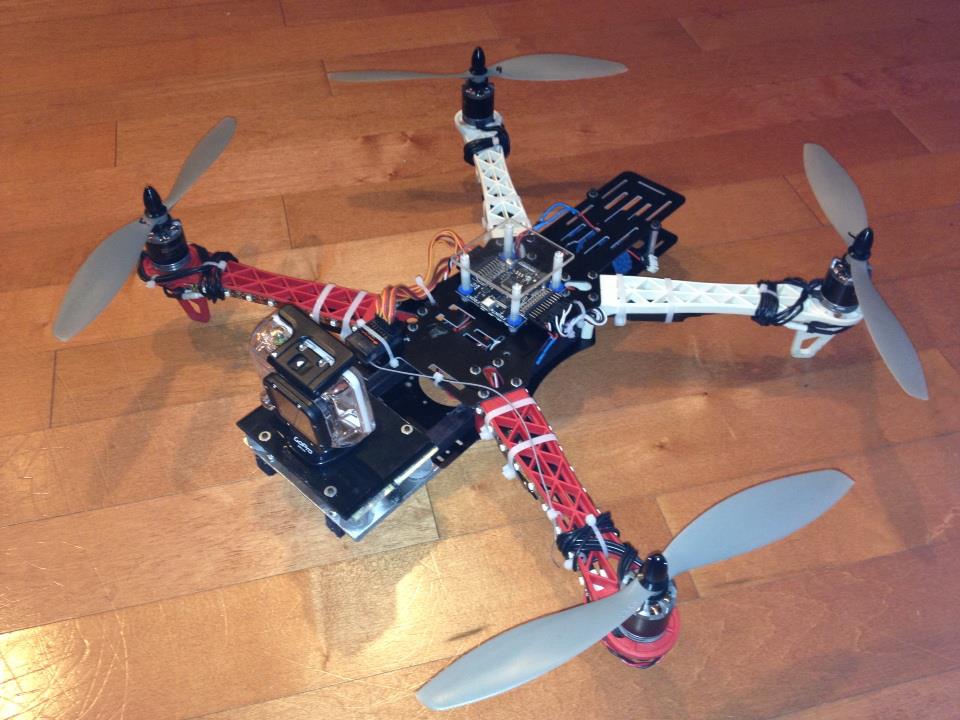

After quite a while I finally realized a goal.
That goal was to have a small mobile quad for a GoPro 3 that I'm not afraid to get into "sticky" situations, fly a bit faster and even "risk" if the shot is right.
After sourcing the stuff I wanted, I started on the quest.
Two frames, 3 sets of motors, and 2 sets of esc's later I found my mojo.
Ebay 500size Spider frame (discovery clone-ish thing) Keeps the arms away from the camera
Nice T-motor 900kv motors on 10-45 APC SF props.
Hobbywing 40amp ESC's
Hoverfly Sport Flight Control

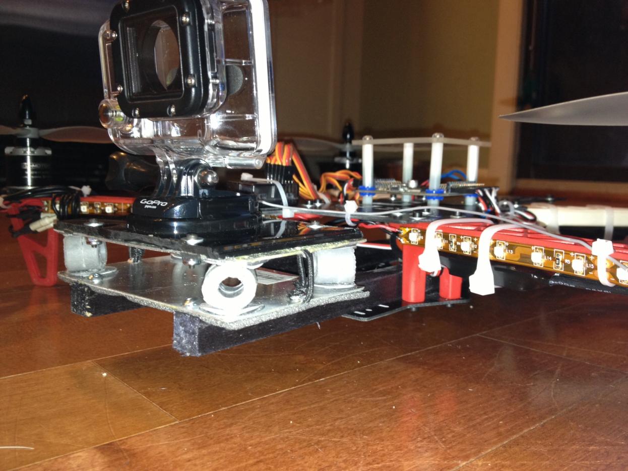

I ran two pine 3/4 square dowels out of the frame (wood tends to be a natural vibration dampener) and mounted the Turkish "ebay anti vibe" pad.

And I know I left the motor leads long and wrapped them around the arms which looks sloppy, but I have another project for these some day so I didn't want to cut them.

Is that HoverSport a mother to control FPV? I have one in my fold-n-fly but I was going to switch over to a Naza since it has auto level and GPS. After flying the sport for a few hours within LOS I was thinking there was no way I could handle FPV with it. Looks good though! Surprised the 10" SF work that well on those motors/setup as I am using 8" SF and although it could use a little more, it spics the props really fast which is great for getting rid of jello and flying in wind. Are you on 4s?

I'm on 3S, and the motors seem really efficient with the 10" props. Not even warm when I landed. (it was 28 deg F though) I got 8 min on a 3S 2600 pack with 500 left in it. It seemed REALLY smooth as well.
And I LOVE the HF S. I have the gain cranked pretty high and added some expo to slow my corrections down and it feels great.

Bravo! This is very smart. I have also been in the Jello path, so to speak, and used all sorts of vibration absorbing material but never thought of this simple yet effective configuration. Are they silicone tubing sections? You got me thinking now...

That footage looks nice. .. specially for not having a moving camera mount. Is that some kind if soft dampner between the layers where your cam mount is located?

Yes, the two plates are suspended with 4 very soft but still not too soft rubber bobbins. And then has a nylon elastic cord on each side pulling the plates gently in. If I use a heavier camera there are plastic bobbins that go inside the rubber bobbins to stiffen them up a little. It seems to work great.
