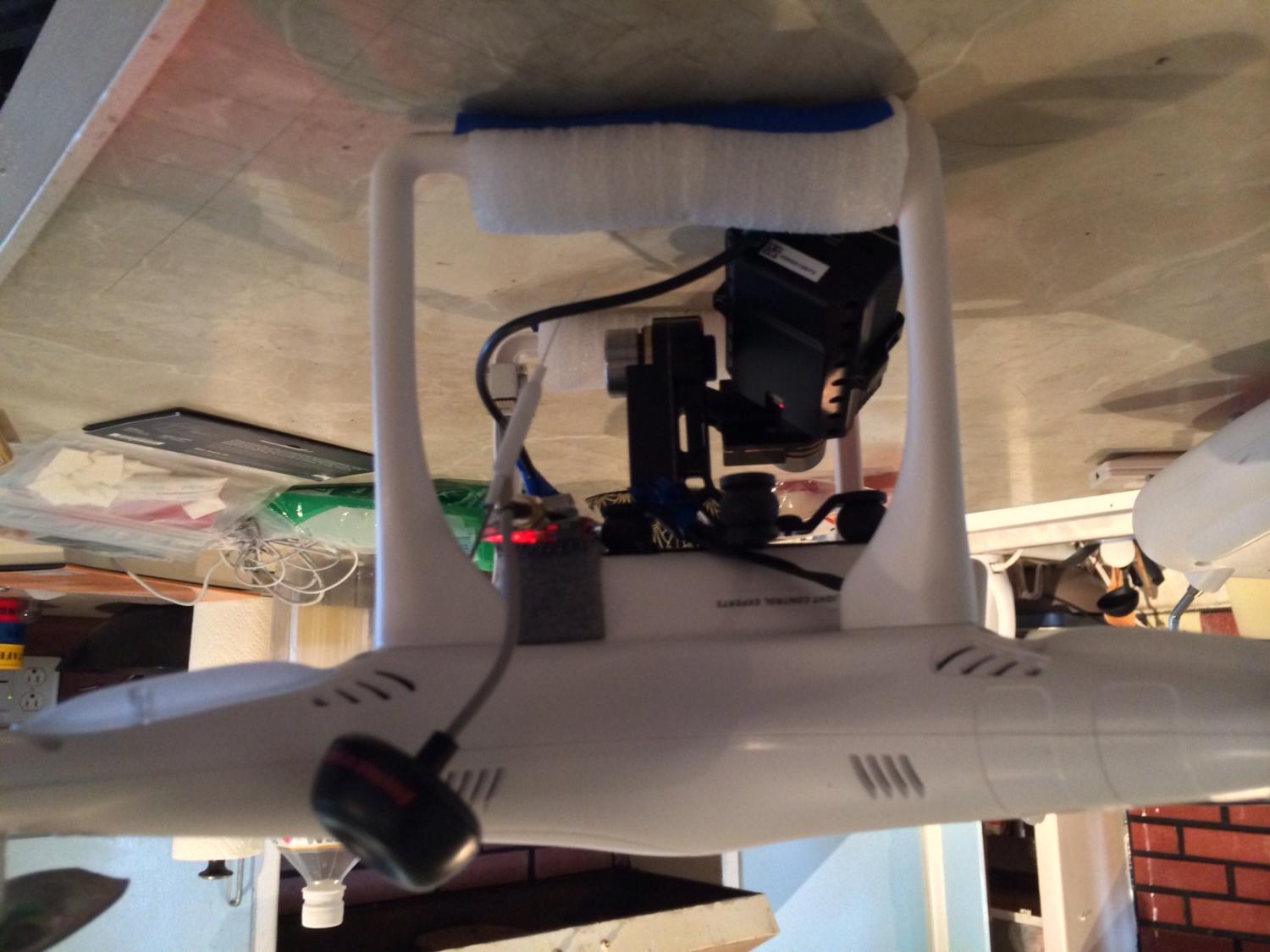

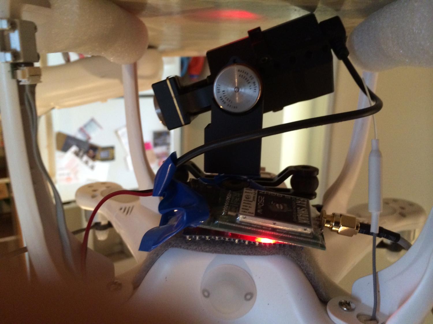

It's causing interference with the Zenmuse I am sure. I couldn't see where you had things located like the antenna and the board for the Video Transmitter. Is it close to anything that controls the Zenmuse? Can you post a picture of where the board/cables/antenna are located?

I would suggest the problem is almost certainly the weight of the cable. The zenmuse is really sensitive about balance, sometimes even the wind will trip it. Why no use the video feed of the backpac port which the zenmuse is already running through the arms into the GCU?
