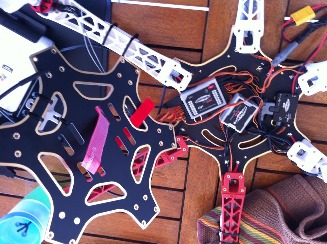

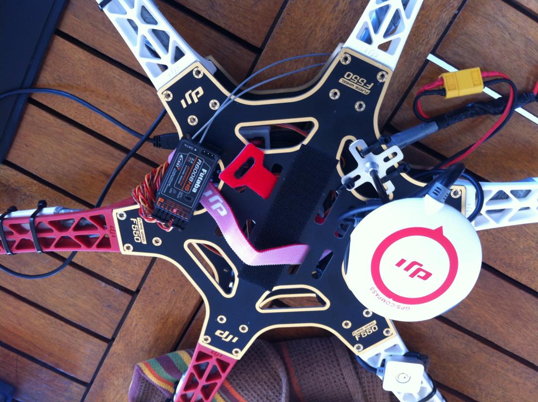

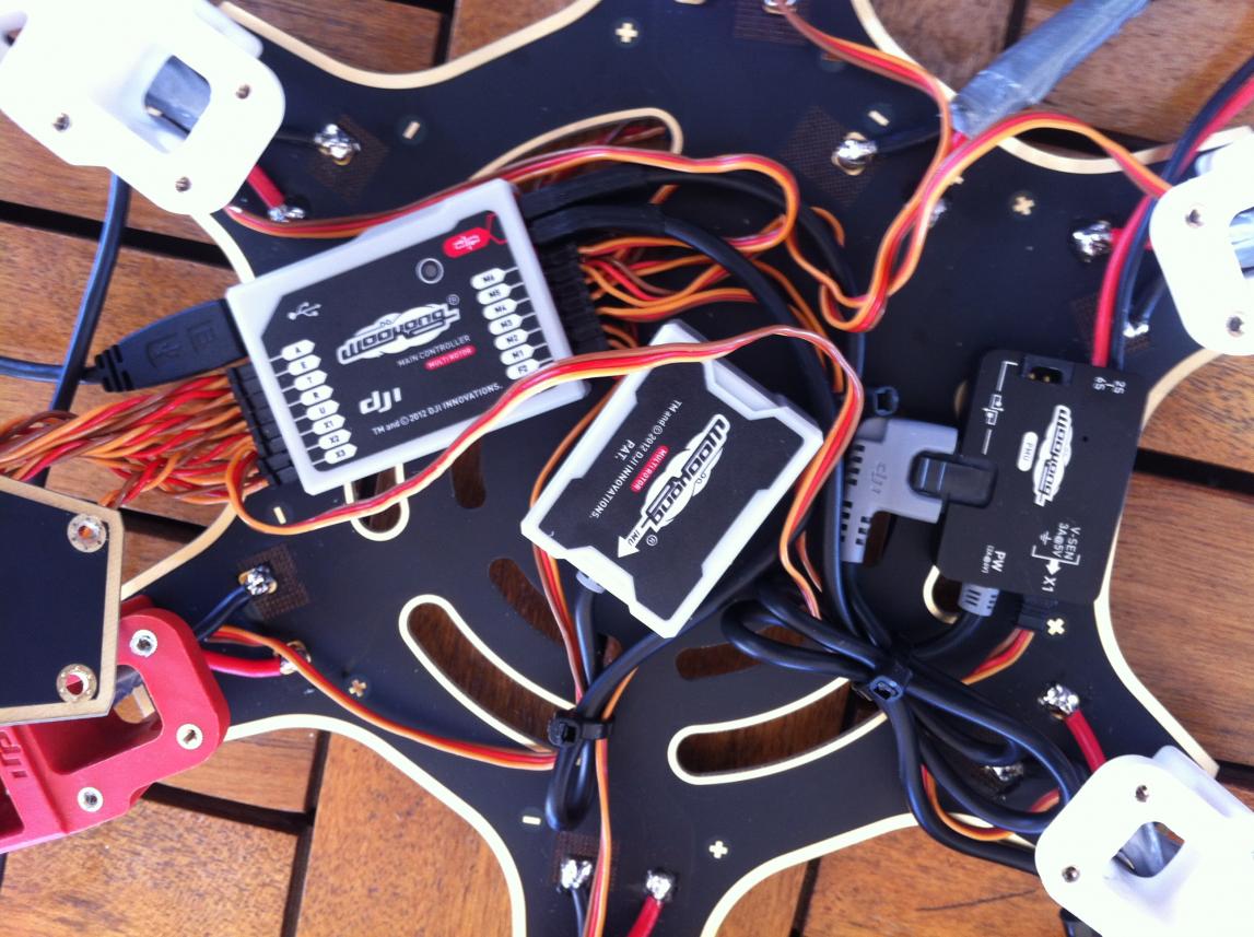

Hello to all,
My name Antonis from Athens /Greece ,
Build a 550 with WKM ... Step by step install the program DJI WKM all ok ...
Now I have a problem, after from install the program and fix all parameter for my f550 (x/z for gps /calibrator tx / failure safe mode gps ...) don't spin the motors !!!!
I saw many others parameters from my tx (futaba 10CG ) and from my F550/ WKM / and program .
I Test esc's alone with motors and it is ok ...!!! I put Esc (without D Bus) on receiver and all Esc and motors
After all the above I understand that the D Bus *not send commands to the receiver ...
Is there a secret, any tips, something that did not, beyond the manioual and program?
Good wishes To all.
Antonis

i had the same issues, in my case i had a reverse problem: So when you do CSC moving both Sticks down and left, all sliders in the TX Monitor moves to the left?
I have recalibrated tx,adjusted course on spectrum, ensured in the assistant that sticks go to endpoint.....stil csc not working :(

Antonis, i wrote the same for you, have you tried that?
Hav you setted from traditional mode to DBus in the Assistant?
-meme
Antwnis
Thanks a lot meme...
who did not understand what I was responding to...sorry
I have a original DJI WKM and I write for dbus the object end up in the esc's and has outputs for the transmitter ...Maybe I'm wrong in the name.
The truth is that esc and normally MOTOR easements on their own, but once the connections over the wkm not operate.
