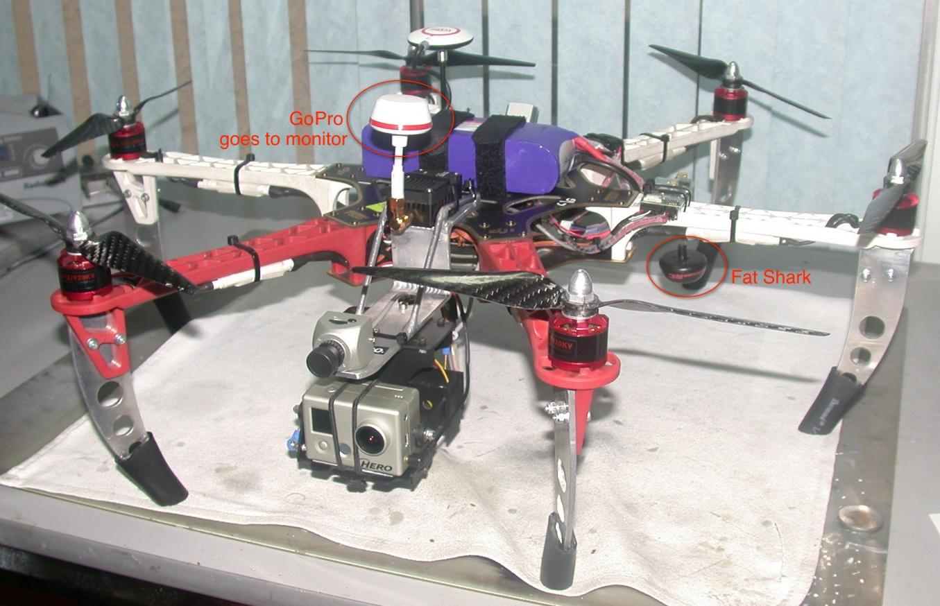

My F550 weighs 2300g and running 4s 4400mah with 9x5 CF props and it flies like an eagle. All the power needed with stock motors.
Hmm, maybe I am heavier than I think then since i'm running quadframe 215mm landing gear, rctimer nex gimbal, and 270g worth of camera which looks like it ought to be heavier than what I see in your pic.
