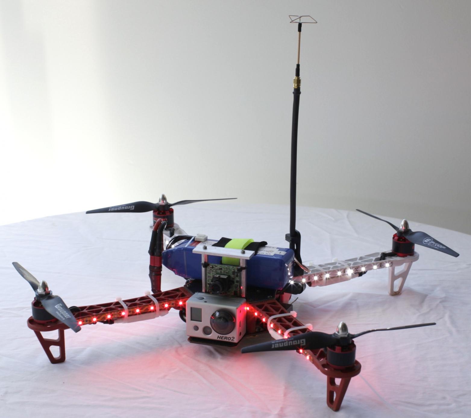

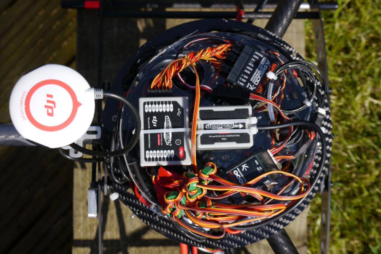

A few months back I saw some videos online of people flying FPV, thinking that it was totally cool and that it kind of fulfilled this childhood dream I had of actually being able to fly. Inspired and motivated by this, I bought a Blade MQX so that I could learn to fly an MRC. I'd never had any prior RC experience and crashed the sh*t out of it for a couple of weeks. Last week I finished my first quad set up for FPV flying. After tweaking it LOS over the weekend, I took it out on Monday for my first FPV flight using only a monitor and a friend as a spotter. Unfortunately, the battery on the GoPro I was using had discharged, so I couldn't record the 4 flights I did, which all well other than a little bit of weed-whacking on takeoff. I went out again Tuesday morning and flew another 4 flights. These are video clips from the second set of flights. The GoPro is hard-mounted to the frame. No post stabilization.

makes for some fun vids dont it. looks great, flew perfect
what are you using for vid receiver? how was the reception. that the windmill or something like that CP? any idea how far you went? how was reception?
tstrike
pendejo grande

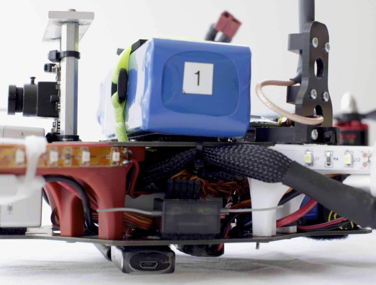

Well done! Do you have something under the gopro for anti vibration and what's that over the gopro lens?
tom
azure
I'm using the IRC Uno 5800. Antennas are TrueRC Omni CP's: vTX Windmill, vRX Fan - similar to IBC's Blubeams. I got out about 400 meters. LOS reception was totally clean. Penetration through the trees was not great, but for the most part flyable through the static.
azure
tom
Thanks, Tom. It's just some Velcro under the camera attaching it to the frame, a small strip of squishy foam behind the camera where it rests against the frame, and a couple of heavy duty rubber bands to hold it all together (not shown in the pics). I also balanced the props carefully with an HK balancer. Because I was fighting to keep weight down (currently at 1600g AUW), I took the GoPro out of its housing. The lens portion of the housing acts like a kind of diopter that's necessary to get proper focus. Without it, stuff is soft at infinity. I took this diopter out of the housing (it's a series of screws) and simply used rubber cement on the edges of the plastic to re-attach it to the camera. It has the added benefit of protecting the lens when crashing through weeds.

You could sure lose some weight by ditchin the batt for video and using a ubec off your 450's battery balance plug. Again well done and some steel balls to do a straight in fly over at that speed on your second day of fpv'n. So far my experience has been fiddle around trying to make things work, getting tired of messing with it, take it all off and just fly los w/gopro. One day, one day...

A little over a grand for the stock MRC, NAZA, Tx/Rx, props, antennas, monitor, tripod, etc. Then add batteries and a GoPro.

I actually find it easier to fly FPV as compared to "nose-in" LOS or when the MRC is far away and hard to see for orientation. I've got a couple thousand hours in full-scale, fixed wing aircraft, along with a little bit of rotor time, and I'm finding that flying FPV translates in terms of sight picture and timing for control inputs. I do think that flying a multirotor LOS is harder than any full scale flying that I've done. And that includes instrument flying.
The battery for the video bus weighs only 70g and provides enough power for over an hour and a half of continuous use. By the time I figured out where to fit a BEC and a filter, it was just easier to go with the battery. Plus it makes for really clean video.
