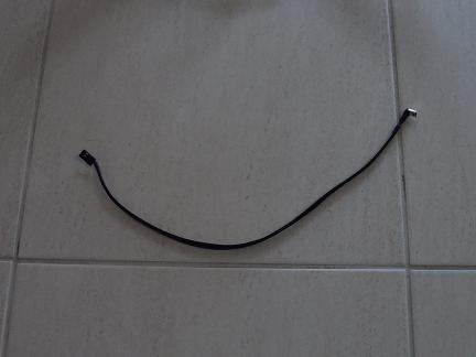

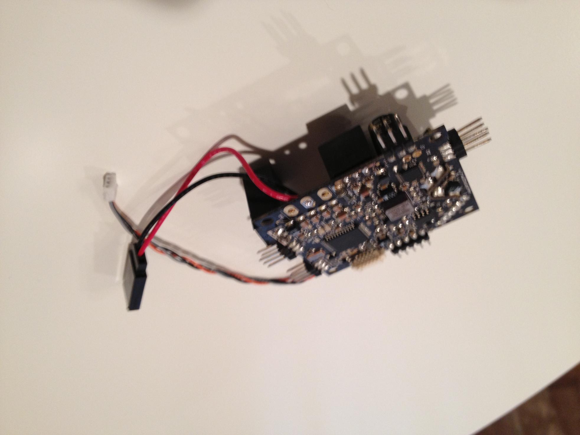

The last Upgrade was a cable from the Turnigy Rx to the USB Go Pro port so I can charge it on board if the battery dry out!!!

I forgot to ask If any one have any idea why that hapen't????
The cable was pluged on an free port on the Rx (red/black only wires)????
After the crash I unplug the cable and the F450 was fine just like new!!!!! exept the gimbal break!!!

Kloner did you plug it on the Rx because the same maneuver happen't to me!
Now I use an extra bec only for the go pro!
no, had it plugged into the 5 volt on my core,,,, video power supply thing from TBS. Walked over, unplugged that thing and flew away from where it came to rest there. Lucky it didn't hit the fence another 50' away
i had my hero2 battery out and was just using that rear plug to power the camera. the rig had a fixed fpv cam so i wasn't even using the live feed, but it did something to trip my system out.......
