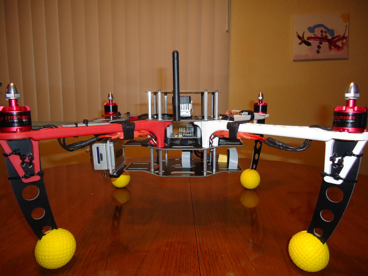

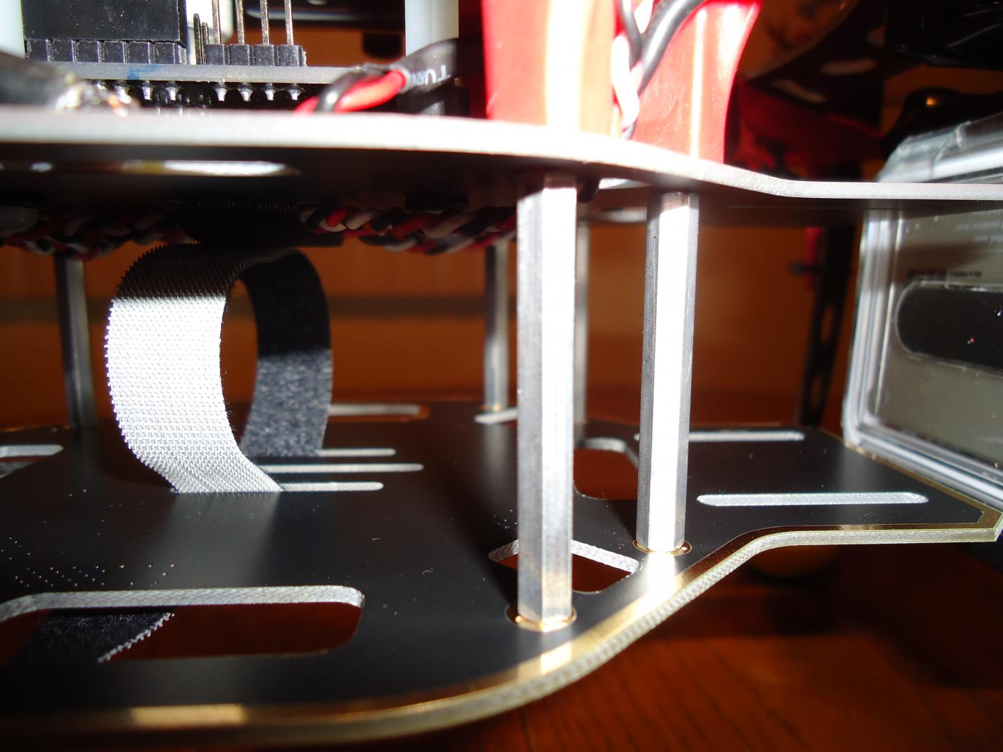

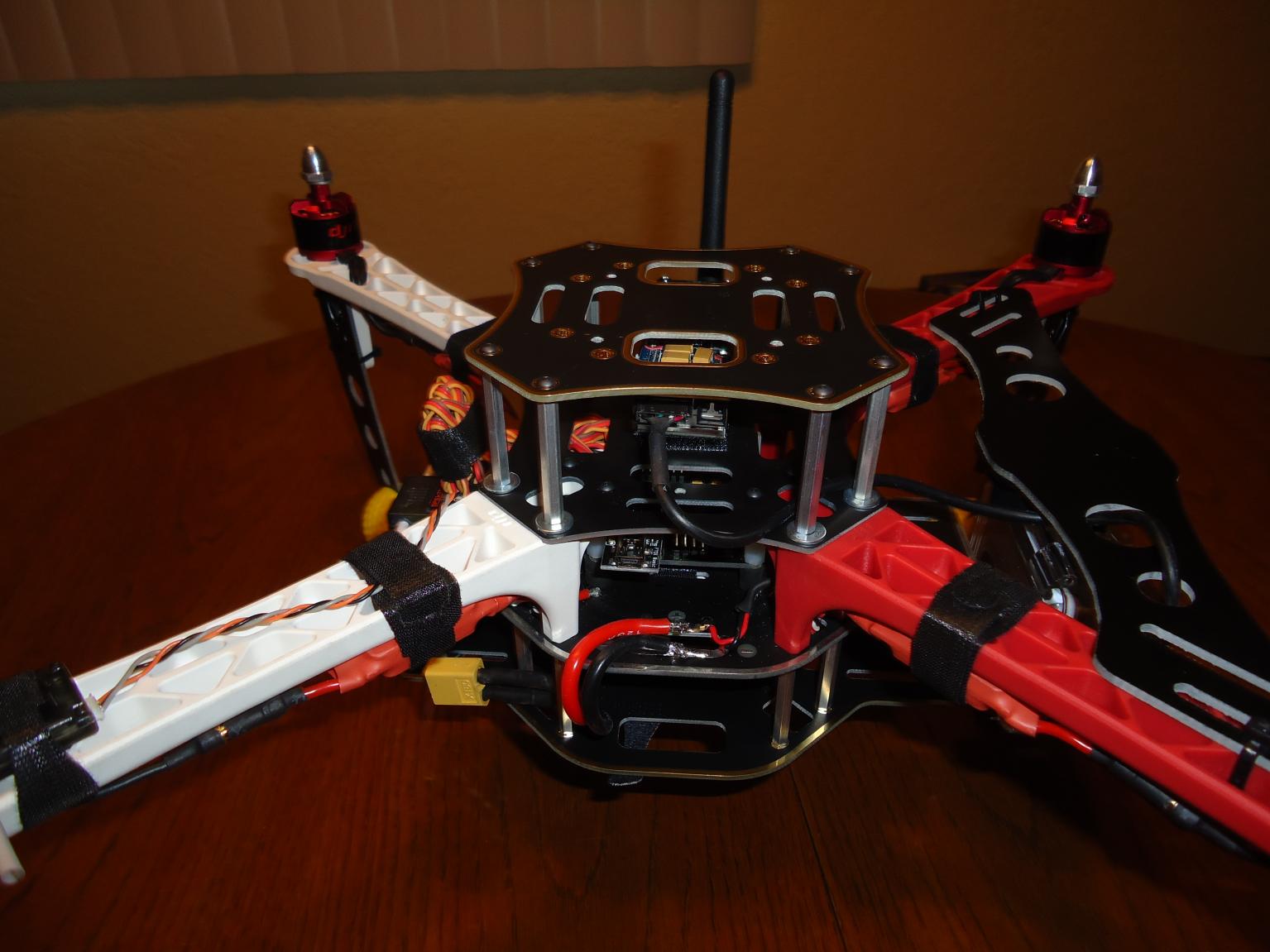

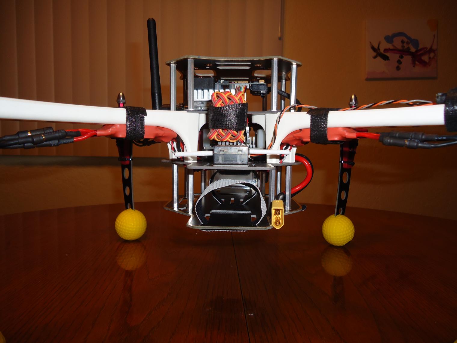

I purchased another bottom plate and secured it to the original bottom plate using: (x8)Metric Aluminum Female Threaded Hex Standoff 4.5mm Hex, 37mm Length M2.5 Screw Sizes and (x8)Metric 18-8 Ss Cup Point Set Screw M2.5 Size, 10mm Long, .45mm Pitch from MCmaster.com (Awesome Site!!!). This gives me a 53mm x 37 mm opening to slide the battery into. You will still have to secure the battery with a velcro strap but this idea protects it from belly flops and has a clean look.
Fireeater
Here is the pics of my build using additional an additional frame plate for a battery mount. I hope this will help you on your battery mounting ideas. Off the subject but can someone might help me with a decision. The current setup is using a 3s battery and APC 10x4.7 props weighing AUW 1650 grams. My flight times are around 8 minutes and 70% throttle to hover. Can I increase the props to Graupner 11x5 to gain more lift and longer flight times? Ecalc shows my motor amps above manufacturer recomendations with 11' props. I see others running 11" proprellers but are they ruining their motors?

The build looks excellent as do the photos. I assume you have software that can rotate your GoPro videos 180 degrees so they can be viewed rightside up. If you want to reduce the overall weight to gain more airtime, hexagonal nylon standoffs are also available as an option to the aluminum and you can cut identical top and bottom plates out of carbon fiber plate.
The foam rubber golf balls may be light but they also create airflow drag. I would just use a short piece of heat shrink for the tips.
IMHO.... While there might be a small safety factor built in to the motor data, the longevity of the motors likely will be compromised. More specifically the enamel insulation on the copper windings of the motor will break down primarily due to heat especially closer to to motor terminals. That will lead to an electrical short and one or more failed motors. Also excessive heat will permanently reduce some of the magnetic strength of the motor magnets requiring more throttle to achieve the same flight performance as previously.
Fireeater
Thanks for the comments on the mutlirotor. This is my first quadrotor and I have had as much fun modifying the DJI450 as flying it. The GoPro has a setting in the options to reverse veiw which is nice for this set up. Also thanks for the advise on reducing weight. I will make those changes with my spring project using as DJI550 using the same stacking concept. Since this is my first mulirotor. This robust setup is more suited to my periodic ground checks and other mishaps. I noticed on Ecalc that the box that became red was "max. current". So my thought is that as long as I don't give it full throttle, I should not damage the motor. Is that a plausable idea?

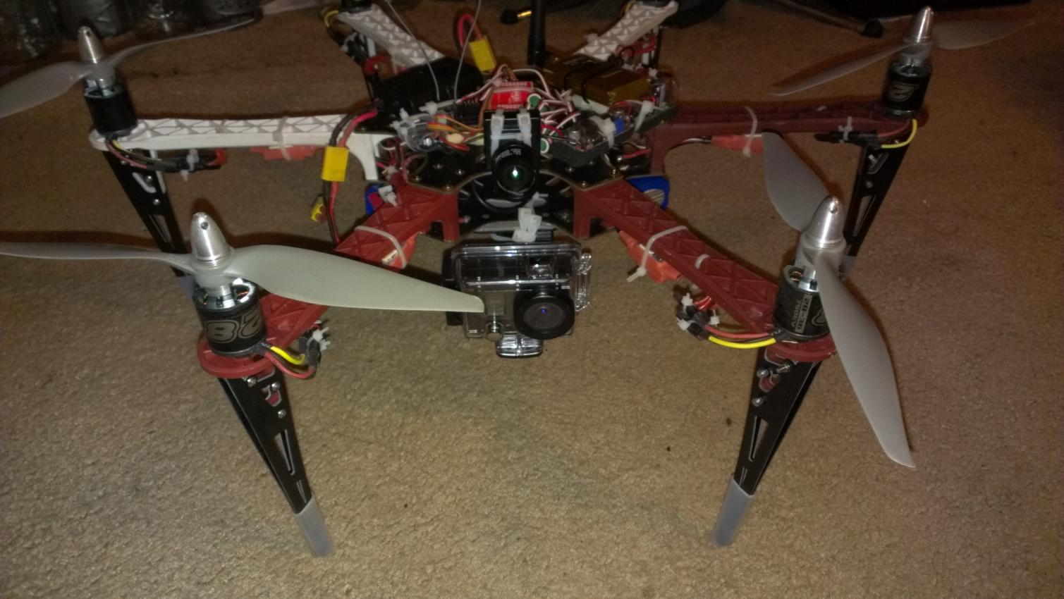

Order some legs, they make a WORLD of difference and are completely necessary in my opinion. I had thought that the legs would negatively effect the flight characteristics of my hexa but I was wrong, it's the opposite. The legs allowed me to added 2 batteries underneath and put my Go Pro knock off camera under there as well. The weight underneath the Hexa made it much, much more stable and much more fun to fly. I use velcro battery straps and I can swap out 2 battery packs in less than 2 minutes and be back up and flying on a fresh set. I highly recommend it if you like the idea and I think it looks mean that way, people say mine looks like a flying spider :)
