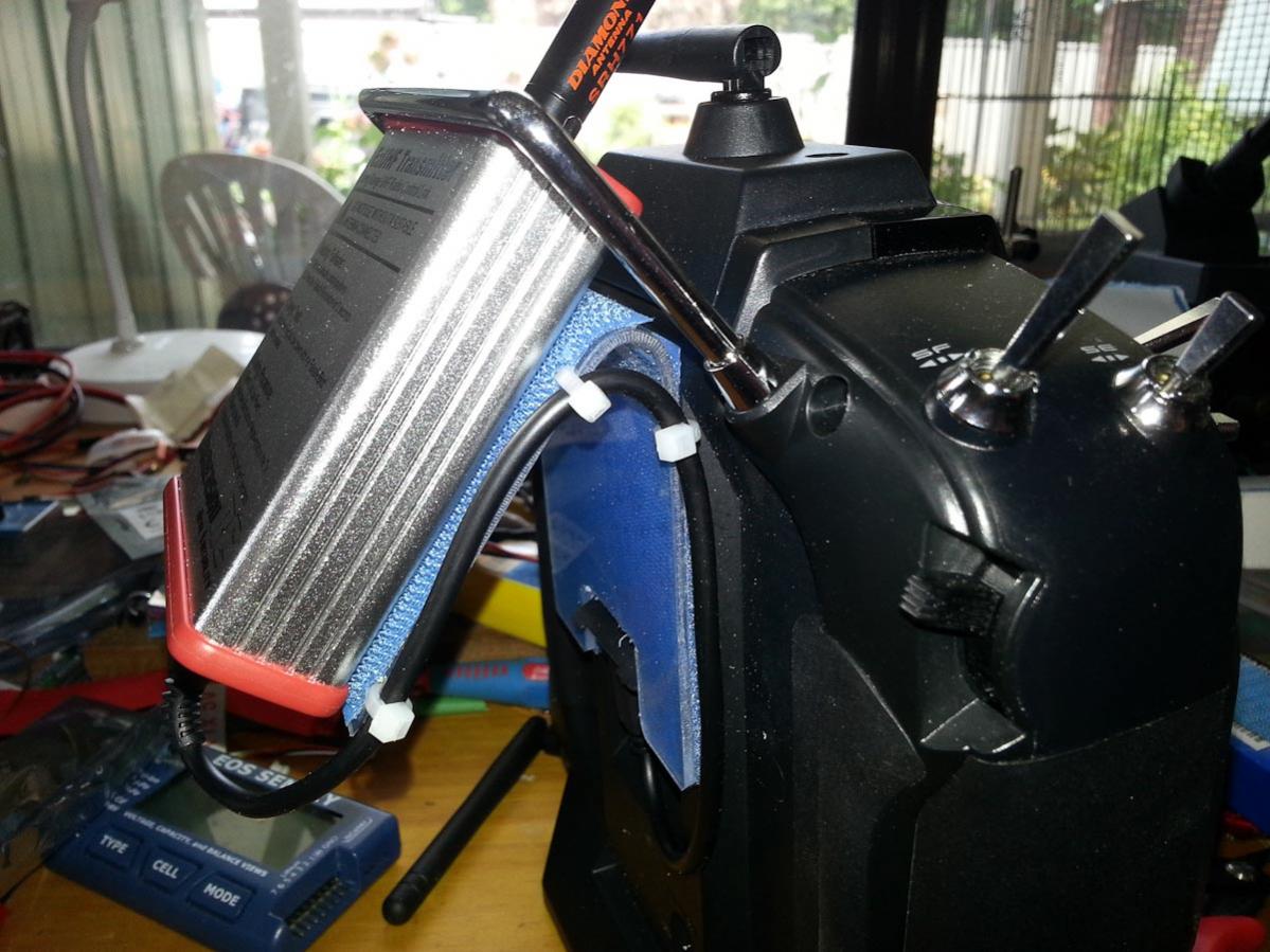

I have been using rubber bands to hold the TX to my radio, but this was kinda nasty looking and if a band broke, well my TX would surely fall off and probably disconnect. So yesterday I played with some plastic and a rework hot temp air gun at 190° to form some clear plastic I had laying around, the result is a mount my TX goes onto which provides clearance and a nice angle on the antenna to keep it almost vertical while in use.
Here it is.
My radio is not really that dusty! Flashes show up the worst don't they... lol

If anyone is interested, you can't get the EZUHF to fit behind the handle on these radios, I was meant to mention that part, hence the mount to make it slip through.

Nice, I made a similar setup from polycarbonate some time back, makes it easy to also mount a 3S 1000mH pack up under the EZUHF Tx as well.
Pete

Now that is something I did not think of! I may have to locate one of them flat 3S packs and use it..... now yah got me thinking... lol

I am using a 14SG with a LiFe pack so not getting full power from the EZUHF if I don't use a 3S pack, for a lot of the time I only use low power on 3S but it is the same power as Hi power on the LiFe pack so Hi on the 3S triples the power, nice in the case of emergencies.

That's all I have been doing at the moment, but really due to VTX issues my range has not been too far. I am certainly interested in separating my VTX power away from my TX, but don't want to use some of the batteries I have right now (too big).
My TX right now is still using AA batteries, but I am in the process of buying some single cell button-less Ni-Cd batteries to build my own packs, $60 for 4 a 4 cell pack for my radio is ridiculous.
