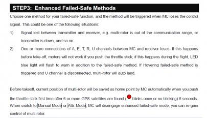

Assuming the MR is in RTH failsafe mode, is there a way to take control back when it is in the process of returning home? The RTH process works flawlessly, but I'd like to be able to bring the MR back, but then take control and not land. It will go go into failsafe with either a switch or by shutting off the controller currently. Flipping the switch back to normal will not take it out of failsafe. Any ideas? I hate to mess with too many switches seeing if anything happens.

mikael
sdfoiler
Ok, call me stupid! I don't know how I missed that this morning when I was reading it again. Sorry for wasting bandwidth! Thanks for the help!!!
