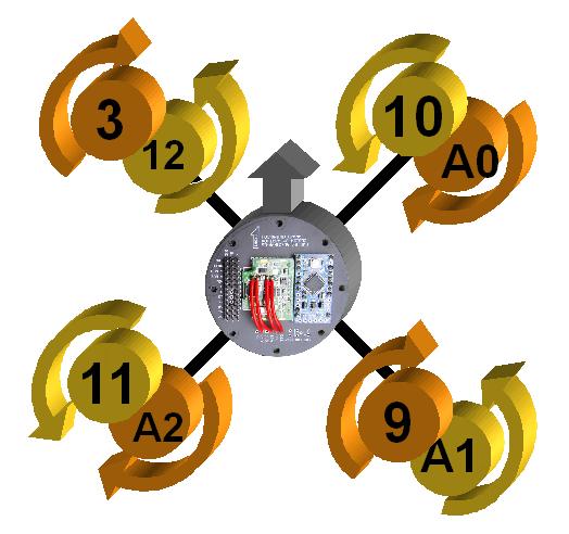

By the X4 coaxial I assume you mean what is typically referred to as an X8 configuration, quad with motors top and bottom? The motors typically do not all spin the same direction. For example on multwii this would be the setup for X8:
You'd really need to test the direction of each motor, the color codes I find aren't always 100% the same.
Another way to handle motor direction would be if you are using the SimonK firmware and you can use the reversed version to change rotation without changing the wiring.
I typically just tack solder and check each motor/esc first to confirm direction then do the final soldering when all are correct for what I need.
You can also use bullets but use a single piece of heatshrink over the connected bullets to ensure they do not come apart. That way you can still switch as needed to get right direction then shrink the covering and it is easy to cut off to remove if you ever need to swap out an ESC or motor.

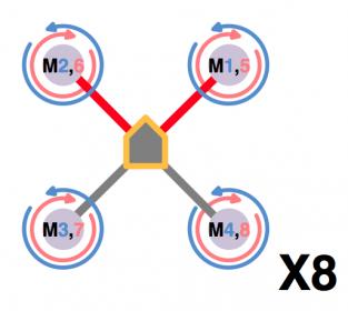

Maybe it varies from controller but my Wookong manual shows this: (Blue = top, red = bottom)
Tacking then confirming direction sounds like a good idea to me

Yes it may vary based on the controller type so always best to base it off what it suggests. Typically for non coaxial setups they are usually the same for all controllers but for some of the other less common ones it can vary.
I usually solder one lead in on each and heatshrink it, then tack the other two and slide the loose heatshrink over just to prevent any shorting then test the direction via a servo tester on each ESC/motor. Since you only ever need to swap 2 connections you can always make one final to start.
