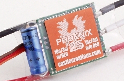

CC Phoenix 25A ESC
In looking for these I notice that two different labels exist for the 25A CC Phoenix ESCs
View attachment 4613View attachment 4614
Both appear to have the same specs on the label. Are these internally identical - apart from the label & possibly older firmware, is there any difference between the two?
Thanks,
Colin
