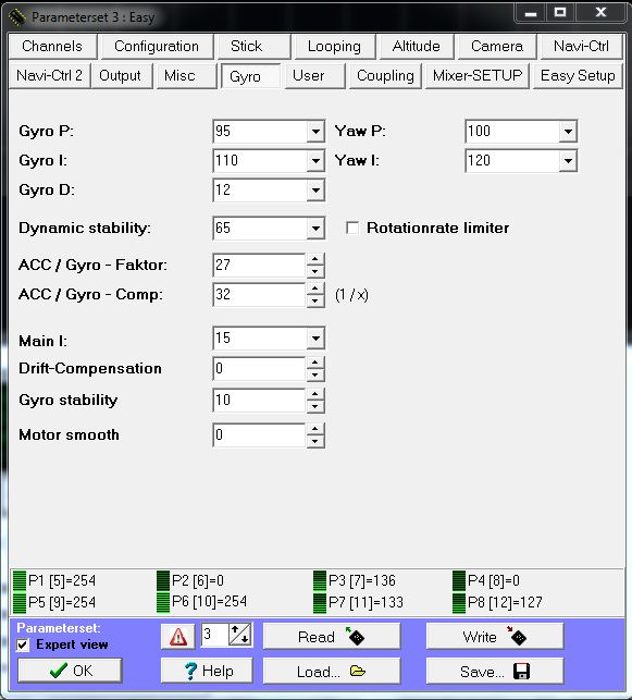

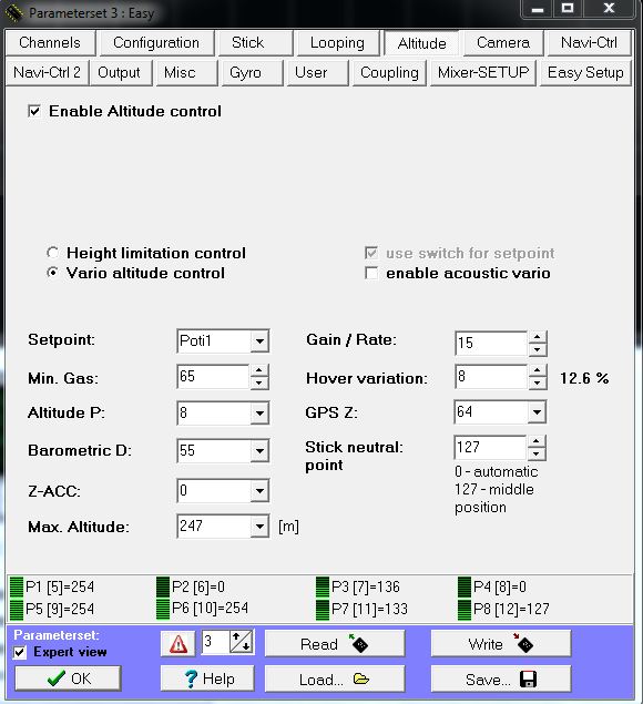

hey wild1,
I have almost the same machine like you. Maybe you can send (pm) me screenshots of the mk GUI with your settings and then I can tell you what to change...
wild1
