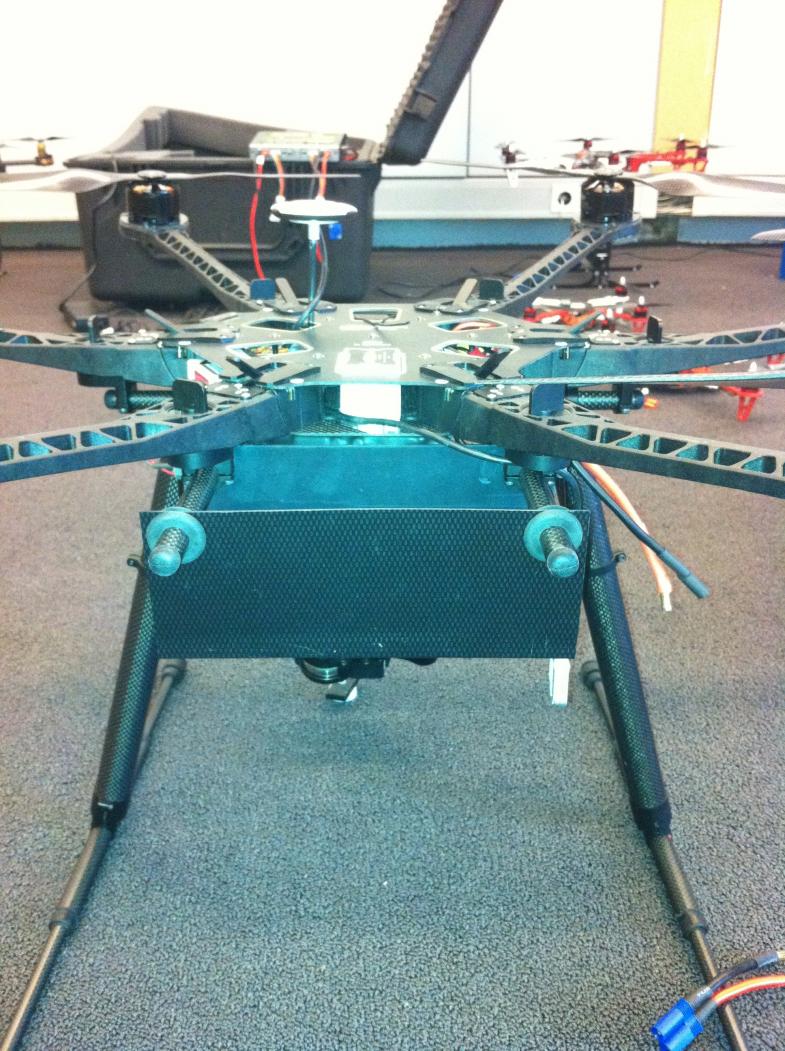

I'm going to be making a batch of motor mount/heat sinks for the droidworx frames. These have really kept keep my motor temps down from being hot to being warm at best. I'm attempting to get a number of interests so I can run a batch and keep the cost down. The design I'm working on is the same as this but with a number of more holes to allow for surface area and lighter weight. I have not noticed any decrease in flight times or abnormal effects from the air pattern.
