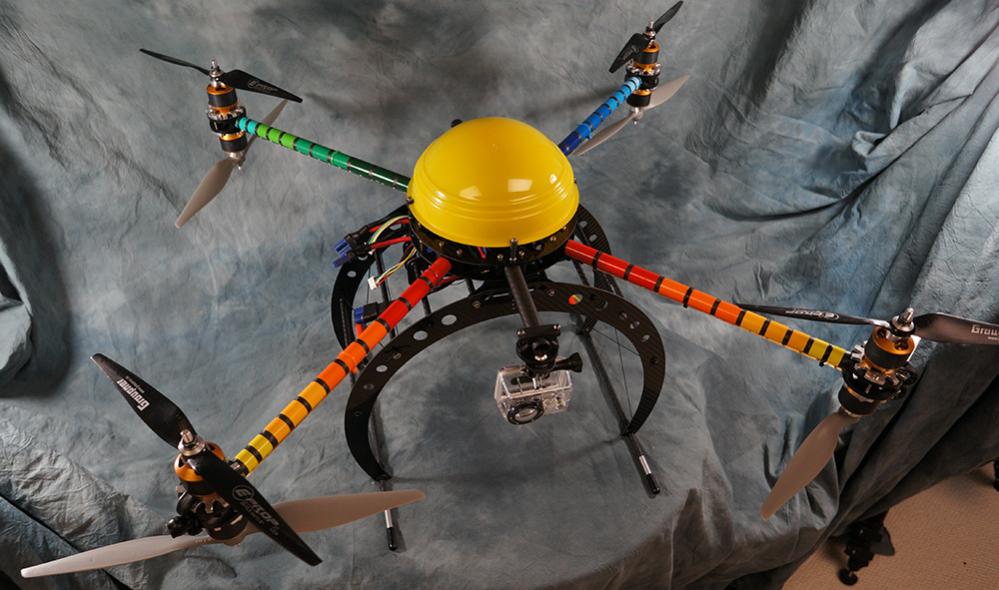

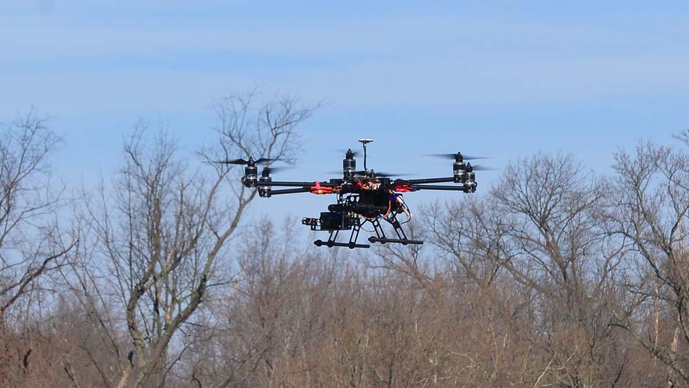

plingboot
Are you using 710 or 770kv Tmotors? Are they 1150 Graupner props? What is the AUW and Flight time. Sorry for the questions, it's a seriously cool Y6 and I'd be interested to know. Cheers.
800kV torxpower motors, 11" prop, but do use 10" as well, AUW with 2 x 4000mAh lipo 3.2kg, my happy/safe flight time 7:30, run to lipo alarm 12:00.
nicwilke
Wow. My ADX-4 X8 is exactly 5kg with a Sony NEX-5n and 2x 5000nAh lipos. I'm wondering what I've done wrong to be so massive over (2 motors cannot weigh 1.8kg?)
I'm happy to go hexa in a month for sure.
ROVguy
Maybe the additional weight in the batteries is enough to make it that heavy?
MrPelican
The Motors are AXI 2814/22 (with the foil logo strips removed) using Graupner 11/5 on the top motor and APC 13/6.5 on the bottom running both at the same gas levels.
This reduces any air binding between blades (if both props are the same) but still induces the counter rotation gyro effect for stability. Basically the top prop and motor delivers the air the lower prop and motor which does the majority of the lifting.
The booms and hub are from and 8 (Okto).
Regards, Greg
