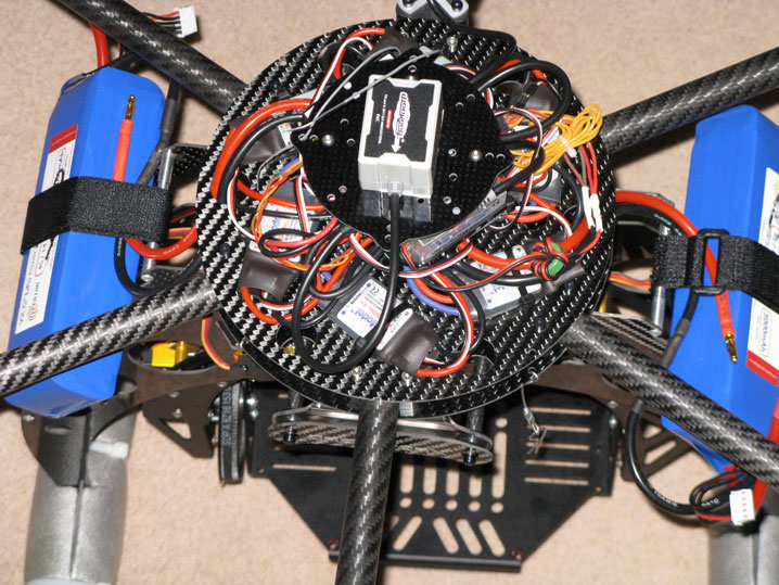

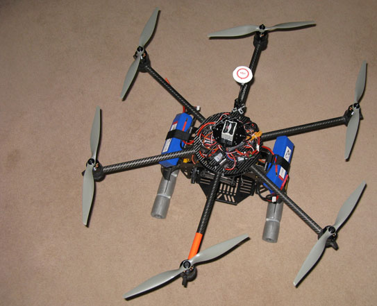

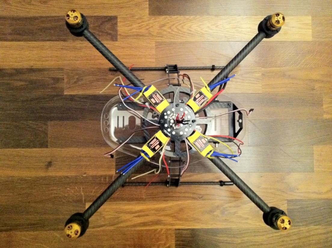

I'm building an AD6-HL... here is one of my initial rough builds -
Cables were messy but it was just for a photo.
I've since crashed after cleaning it up - so im waiting on some replacement parts for a rebuild. (i 'think' due to a loose prop).
Planning to redesign the placement too. ESC's mounted on the Booms near the dome to get better cooling. MC and IMU on the upper middle plate instead of on the raised plate. And GPS mounted inside the dome near the very top.
Very tempted to buy some upgrade parts and move to an Octo also for some redundancy. When I crashed I stripped 3 wires out of a motor (AXI 2814/22) and sheered 2 carbon fibre booms in HALF ! Apart from that and a few broken props... survived pretty well. All electronics and the rest of the carbon fibre survived.

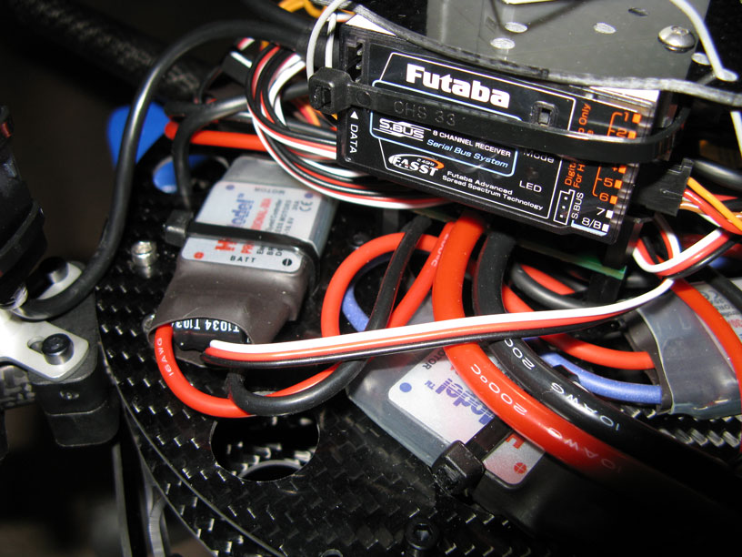

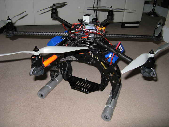

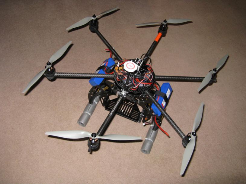

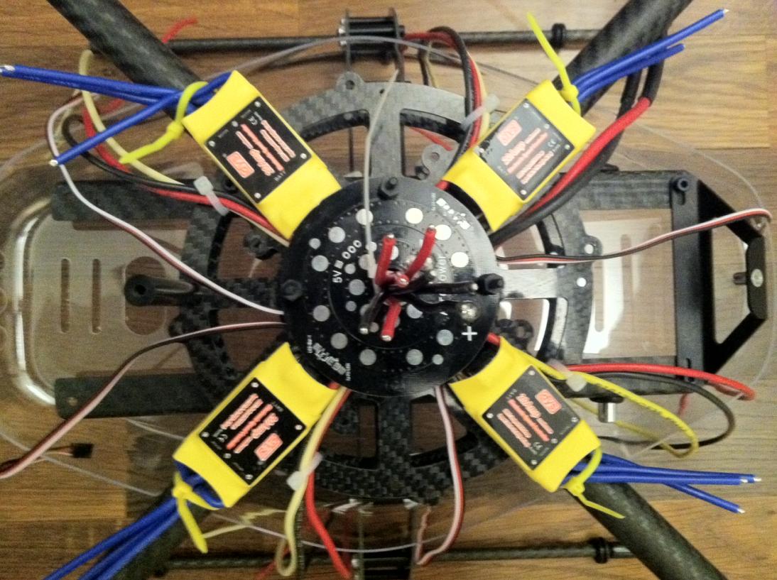

Build now completed, here are some images without dome so you can see the ESC. I have soldered the motor wires direct to the ESC to reduce resistance between connections and also reduce the risk of connections pulling apart, that’s why you may see some additional clear heat shrink on the ESCs. Spec. is AD6 360 frame, AV200 360 mount, 30amp ESC, Pulso U28 motors, 13 6.5e APC props, Photoshipone PD board and two Hyperion 5000mah 4s in parallel.View attachment 1674View attachment 1675View attachment 1676View attachment 1677View attachment 1678
