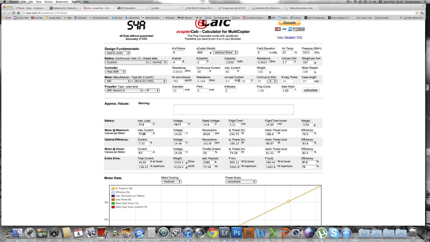

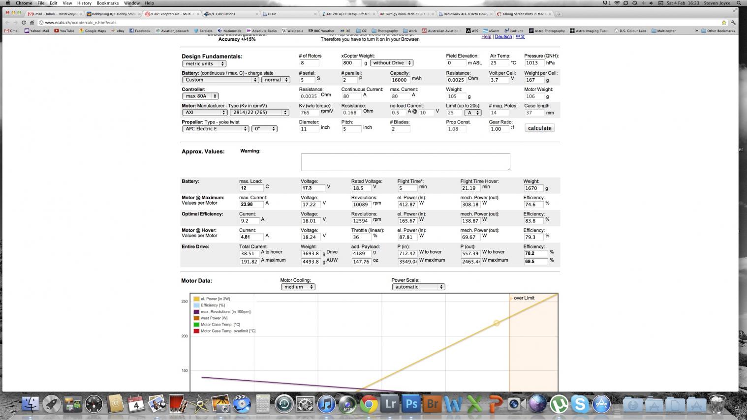

I have both of these in mind for my build - One is a 4s 6000mAh and the other is a 8000mAh 5s. There will be two in parallel to supply my 8 AXI 2814/22 with my WKM with 11 X 5 props.
Option 1 - http://www.hobbyking.com/hobbyking/store/uh_viewitem.asp?idproduct=18209
Option 2 - http://www.hobbyking.com/hobbyking/store/__11940__Turnigy_nano_tech_6000mah_4S_25_50C_Lipo_Pack.html
Both do not have any warnings in ecalc but the 8000 mAh setup has an over limit line on the graph @ 25 amps. Not sure what this means.
Below is the ecalc data for both:
Option 1 - View attachment 2569
Option 2 -
And advice?
