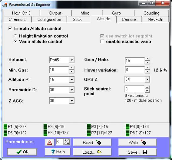

Okay, I took the insulation off the sensor on the FC... Altitudes looks spot on in the OSD display w/ MK Tools. I took it back out to test and every time I toggle my switch to altitude hold it drops like a rock until I switch it off. Curious as to what this could be... If my OSD is showing the altitude - that's means the sensor is actually pushing data. The data however is not being input for it to maintain the altitude? Any ideas?
BorisS
Hi RBlax, just that we are on the same page. It dosent just drop one to two meters and than you switch it off. It would drop all the way, if you have it 10 meters of in the air it would drop those 10 ?. A small drop of 1 to 2 meter can be normal.
Can you capture your setting to altitude hold and post ?
Boris
krleas
FPV Freak
Make a printscreen of your altitude hold setting.
If u have everything on default AD8 will swing few meters up and down.
RBlax
If I have it at 30 meters, it would drop to the ground until... I toggle back to manual power to keep it from repeating the last incident. I'm letting it get to around 8 feet off the ground before I step in.
BorisS
Do u hear beeps when descending?
Enable you acoustic vario its off.
Rblax are you sure you assigned the right poti ? A two position switch on your remote, on off ? In the screenshot your Poti5 is at 126 or 127 seems to me its a 3 position switch.
