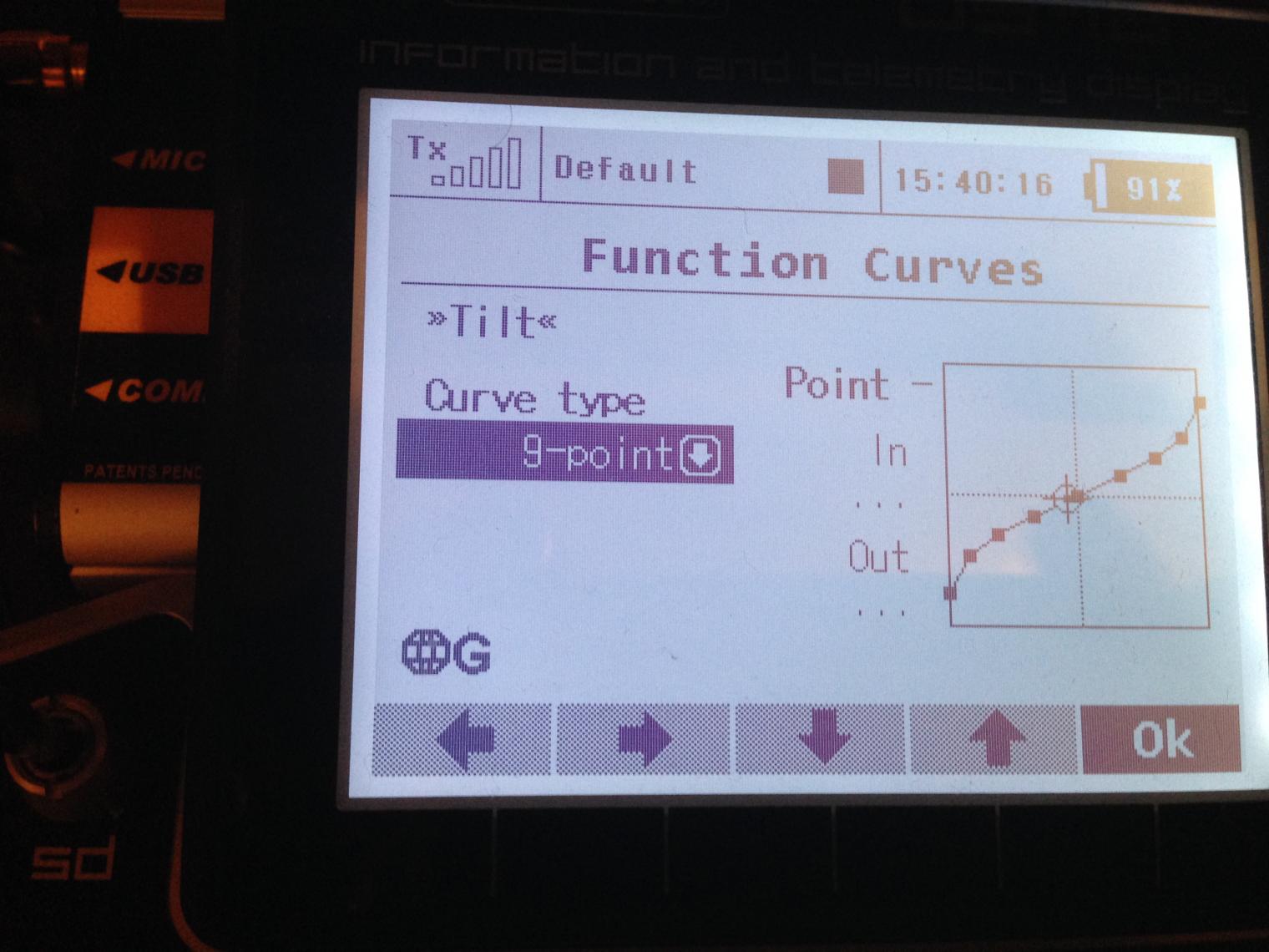

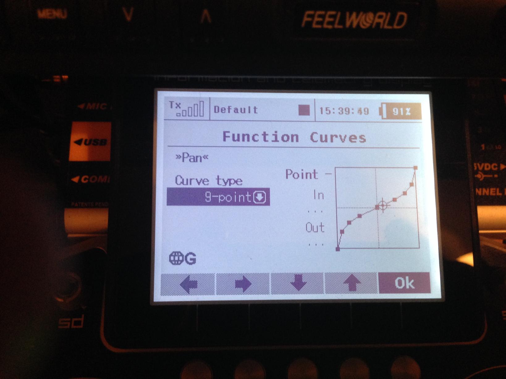

have you tried adding some function curves on your tx? i have nice smooth motion on all axis by creating some custom curves. more to the point on the firmware we need auto levelling of the tilt and roll axis when going to reset mode and aux2 to work.
I have function curves on pan and tilt. Does not change anything.
So you can smoothly start and stop a pan movement without seeing a small jump in the picture when the head starts to move?
rotorvista
yes i have a smooth motion on all axis from standstill to moving. i have flat curves rising to speed the pan/tilt/roll rate as i turn my potentiometer in and out. I do not see a jump when starting the movement.
do you have aux2 control forward/downward facing? do you have auto level of tilt and roll axis when returning to reset mode? do you have full 360 degree rotation in fpv mode?

I don´t need the forward / down channel, so I did not try it. I have auto level on tilt and roll on reset and I have full 360 degree rotation in fpv, but I cannot start smoothly without a small jump. Would you be so kind to post a video of a simple pan movement produced with your gimbal. Like a start - panning - stop. I am really interested to see how this looks on your gimbal. Maybe mine is faulty.
I have expo programmed on my radio but everything this changes is the moment where the gimbal starts to move. (as the curve eases the TX output)

I will do a video tomorrow and post it in this thread. I use a jeti DS16 tx.
