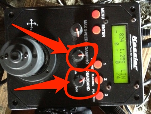

Definitely Zenmuse is not for professional use , just advanced hobbytist ... take a look at the smoothness of that Movi (brushsless cinestar ) .. there is a big difference with the ROBOTIC movements of the Zenmuse . Any crane controller have a damping , ramp or whatever you call it for adjust the smoothness at the end of the movement , even the other stabilizations systems ( mikrokopter , overfly , skyline , radian ) have it but not The Zenmuse
DJI ¿ WHAT ARE YOU WAITING FOR IMPLEMENT THIS DAMPING TO THE ZENMUSE SOFTWARE ?
it's really frustrating when you're trying to make a smooth recording, each time you move the stick to control the Zen the result is very robotic , very hard, no matter the setting of your transmiter or softness of your stick movement , and even worse with pan movement in fpv mode
