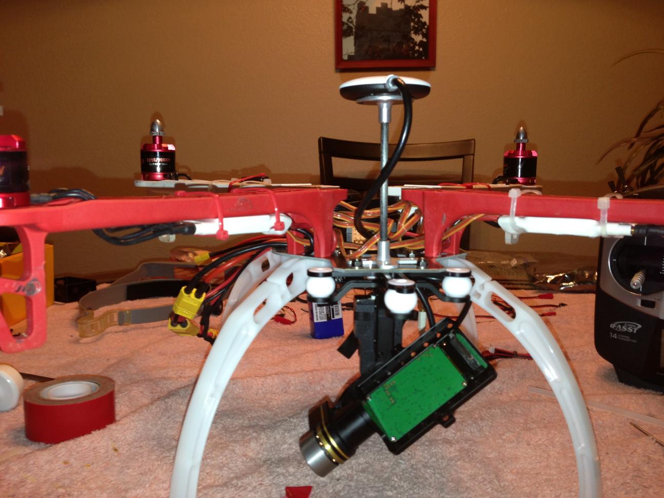

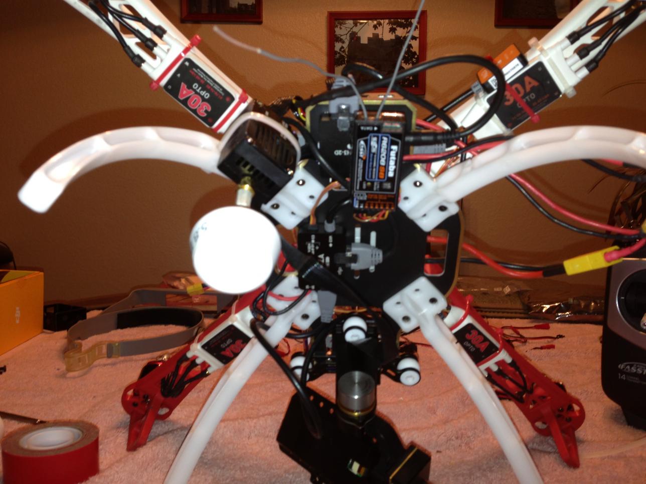

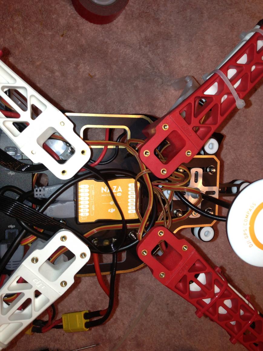

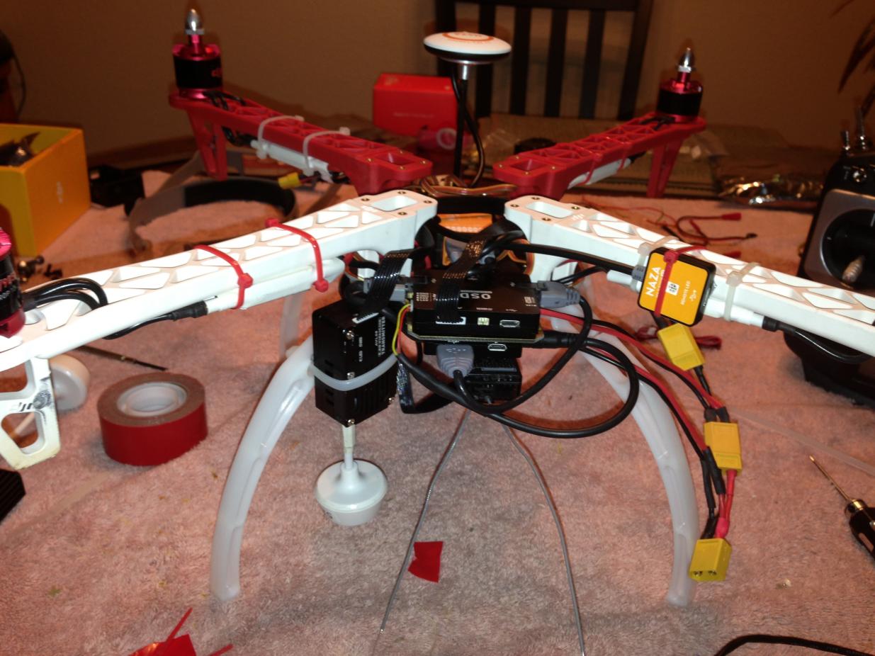

I finished my F450 build with the H3-2D, iOSD and Video Down LInk. There is a lot of electronics on a small platform but it balances well. I am planning on running 4S with the DJI 10x3.8 props. I got a set of the DJI landing gear. They attach with two screws through the bottom plate and into the arms that are longer than the normal screws. They will also work on the F550 and have additional holes to mount at an angle. My only concern is in tall grass, they may not be tall enough to allow the H3-2D to clear. I will find out tomorrow. I have a F550 that has no gimbal but taller landing gear. I will try that next week.
