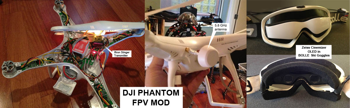

View attachment 8872I did a FPV mod to my Phantom today. The Iftron Stinger transmitter is very small and lightweight so it is perfect to use inside the housing. I used the tip of mounting the camera on the battery door as seen in the vid on this thread and I'm using the Bolle ski goggle mod for the Cinemizer OLED glasses. The image quality is really good. I will use the Quanum telemetry tx for now to monitor battery status until I figure out a better OSD solution.
