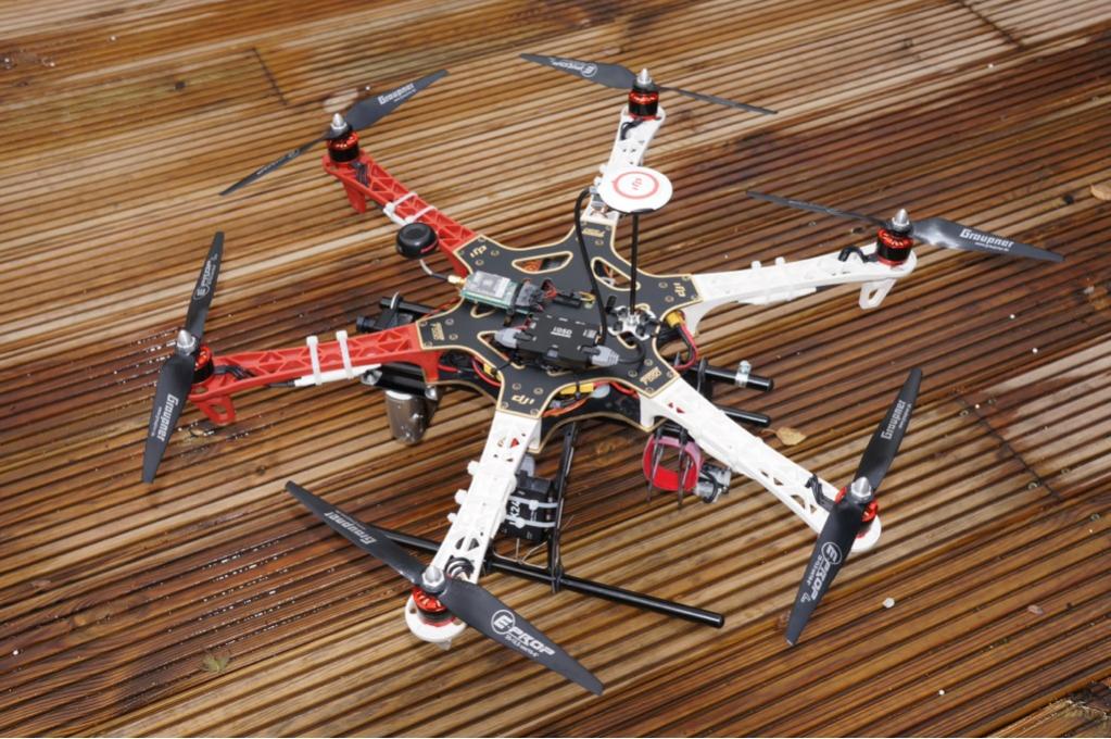

I've fitted mine the other day on wkm well cool worth every penny. I was worried when setting up but when I got confirmation on wiring worked first time.
