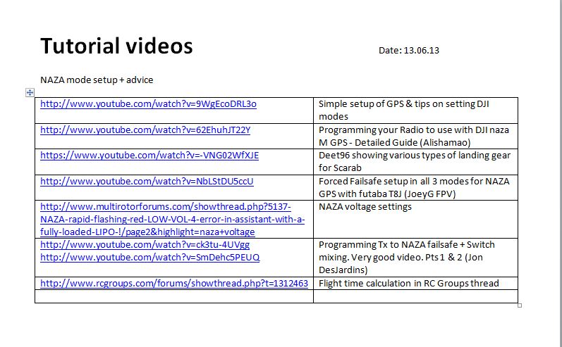

As far as set up of channels on the Futaba this is where I really struggled for help until I watched the DesJardin videos which show how to set up Failsafe & switch mixing on a different Futaba model but I worked out the 18MZ equivalents. REFER to attached list of videos I have found of use.
I'm an absolute newbie to RC setup but my quad seems to fly quite well so far in all modes even though I don't fully understand the theory of the Tx setups. I guess a lot depends upon the hardware you have for your copter, & in my case I bought mine from MultiWiiCopter.com who have a step by step Noob guide to building their Scarab Armour which is what I have. Let me know if you need more help.:apathy:
