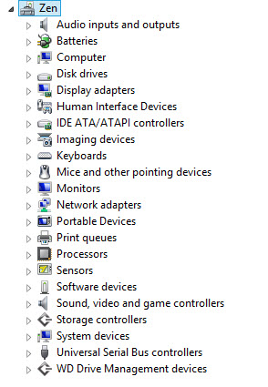

Have a look under your device drivers in your system settings to confirm that the driver is loaded. If it does not show up like in the image I have uploaded your driver is not installed correctly.

Manuel
It was the very first thing I tried, but the computer can not even recognize an unknown device when I put it into the USB port. There is nothing that pops up in device manager.
I also tried to install and uninstall the drivers and numerous USB ports.
And all this on two different PCs - Win7 (64bit) and Win8 (64bit).

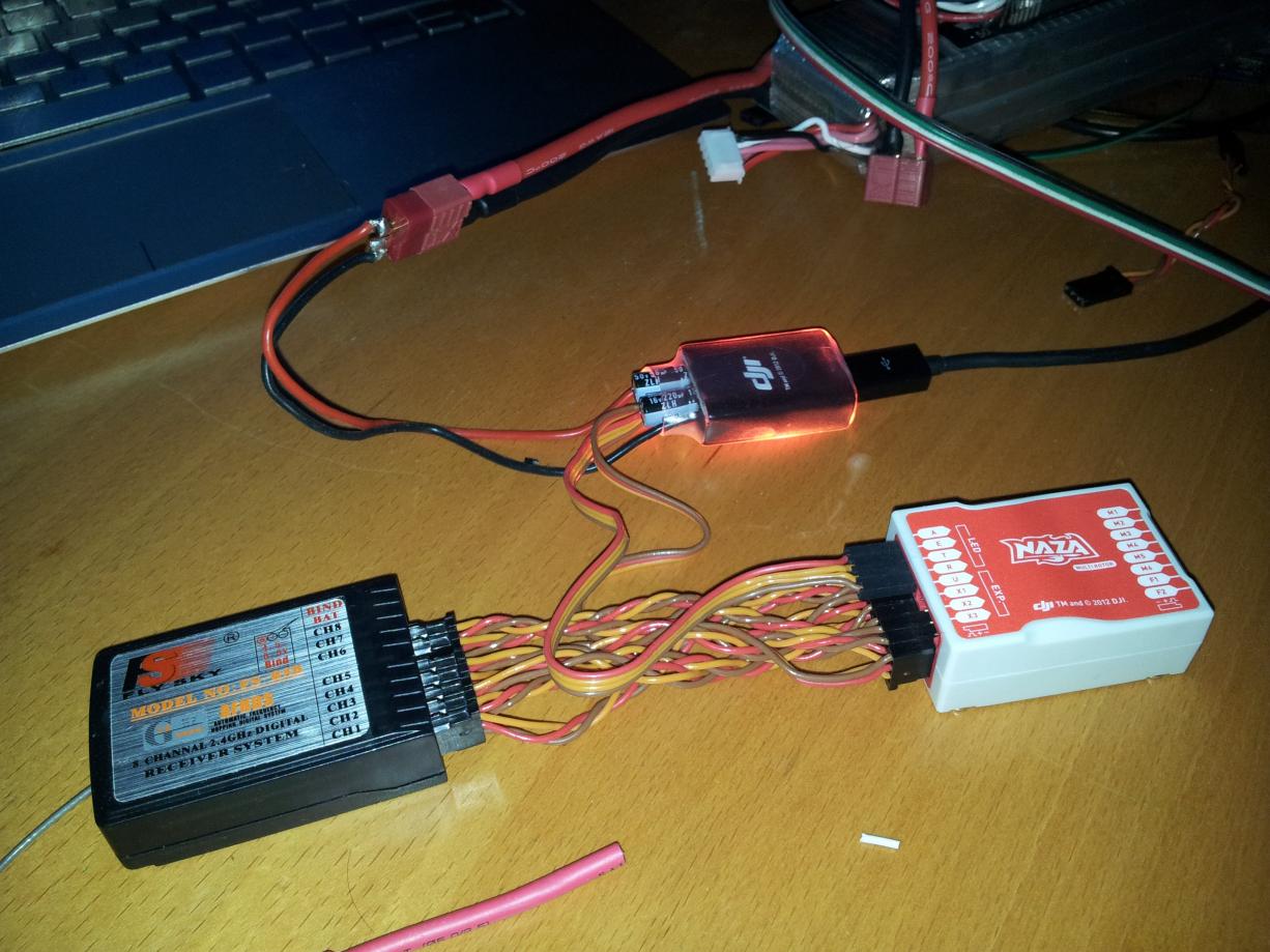

Manuel
Here is my setup of my unit. LED is connected to X3 and LED. It turns orange after three times flashing green. No response to the PC connection, either before or after the green flashes.

TAPPEDOUT
I don't know for sure but think you may need everything wired up and bound to transmitter. LED should be solid green when connected to USB. Try USB ports with Flash Memory Key or something to be certain they work. They can go bad and rest computer work. Sometimes plugging different than intended device can get port to see new device.
