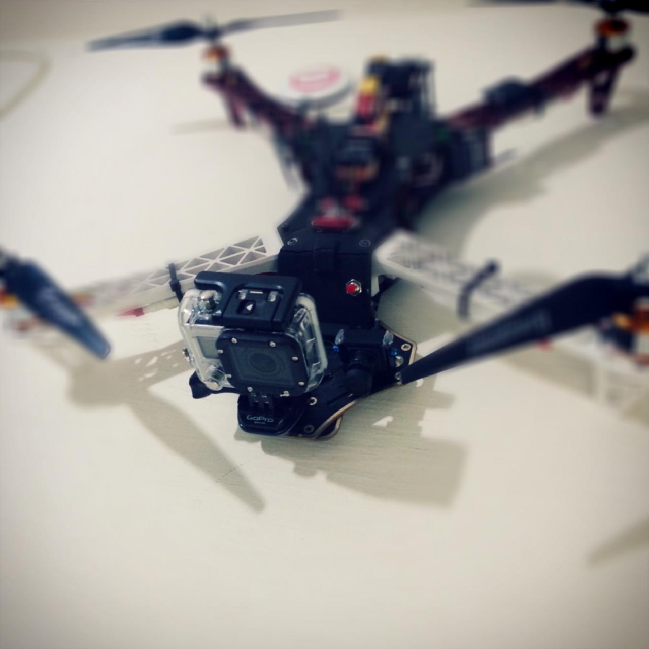

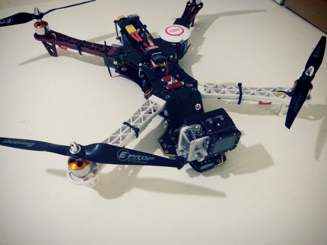

Your props appear to be mounted abnormally high above each motor according to photo 1.
ISeisomometer for IPhone provides vibration date in 3 dimensions, i.e., x,y,z.
While you can almost eliminate the two horizontal vibrations, i.e., x and y..... you cannot eliminate the up/down vibration, i.e., "z" vertical vibration unless you lower your props as close as possible to the top of each motor.
It's like the spinning top effect which will show up on your ISeisomometer app graphical output as a slow frequency imposed on the higher frequency bearing vibrations.
Newer props designed for the newer pancake style motors allow you to mount the props directly on to the motor without a prop adapter thus eliminating most if not all "Z" vertical vibration issues.
