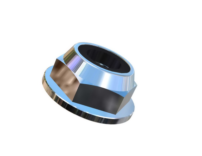

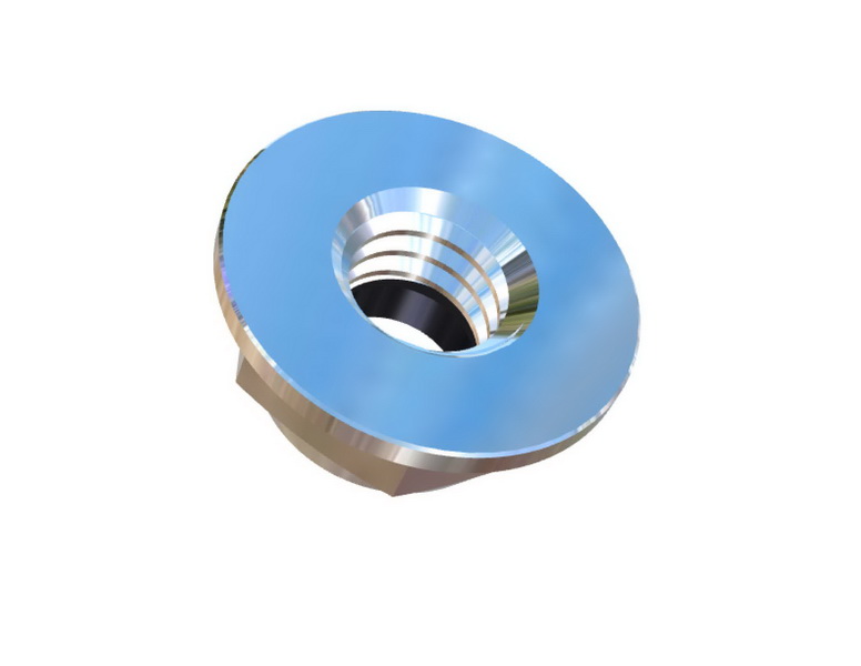

After having one of my props fly off and my Phantom crash and lost the SD card in the process, I'm ordering the ideal nut for the Phantom propeller. M6-1, 5.85 mm high, titanium grade 5 with nylock with 13mm flange. Use 10mm wrench. Lighter than steel and stronger. Am interested in who else might want some of these so maybe can get price down. Price will be approx $5/ea. View attachment 11919View attachment 11920
