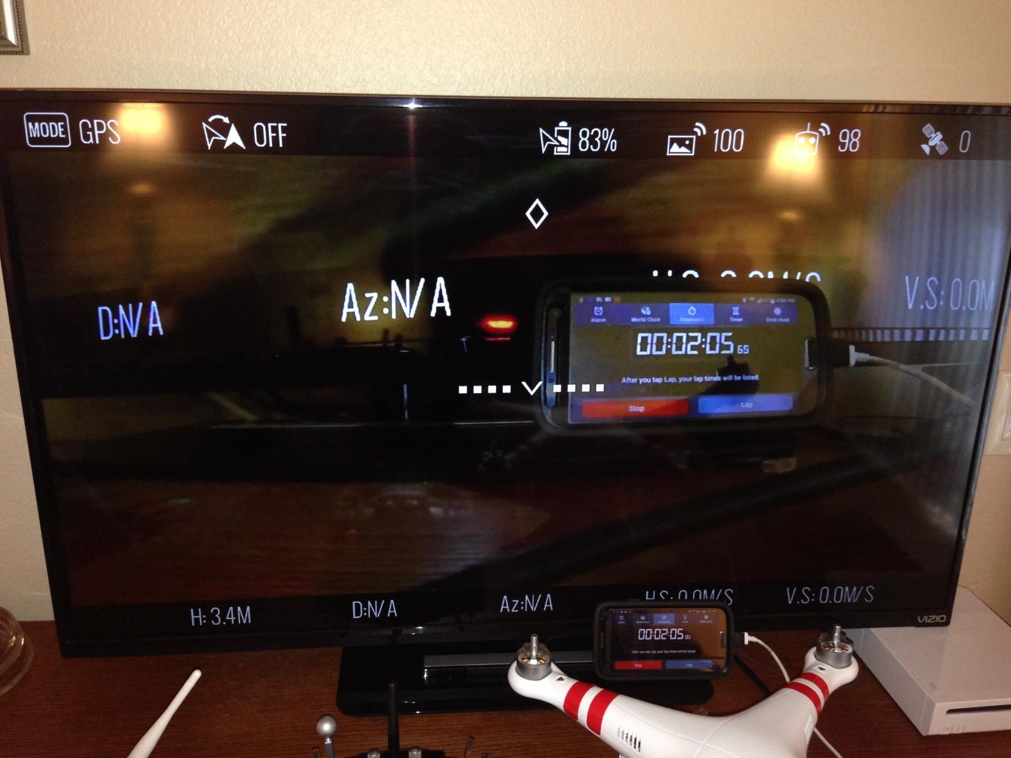

Finally got around to finishing up the tests of my upgraded Lightbridge on my P2. I tested latency on the real time mode and got 270ms delay. I need to do my S1000 next with the BMPCC. That is a processor hungry camera and I am interested to see what the latency is with it. I will be testing in both Real and Smooth modes.

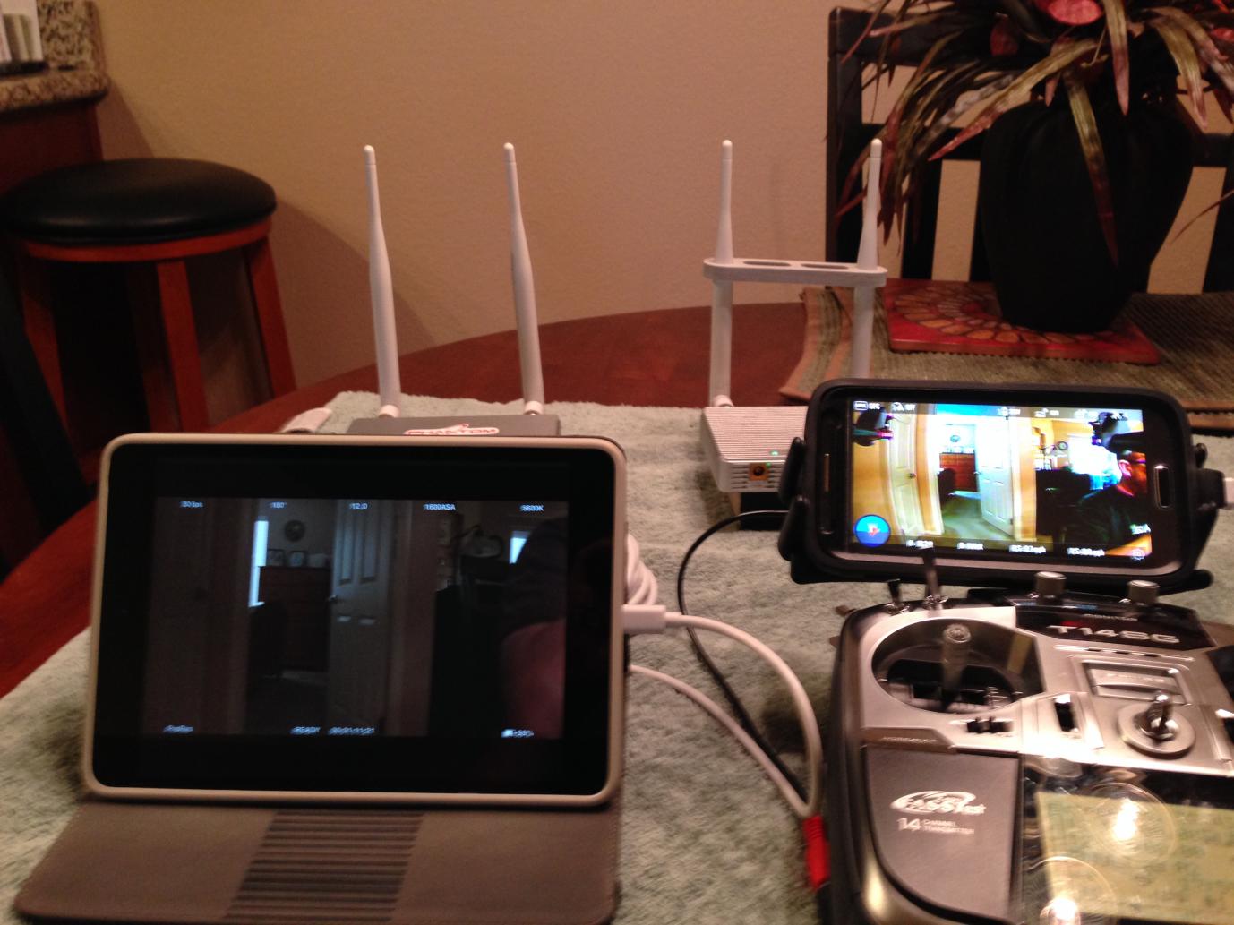

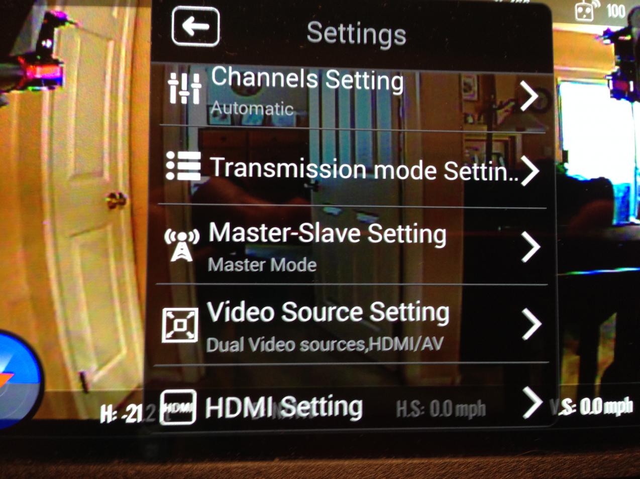

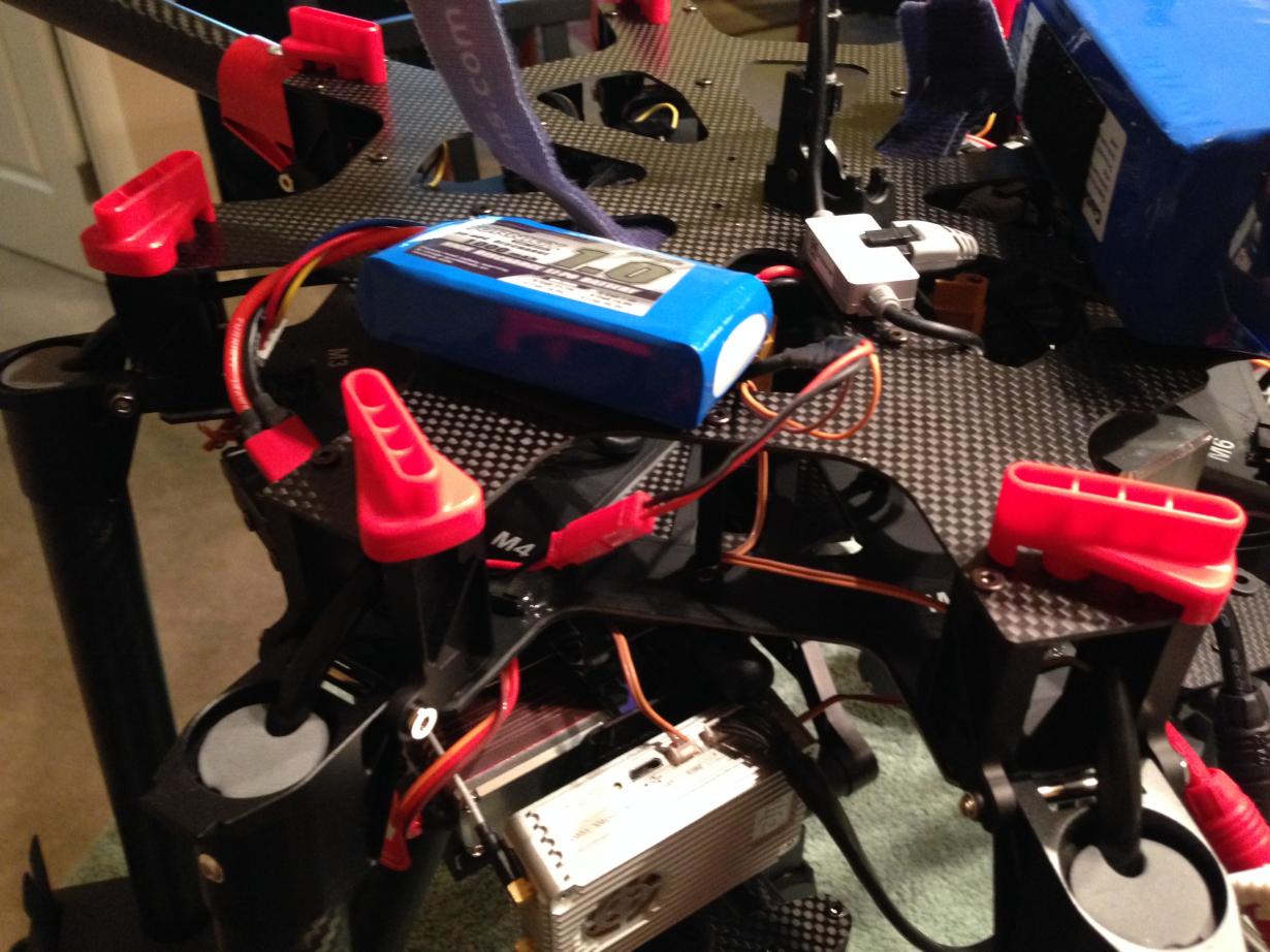

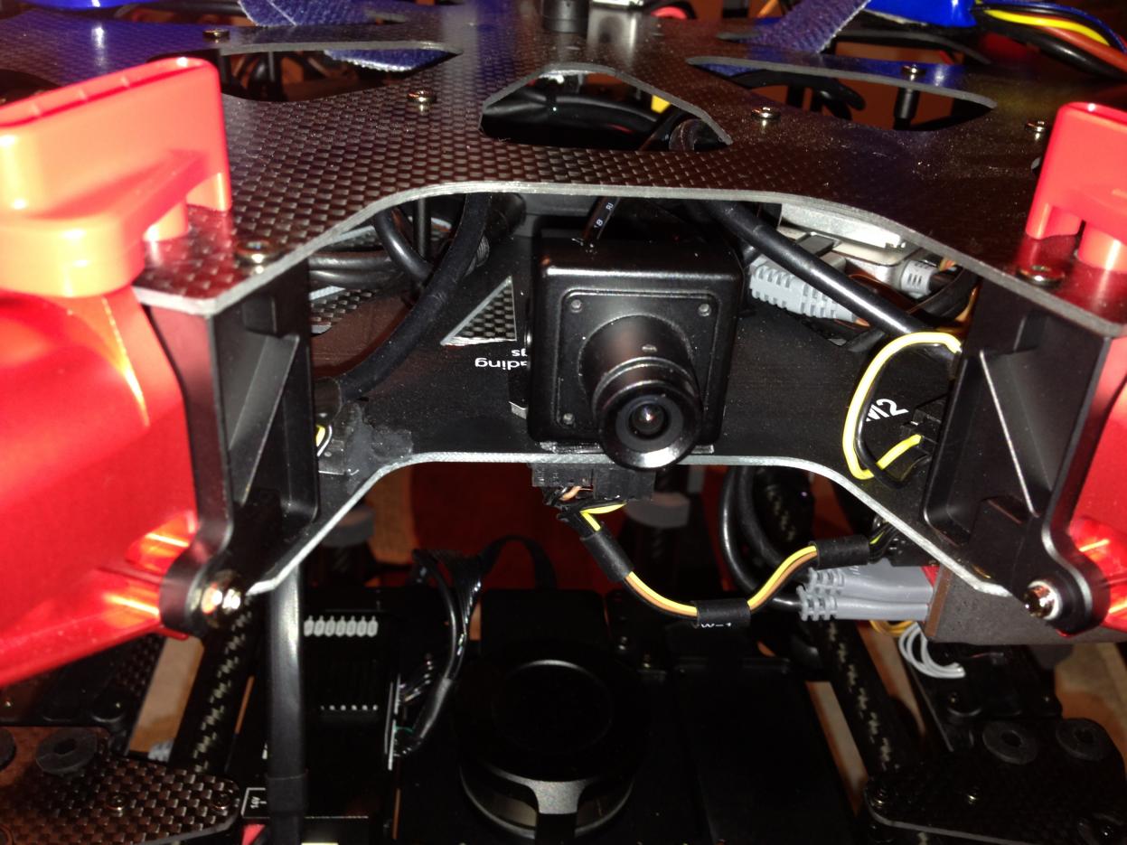

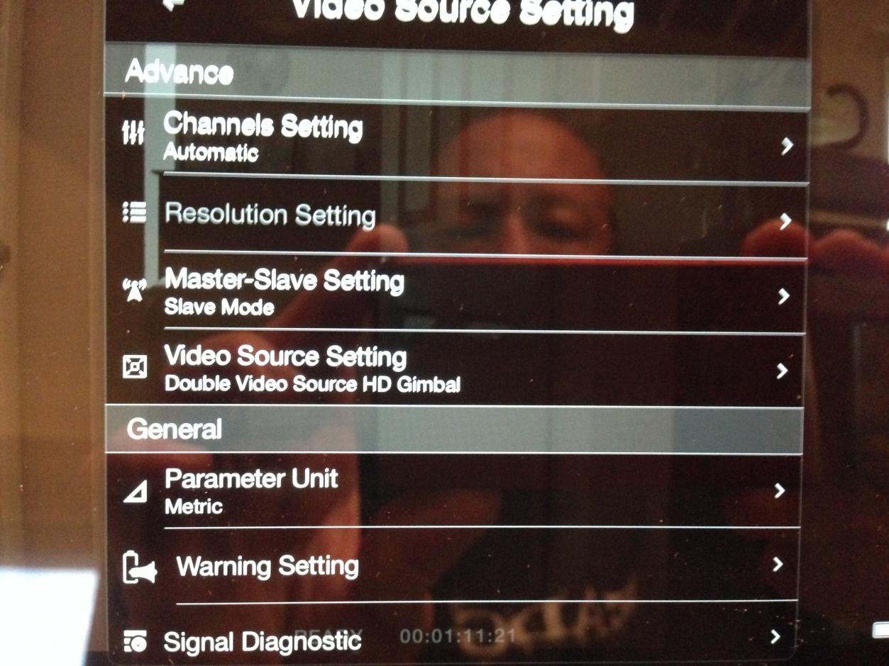

Dual Video Source Set Up
I just went through the dual video source set up on my S1000/A2/Zen for BMPCC HD Gimbal/Lightbridge. I had a small Sony FPV camera setting around so I decided to see how it worked. I have two ground stations so that part was a not an issue. What I wanted to accomplish was how would this work for a two operator system with a pilot on FPV and the camera operator on a separate GS with feed from the camera. Wiring the camera was easy. I used a 3S lipo for power and the spare AV cable that came with the Lightbridge.
Initially the Slave unit gave me fits. I set it up as a slave and then tried to connect to the camera. No go. I got an error message that stated to connect to the control unit. I ended up having to turn off the Master unit then bind the Slave unit, now the new Master unit to the Air unit. After that I reset everything, Master to Master, Slave to Slave. Here are the pictures of my set up. Also note that the Master can display the camera view as well. The feed is easily switchable for both the GS's.
View attachment 19238View attachment 19239View attachment 19240View attachment 19241View attachment 19242
