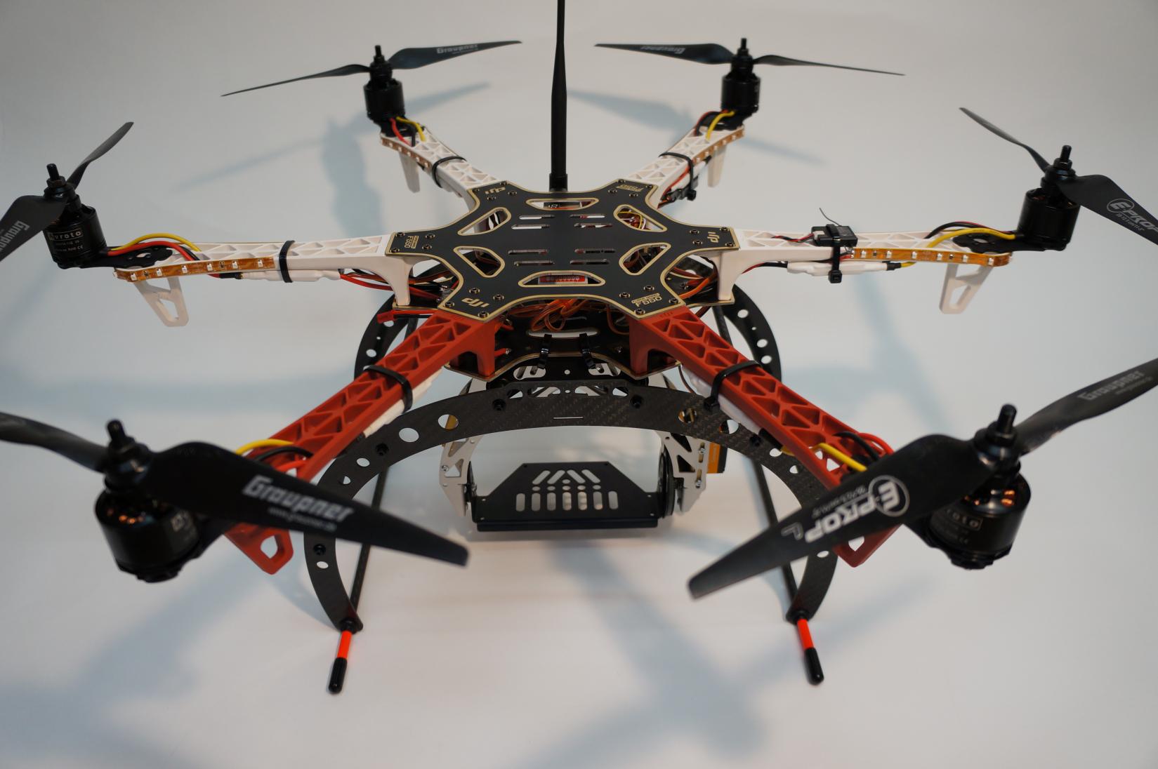

Looking at the Graupner 11x5 props in the below image, they are setup correctly in their clockwise/ counter-clockwise rotation. Here is my confusion. Looking at the front right blade (red arm), which is #2 arm with a clockwise rotation. The prop has the Letter "L" on it to indicate that it is Counter-clockwise (also stated on the box the prop came in). Why does Graupner label the rotations opposite of how they should turn?
