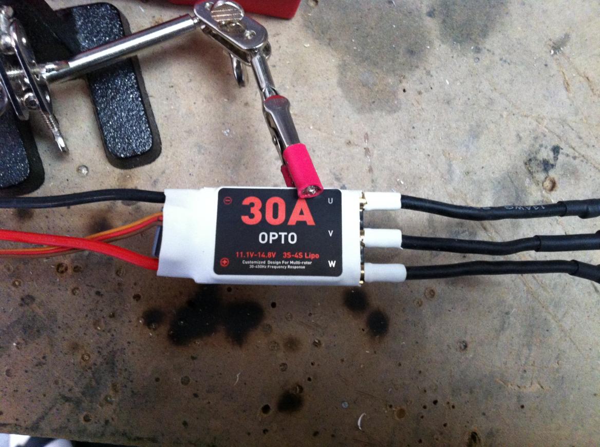

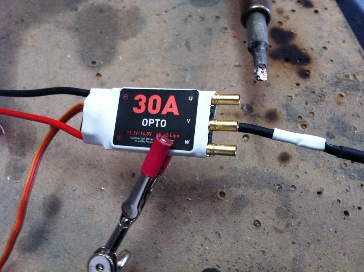

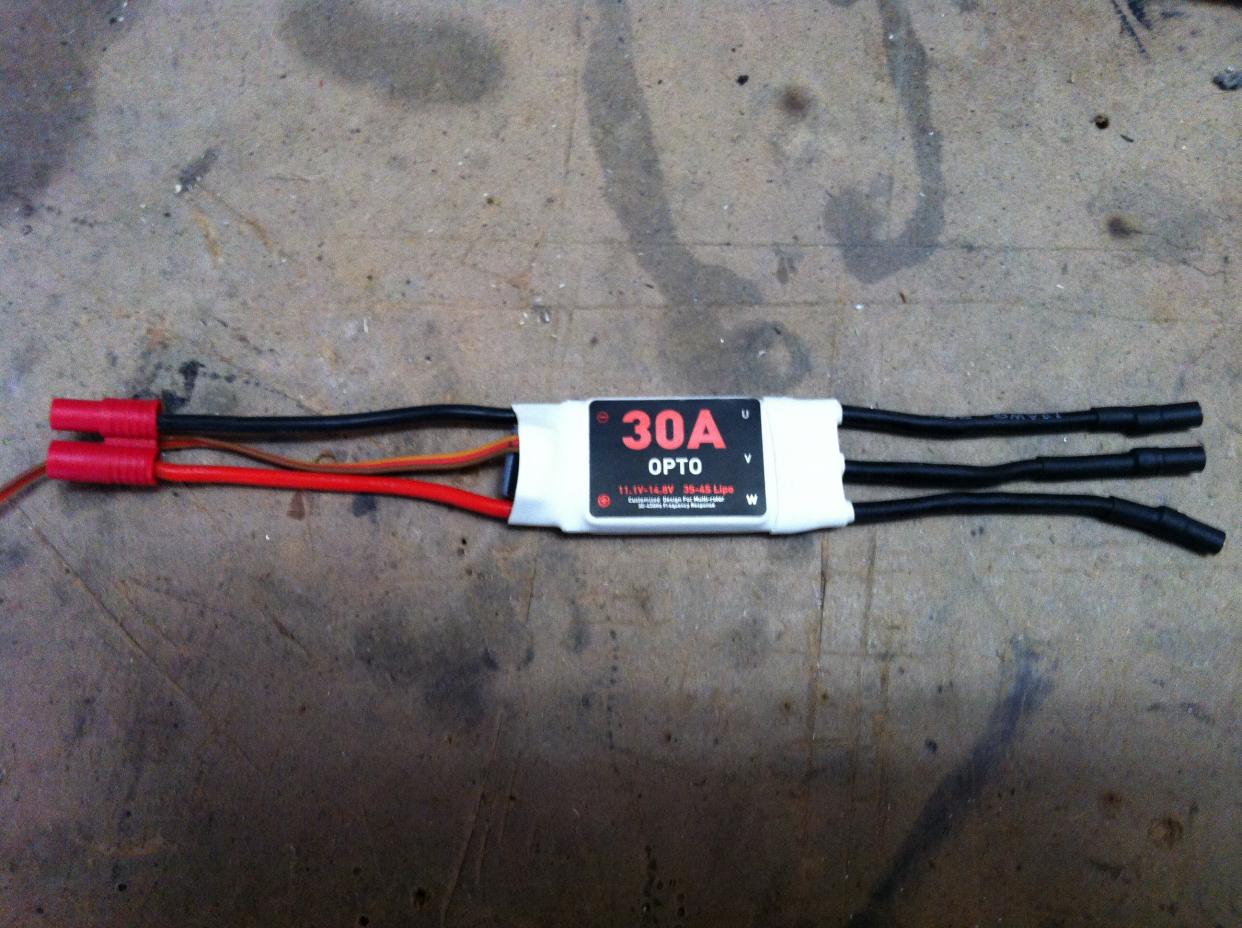

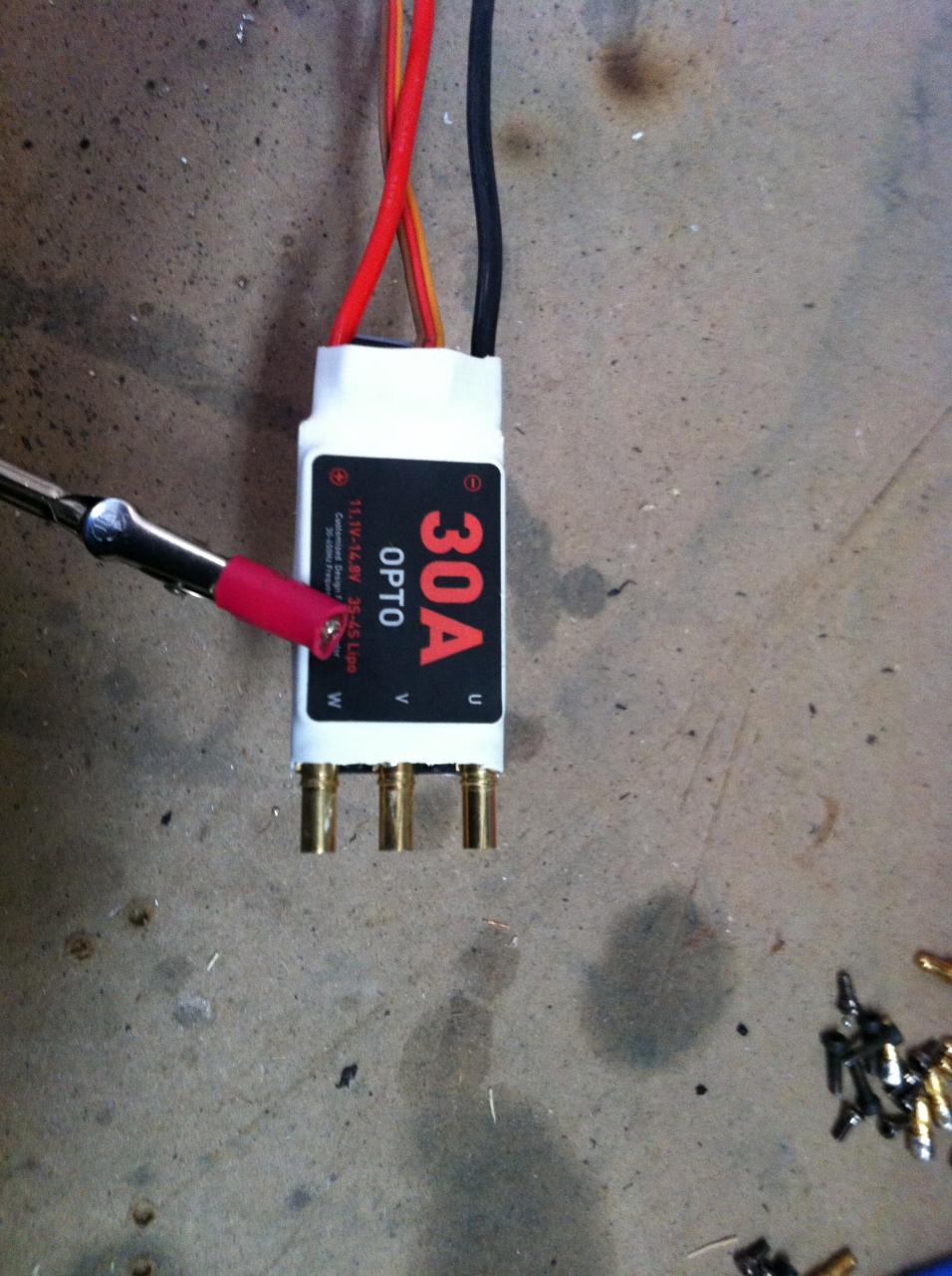

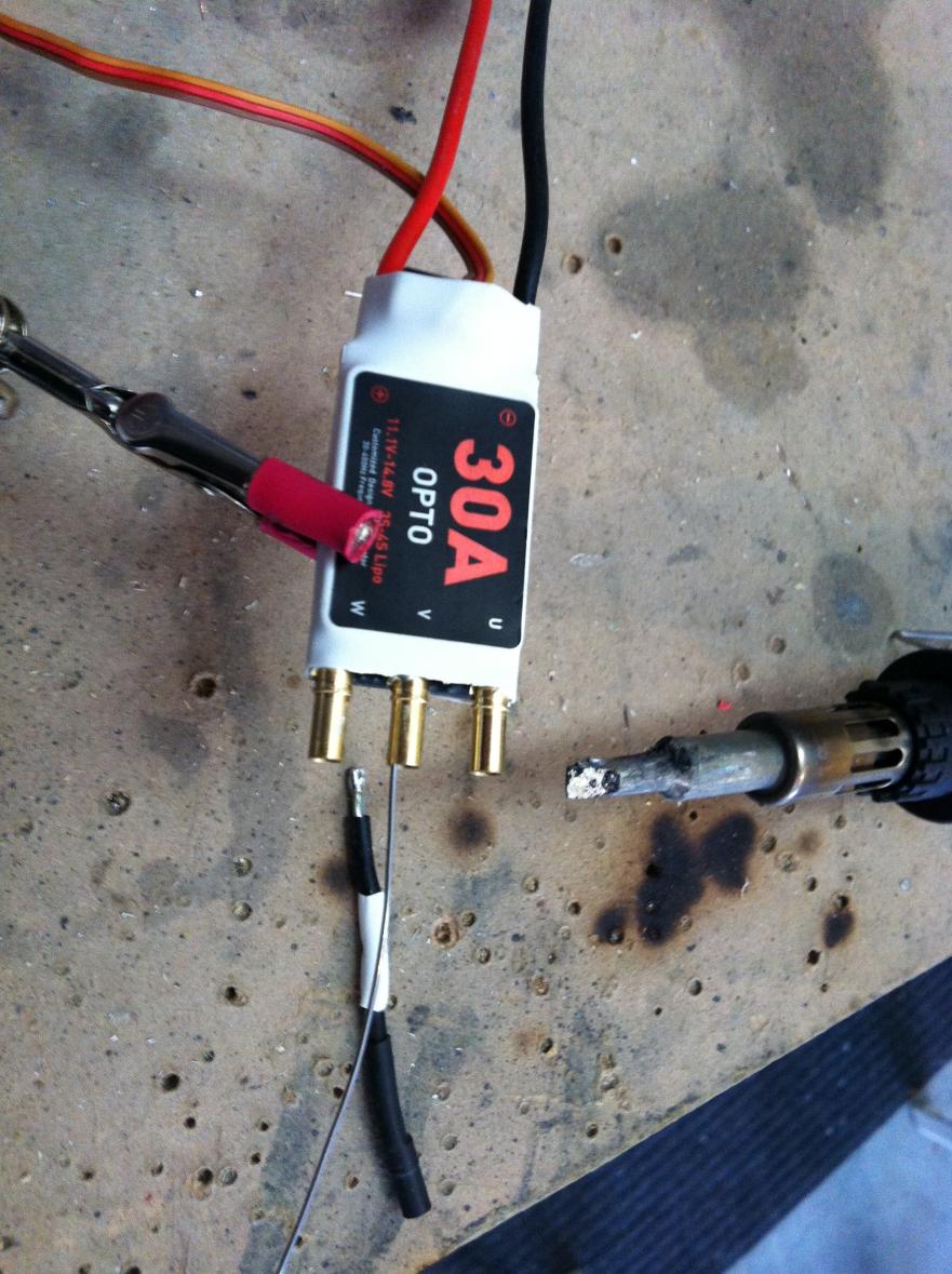

Here is what I did with my DJI ESCs with respect to the bullet connectors...... extended wiring from the ESC to separate bullets because the distance to the motors was too great.
Note their are connectors at both ends of the ESCs for fast connection and disconnection. Helps to speed up the motor balancing etc. and keeps the escs away from the prop wash for better lifting efficiency.
View attachment 11118View attachment 11117View attachment 11116View attachment 11115

Too many connections to fail for my liking, remove any connectors inline and solder/splice the power wires then heat shrink the connection. Why add more points of failure and more weight to the aircraft.?
VINHEX
Interesting about distance from motors as well.. I've not herd that before NOT to say that there isn't but interested if is.. Do you have any reference to the max length they can be.. I'm using STD Dji ESC's on 6 x 60cm leads to Tigers and don't have any issues (Famous last words now!)
Agreed..... fewer connectors is best..... but there is only one additional connector per standard DJI 30A ESC.....i.e., the red one which enables simpler and faster individual motor balancing on the frame.
When motor balancing is completed, these red connectors will be tie-wrapped together to ensure they do not vibrate loose etc.
The other 3 per ESC are not extras but simply non-DJI bullets connectors that have been extended.
As far as additional weight.... insignificant for this S800 size Hex with much larger motors.
