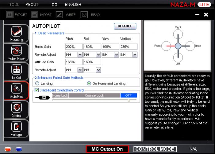

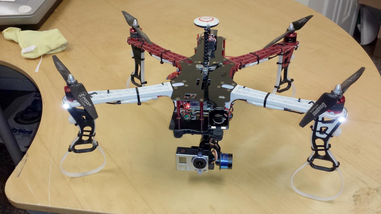

I finally found a sweet spot on my 550. My gains are at 150 150 175 150 80 80
She's running Aeroxcraft landing gear and gopro gimbal with 2 x 3300mah 4S lipo's, Graupner 10x5 Eprops
I noticed that with my ATTI gains much lower it provides much smoother video, like much smoother...

Any one running a heavy lift setup? Areial media pros kit (avroto 2814-11s), 11x5 Graupner, Aeroxcraft landing gear, VTR go pro gimbal, hoverfly gimbal controller, fpv transmitter, 730 mah 3s and 8000mah 4s .. 5.4lbs .. Current gains 130 130 175 100 100 100.. So far so good. Anyone running anything close to this?
