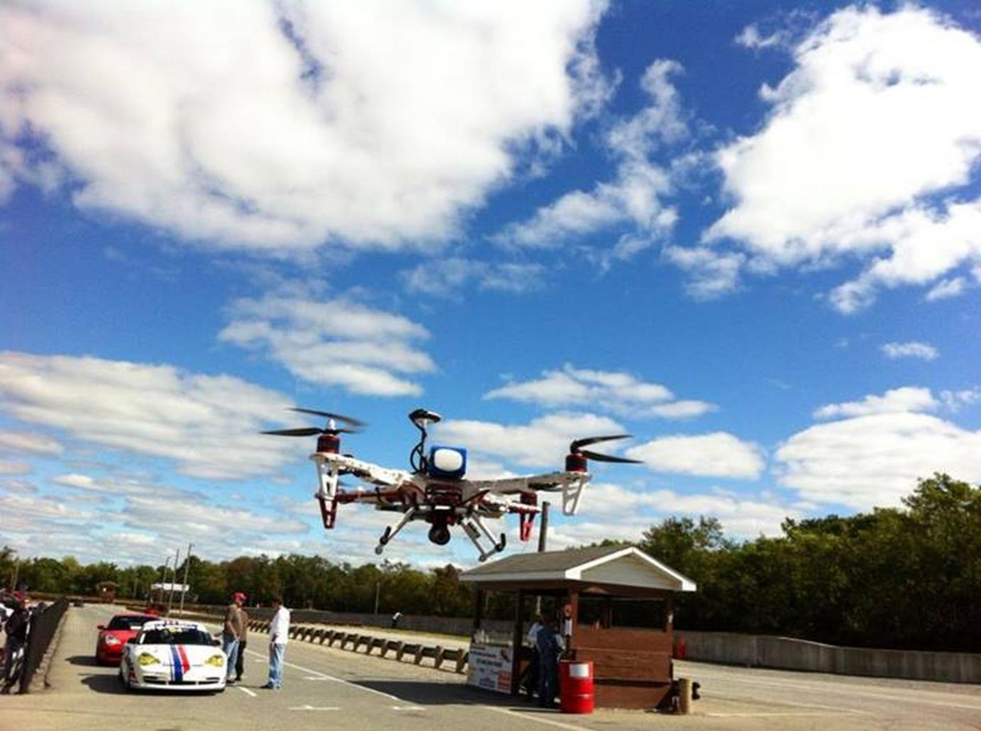

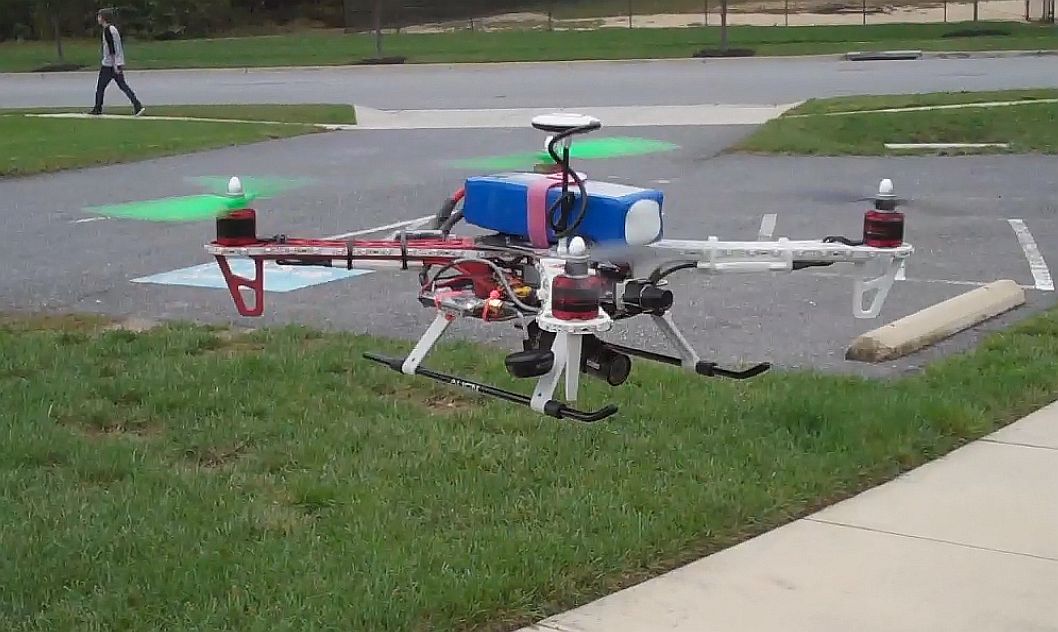

I would be choked if that happened to me Flygirl I'd have to go find a good shrink at that point. Is that your beast in the avitar? That is one very cool machine do you have a better picture?

I was shocked Ben.... My fault though. I ran the battery down too far on a previous flight and damaged the cell... DOH! And yep, that's my 450 in the avatar. Here's the original pic and one other. Nothin' special but I'm sure having fun!
