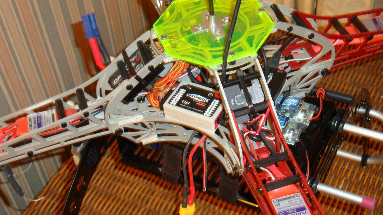

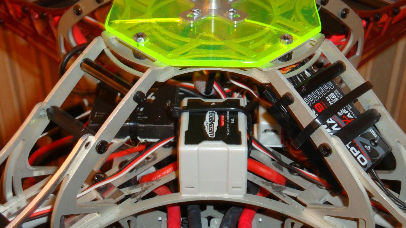

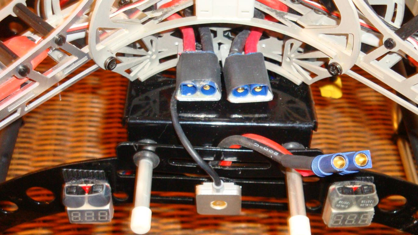

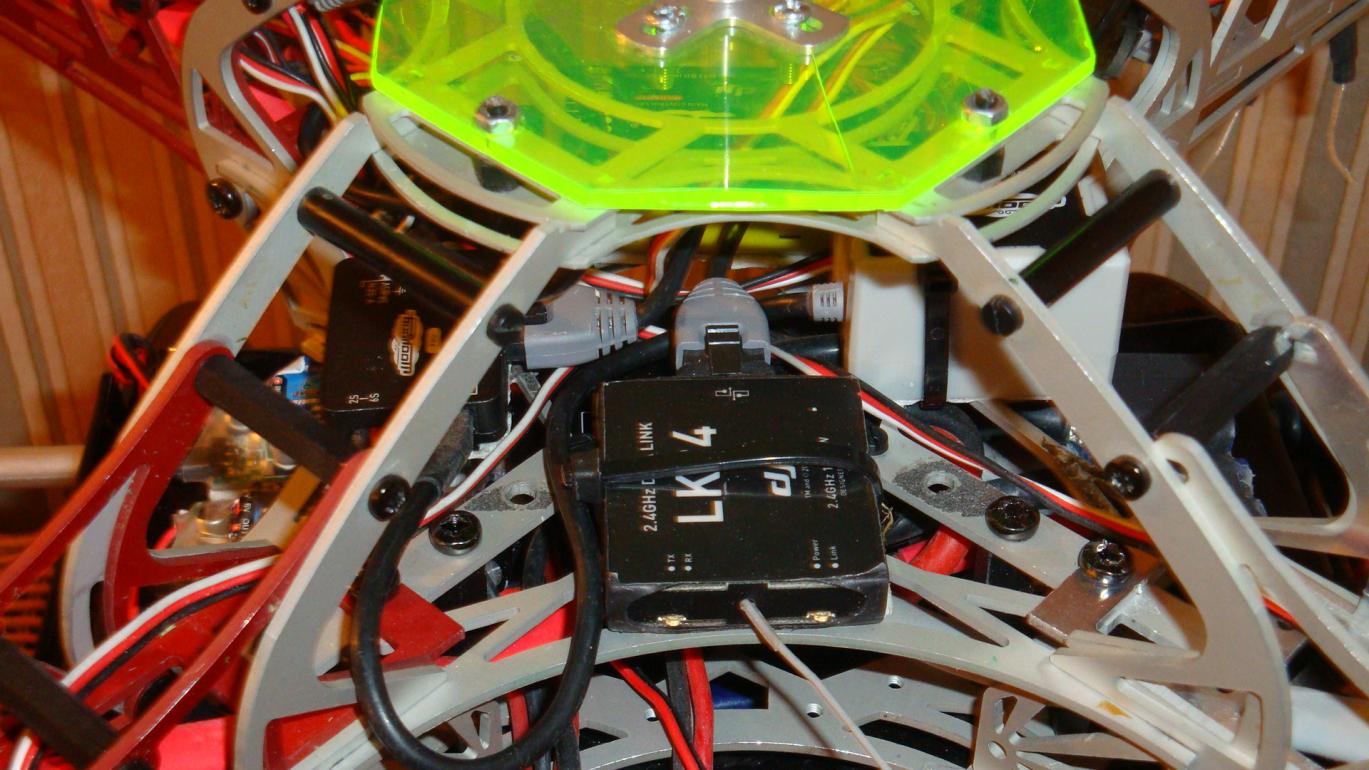

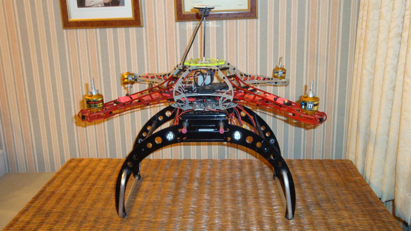

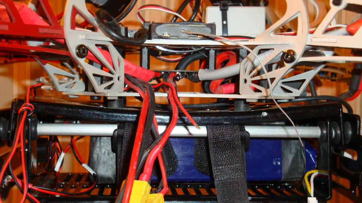

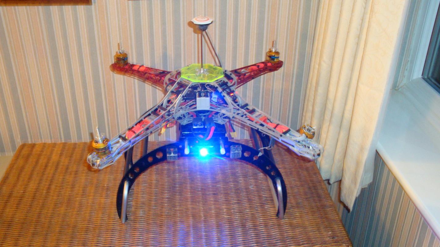

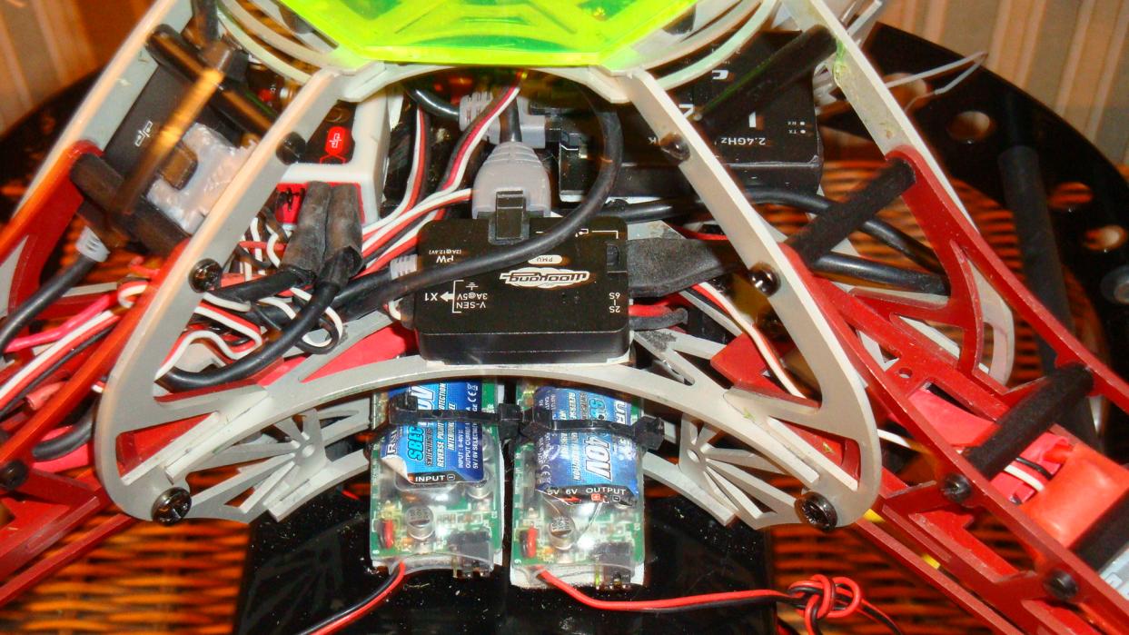

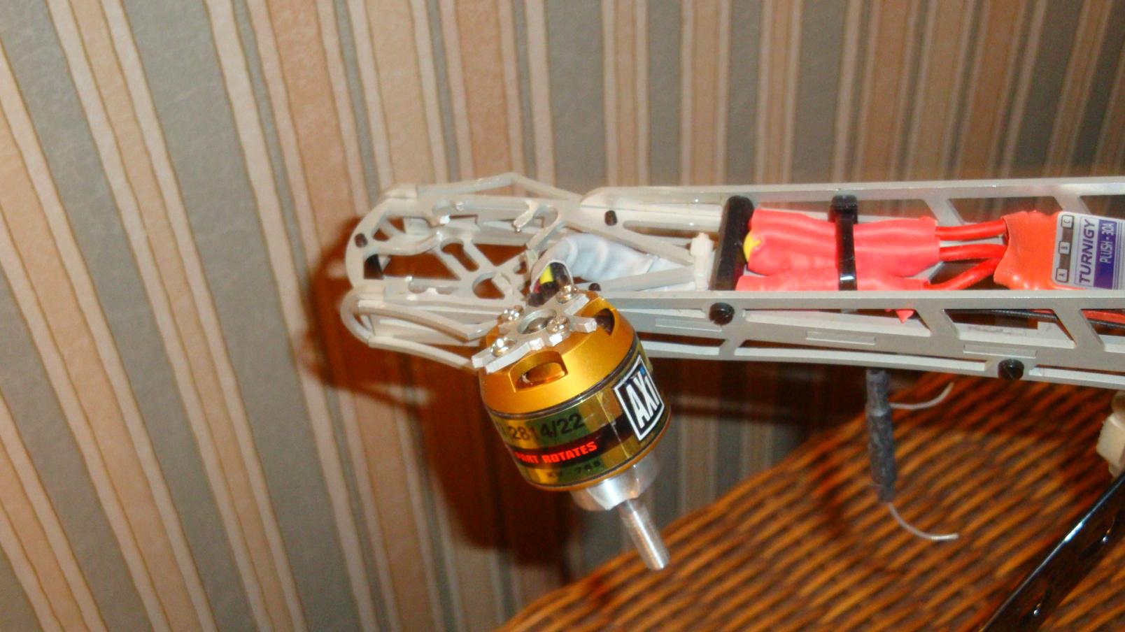

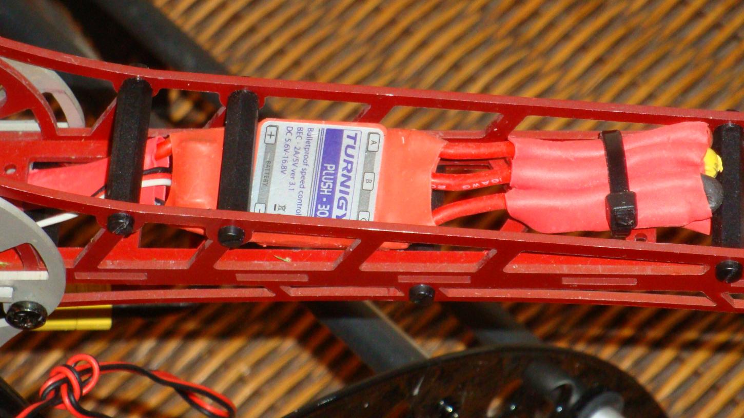

I've just taken a number of photos and attached. you can see that I have already straightened up the undercarriage with no problems. There is also a photo that shows the motor that was ripped from its mounting hanging from the boom. The other photos are about Wookong-M component layout and limited views of power connections. The untidy nature of some of the signal wires is from me lokking to see if there is a problem in these areas.View attachment 3617View attachment 3618View attachment 3619View attachment 3620View attachment 3621View attachment 3622View attachment 3623View attachment 3624View attachment 3625View attachment 3626

David don't misunderstand me on this. But i wanted to see your build so i know what i am at. You build is clean and its obvious that you know what you are doing ! I couldn't see anything that would worry me or could be the cause. This is not the issue but once you have the setup going, reposition your receiver never good to be placed in the arms and the antennas in contact to any material, landinggear antennas pointing downwards or upward is a good position.
In Foto nine you have on loose cable but I think you know what you are doing.

A. All solder joints from the bullet connectors from the ESCs to the motors are a 100%. Take of the shrink tubing and double check them. Sometimes the joints come loose and the shrink tube hold the wire in place and also a connection is given under a certain flight movement than again not and the bird falls.
B. Check under the shrink tubing that the Cables soldered to the ESCs especially the PPM servos signal cables are not loose or hurt anywhere.

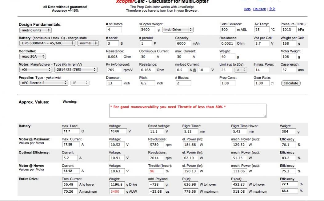

I had/have the exact combination you were talking about, and flying 13"XOARs. My AUW (CX4) was around 2kg. I could get her to fly on EPP 1045 as well. Only stopped using the ESCs because one was behaving erratically and wouldnt spin up. The DJI ESCs are supposed to be programming free when used with WKM so unless your XCALC is bad, it should work OK. I would suggest trying smaller diameter props and reporting back. Have you checked your power harness for resistance?
Mathew, in the recent past and before I put the DJI ESCs in place (using Turnigy ESCs) I did try out 12 x 4.5 APC props but the performance of the craft was not very positive and it was difficult to fly. My aim is to eventually use 13" XoOAR props but not until these recent problem(s) are fixed. I have checked out the harness on a couple of occasions for sound connections and all seemed to be OK...I havn't metererd its overall resistive qualities though...perhaps that is something I should consider. I have replaced all the ESC/Motor connections with 4mm caged gold bullet connectors...they have a considerable amount more of contact area and looks to be a good move. The soldered connections elsewhere and to and fro the distribution board are also sound. I'm looking forward to my new boom arriving so that I can try and fly it all successfully again.
