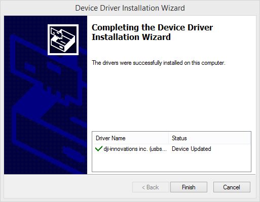

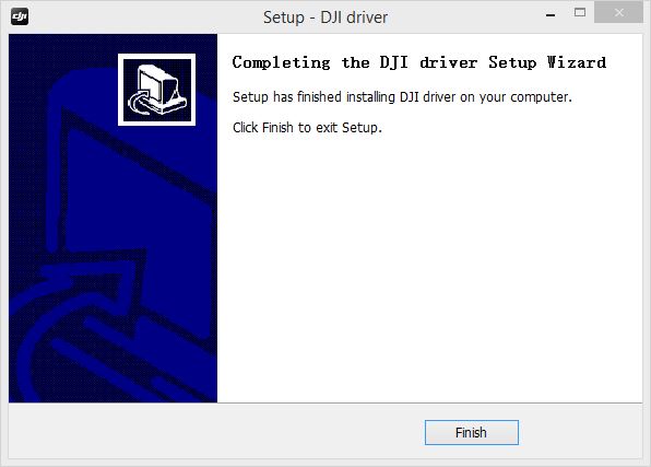

Here is a fresh installation experience on win 8.1:
- I installed the latest A2 Assistant Software v1.2
- I proceeded to run the DJI WIN8 Driver Installer as administrator by right clicking on the file and selecting "Run as administrator" <see screenshot below>
- Followed the standard prompts until it completes the installation. I kept all the screenshots of that but it isn't useful, so I did not upload all of the pics. Here are the last two dialogues you should encounter <see screenshots below>
View attachment 15660View attachment 15661
- Once I clicked on finished, the screen clears. I unplugged the USB and replugged it back in after 10 seconds.
- Opened up the A2 assistant software and it recognized it without additional steps.
If you can't get it to work, run this command on your computer
devmgmt.msc
That will bring up your device manager and look for anything that has an exclamation point over it (!) indicating a non functioning device. I don't know what it would say but hopefully it signifies a DJI system. If you find it, double click the device and it will open up a prompt. Select the "Driver" tab. Select update or install driver. A window will pop up asking where the driver files are. Type c:\ and click ok. that will look for the driver in your entire C drive (assuming you only have one hard drive and one partition on your computer). Once it finds it, it will be very apparent and you can click next to proceed or finish to finalize the installation.
Hopefully this gets you going!
