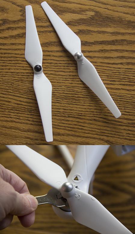

sledge57
It has the new style props doesn't it, no nuts, just spin them on? If so I don't know how you could put those on a balancer.
Are these the props you have?

not on any of the balancers i've seen, there needs to be a hole for the shaft of the balancer to pass through.
