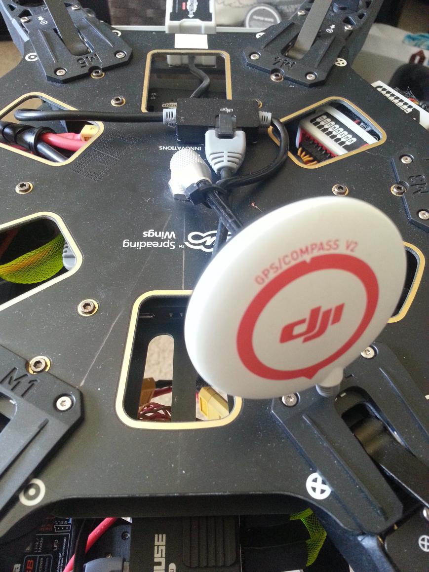

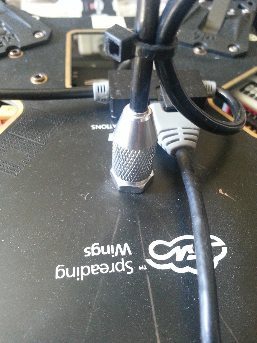

R6Media
Linter,
I had your exact same problem. Stick glued to the aluminum disk, gps sticky taped to top. Knife to tape and re-adjust GPS puck works but its so annoying and I wanted the flexibilty to adjust declination on the fly. So I went with this and it works perfectly. The nut is snug enough underneath to hold position but when I tilt the arm down there's plenty of leverage to turn it to make fine adjustments without loosening the whole thing to make it sloppy.
Also I've found that declination is far from perfect. On the east coast, my declination is about -11 where I'm at but when i adjust for -11 my bird still tracks off line. I eventually got random with mine and rotated it to about -20 degrees with much better success.
You'll have to dial yours in best you can. official declination seems to be nothing more than a good starting point. Probably a limitation of the equipment.

google: "gps folding antenna mount" and you'll see plenty of options.
I haven't had any issues with wobble or loosening. I removed the center post and locked it in with a washer and one of those locknuts with the plastic insert. pretty solid for my needs.
