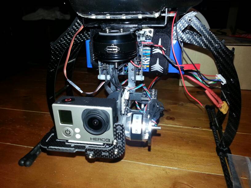

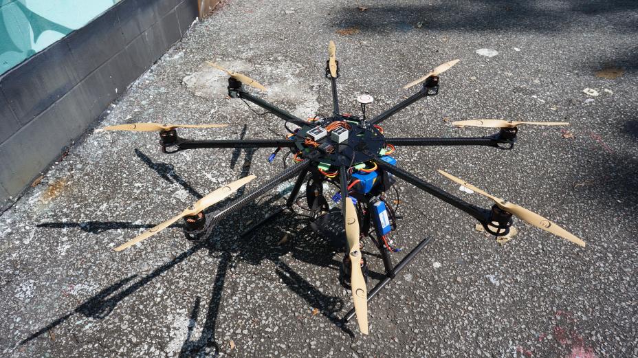

Ok, jumped the gun a little on AUW.
It's RTF at a chubby 3540g.
My pmm from zero was purchased direct. I'm not using ZeroUAV on this CX600 though.

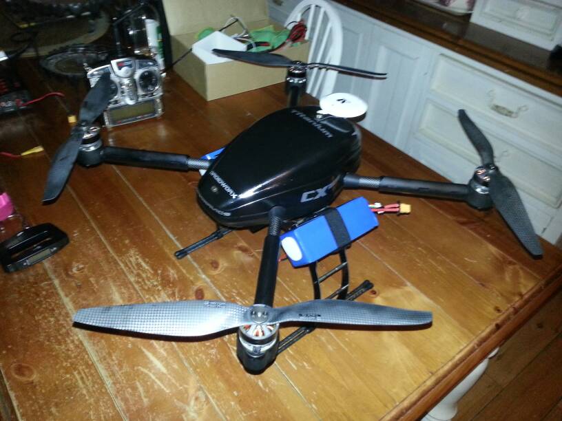

nicwilke
Ok, cold here in Albury NSW, but I went out front under the street light, and flew for 20mins. This SuperX is seriously the best flight controller I've ever flown. Yes, best. It is so stable, and flys fluidly. I'm used to Naza and ZeroUAV YS X6, and this thing is incredibly good. I must say that the flight times are great on my setup. Didn't break a sweat on the batteries or motors.

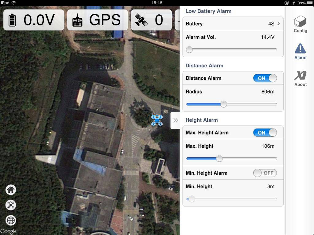

nicwilke

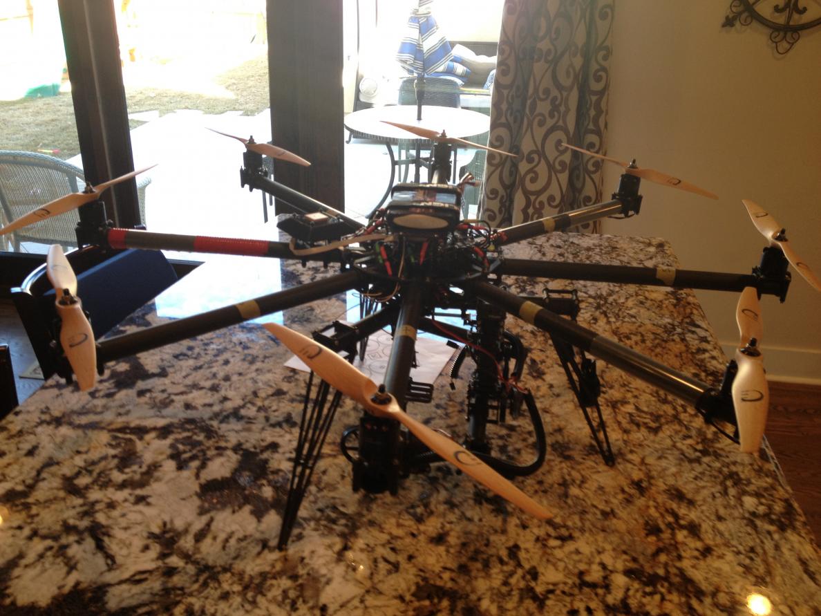

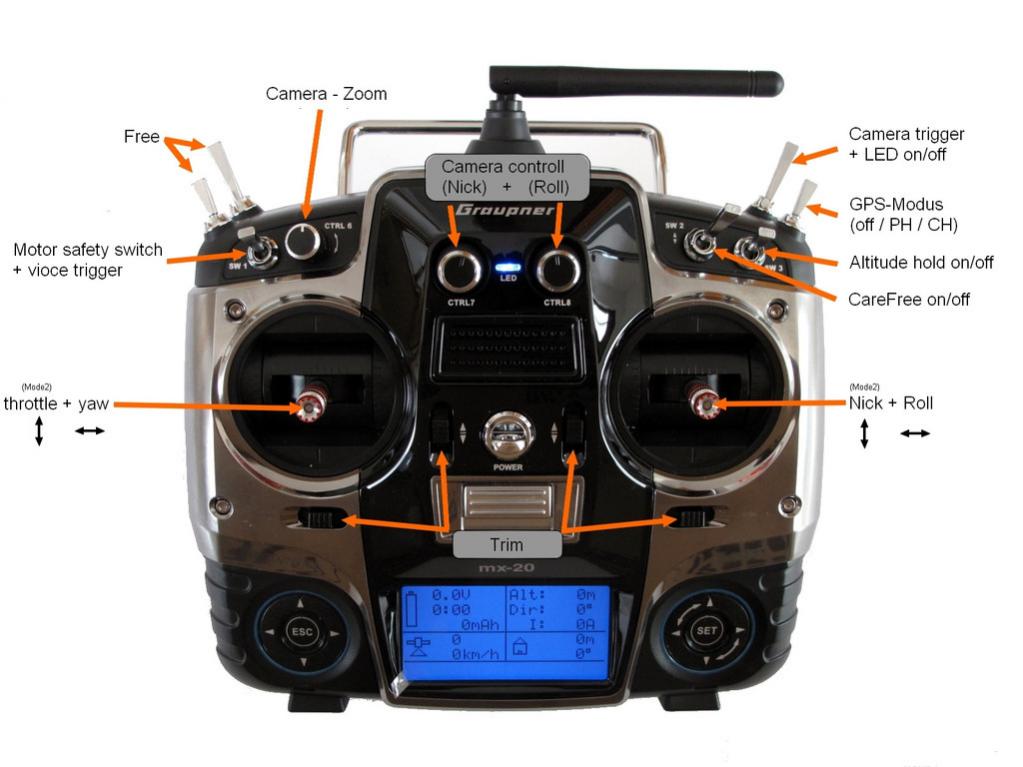

ChrisViperM
OSD I got already....Data Link sounds great, judging from your pics it looks super simple to operate.....I guess slowly DJI will have to reconsider their policies :tennis:
